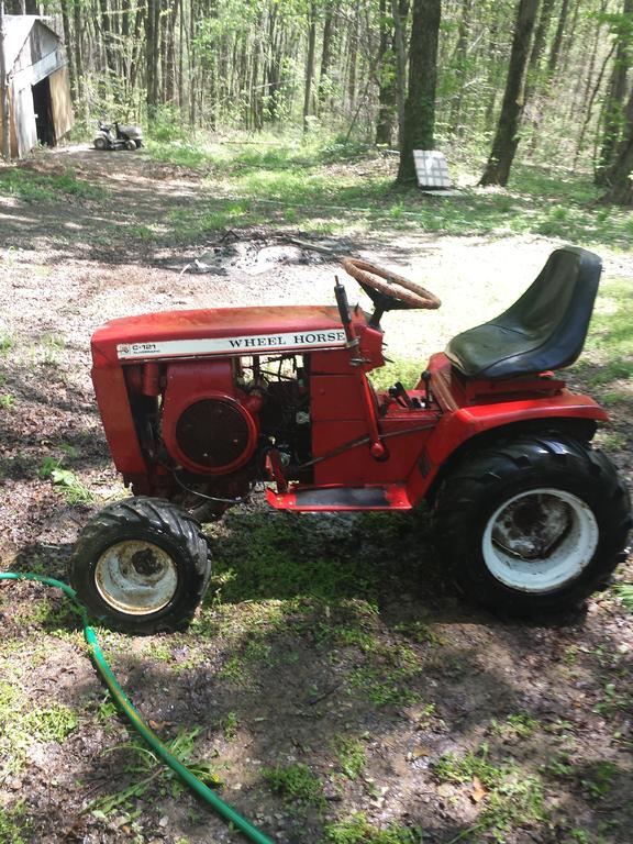

Cetan08 311 #1 Posted July 30, 2018 I hope this hasn't been covered before. I have gotten so many different answers that I hope someone has a clear and decisive answer. I am talking about the letter/numbers like B-80 or C-120 and so on. I have a C121 that has the K-301 and hydro. I know that on powerking I have a 1612 that means it has 16 inch rears with a 12 horse Kohler. Can someone clear up the system on the Wheelhorse. Thanks Share this post Link to post Share on other sites

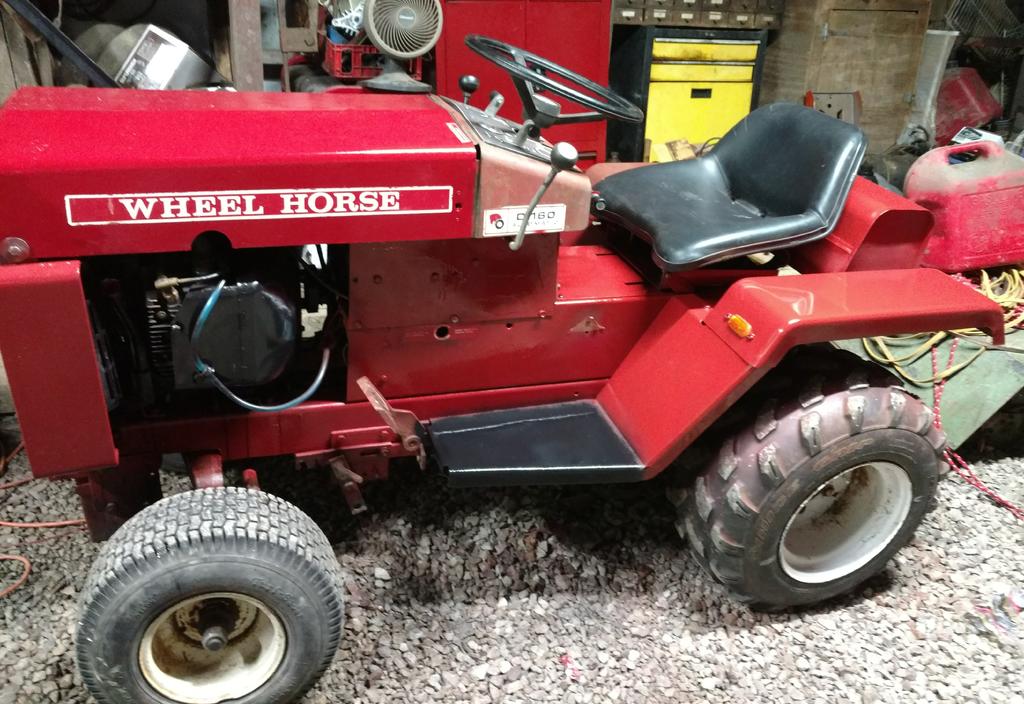

Cetan08 311 #6 Posted July 31, 2018 In 1988 a dear friend of mine gave me my first wheelhorse. Don't recall the model but it had an 8 horse motor on it and I gave it to my brother when I went back to live in Oklahoma. In 2001 I purchased my C-121 hydro from the original owner and have used it for everything under the sun. My Father-in-law and I would drive back roads looking for old It's and ran across an old wheelhorse dealer outside of NewCommerstown, Ohio. Picked up a few Brenley implements from him but he would not sell any GT's. This is where I learned about the brothers and the connection between the Wheelhorse and the Speedex. I fell in love with the GT's and the stories behind them. I have met some wonderful people while being around these machines. I had been having some negative feelings as a result of my military experience and getting involved in restoring these things truly saved me. I have used a Craftsman for mowing in the past few years but only to save my Wheelhorse. As some of you may know, I recently picked up a D-160 and just this past weekend I met Diesel Doctor and purchased a 418-8 from him. I also drove through freezing rain two winter's ago out in the middle of no where to purchase a complete and running Powerking 1612. Although my heart belongs to Wheelhorse, I am fond of the Powerking and the craftsmanship that went into it. I am very lucky in that my wife was a Lt. In the Marine's and taught small weapons and self defense to women Marine's. She also has a degree in vocational agriculture and she has found several GT's for me and encouraged me to buy them. I have a 30x40 garage and no more room but would never let one go. 4 1 Share this post Link to post Share on other sites
