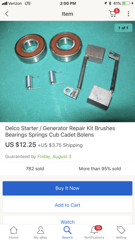

sdhdcouple 133 #6 Posted July 30, 2018 thanks, guys. I give it try to put new bearings and brushes in it, what the heck i can't break it any further. and a new one is $260 so what the heck. neck i have to put axle seals in it. 1 Share this post Link to post Share on other sites
sdhdcouple 133 #7 Posted August 3, 2018 Well every one, it lives again. I would like to thanks wheelhoresman. I bought the exact item you took your time to copy and paste for me and she lives again. I got the item yesterday i believe, took the generator of and took it apart cleaned it all up, put the new parts in and she started right off and mowed her 2 1/2 acres. 51 years and counted and thanks oldman for offering up one if i couldn't fix mine. I know i am not on here a lot because of my job, but all you guys are great every time i have a question you guys are here And it was the bearing close to the pully it gave out. seized to the shaft. I had to cut it of real careful like with the drimmel. a little emery cloth on the shaft and the new bearings went right on. Judging by the looks of it those were the factory parts. 1 1 1 Share this post Link to post Share on other sites
