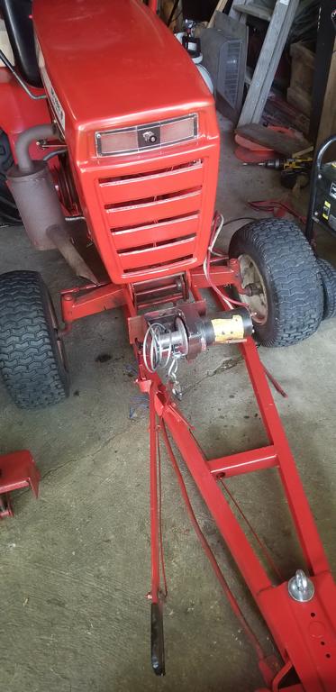

Charles123 12 #1 Posted July 27, 2018 Been trying to get a dozer blade for my SK486 Wheelhorse attracto Tractor Actually found the one that Came off the tractor before I bought it has a homemade lift Don't have all the particulars worked out yet will let you know Good find 5 Share this post Link to post Share on other sites

Charles123 12 #5 Posted July 31, 2018 (edited) I'll tell you what's got me puzzled about it is there's no down pressure on it and nothing up front to connected to the frame are they all Ithat way I I'm so Green I haven't fell from the tree yet it know what I'm saying😃😎 Edited July 31, 2018 by Charles123 Share this post Link to post Share on other sites
gwest_ca-(File Mod) 12,511 #6 Posted July 31, 2018 You can see the vertical lift mounting point on the front of the 2nd frame crossmember in the first picture. It is behind the winch in the 2nd photo. When you go to mount the blade to the tractor swing the long angle lever to the rear of the A-frame. After you roll the tractor over the frame lift the angle lever up before it gets to the rear tire. Bring it up between the front and rear wheels. Garry 1 Share this post Link to post Share on other sites
Charles123 12 #7 Posted August 1, 2018 Will try that thank you Share this post Link to post Share on other sites
