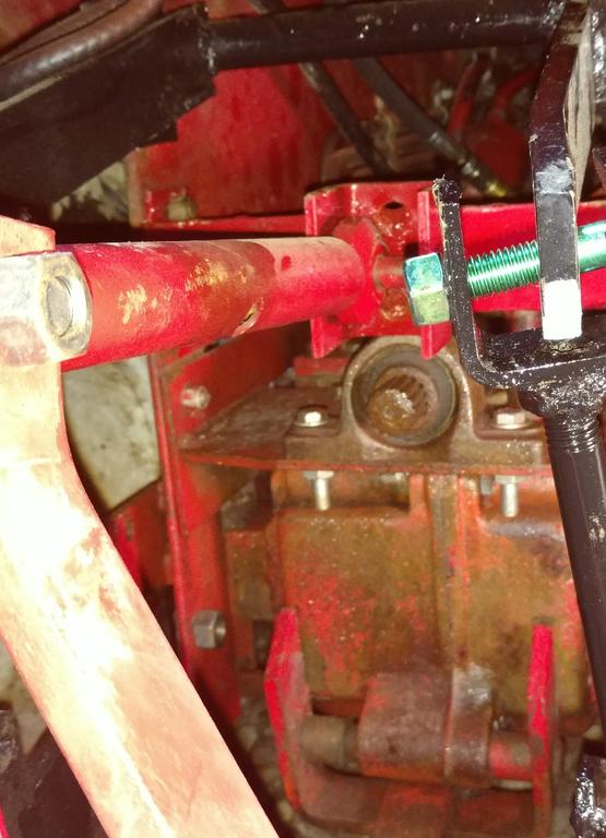

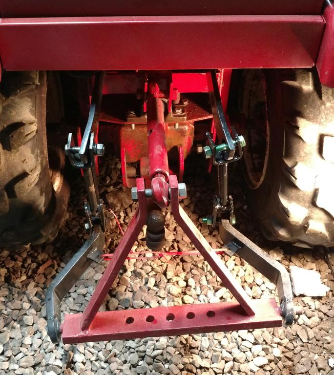

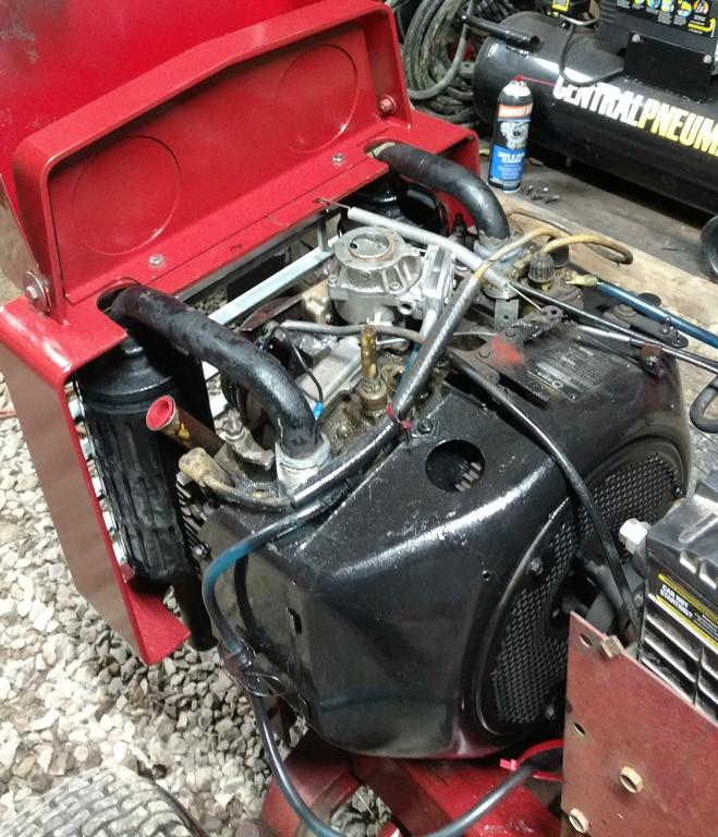

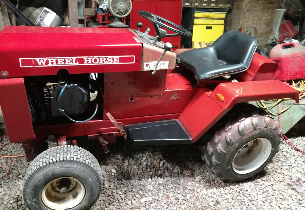

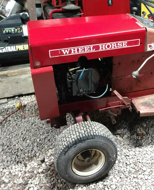

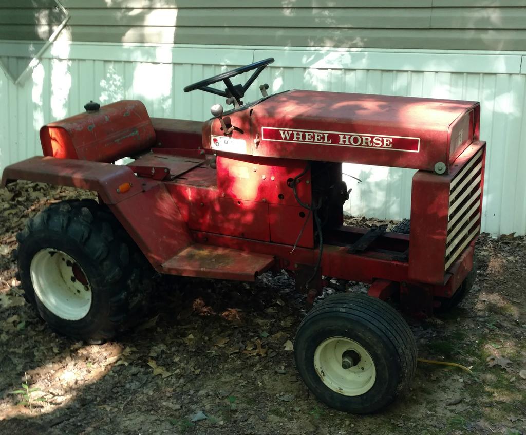

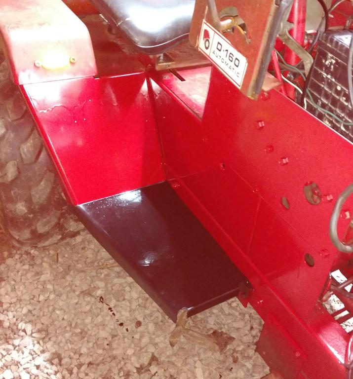

Cetan08 311 #1 Posted July 26, 2018 A couple of weeks ago I picked up a D-160 that had a blown K-341 with it. The engine had a hole the size of a softball in the side so it is shot. The tractor is solid but had surface rust. I like the patina but wanted this one to look nice. The rear lift components had been removed so I have aquired the cylinder and other parts to hook it all back up. The tractor also came with a BF series 16 horse Onan that didn't run. After fixing the points, rebuilding the carb. and adjusting the valves it runs better every time I start it. I have purchased a replacement K-341 for it but may hold off installing it for a while. I am cleaning and rattle can painting the tractor as I go. Not looking for a show tractor but just a clean one. The first picture is when I first got it home and the others are of the progress made. Thanks 7 6 Share this post Link to post Share on other sites

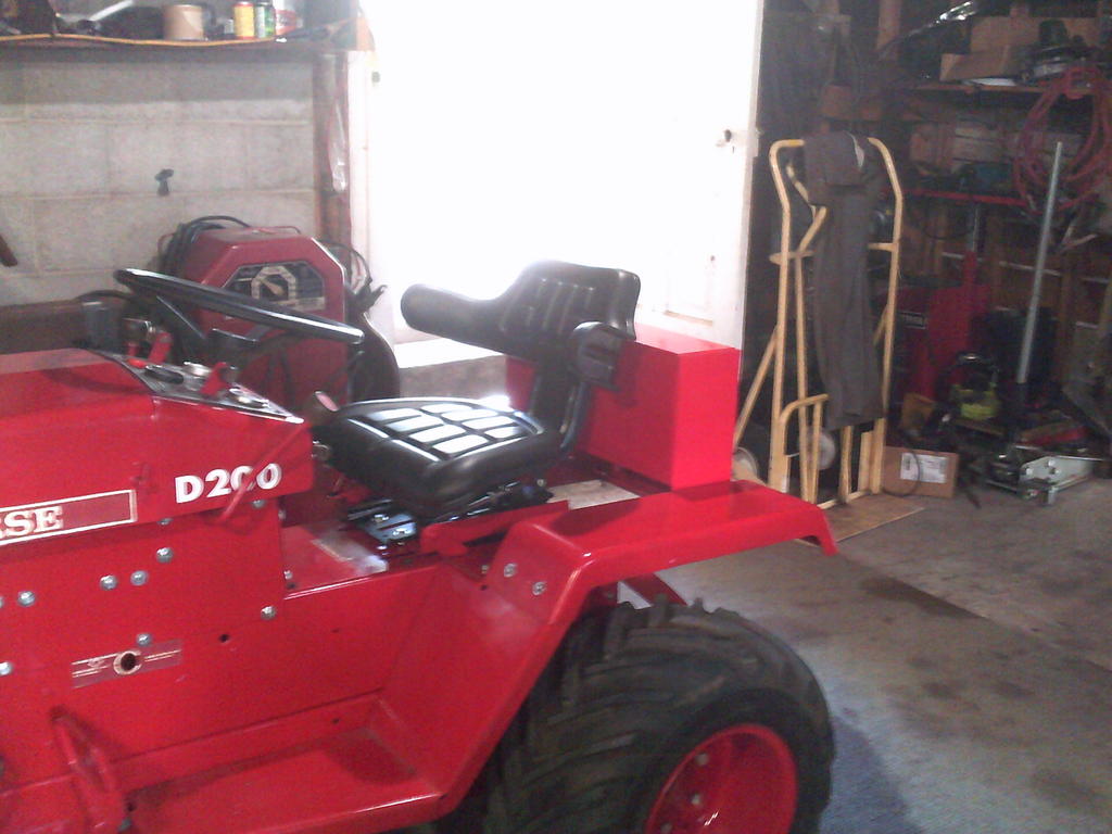

elliot ness 1,916 #4 Posted July 27, 2018 Welcome, you picked a great tractor to redo, I love the big old D's I just put a new seat on my latest D 200 project. 1 1 Share this post Link to post Share on other sites

Cetan08 311 #10 Posted August 27, 2018 Took it out yesterday to mow some grass for the first time. One thing is for sure, you need lots of room to turn it. It has one of the quietest decks I have ever heard. I am cleaning up the belt cover for the deck before I paint and reinstall it. I also built the parts I needed and installed the three points. The PTO shaft works good so all I have left is putting together a shaft to go from the rear of the tractor to the tiller. Hope to get on it later this week. Have to put glow plugs and wires harness on my F-250 tomorrow so I can clear the code and get the engine light off. Thanks for looking at my post everyone. 4 Share this post Link to post Share on other sites
Skipper 1,790 #11 Posted August 27, 2018 Looks good When you hook up your tiller, take care to adjust the top link correct, so that the pto shaft do not bottom out when you lower the tiller. That will do nasty stuff to your tiller. PTO shaft is shortest when level, and that is when the tiller is on its way into the ground. Mine has only about 1/4" travel left when tiller is adjusted a bit "backtip" so it is really easy to mess it up. I have a toplink that is set tight only for that tiller to avoid Oopsies. Just my 2 Share this post Link to post Share on other sites

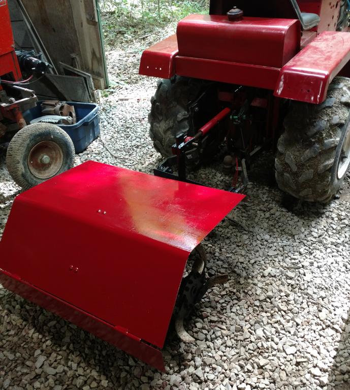

Cetan08 311 #13 Posted September 6, 2018 This is not a WH tiller. I was told it is most likely a Bolens. I picked it up at a great price and it is in very good condition. All I need now is to get the shaft made. 1 Share this post Link to post Share on other sites
