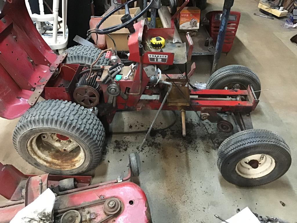

Pullstart 69,620 #27 Posted September 12, 2018 Looking at 12 and 10 hp differences, I was hoping to swap the C-101 K241 onto the Charger frame while I dissect the K301, but that doesn’t look as easy as it sounds... Different wiring, different oil pan, different exhaust and different ignition. Rats. 1 Share this post Link to post Share on other sites

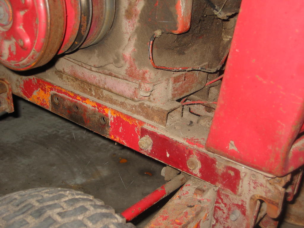

pfrederi 20,228 #28 Posted September 12, 2018 If you want to put the 10hp small oil pan (Shaker mount) on the Charger frame mount you could do something like this on my next project tractor. He put a 16hp small pan on a charger 12 frame. two chunks of steel tube. The igniton is no issue just swap out the ignition switch 1 Share this post Link to post Share on other sites
Pullstart 69,620 #29 Posted September 12, 2018 Are the bolt patters on the oil pan the same, weather big of small? I wouldn’t mind some spacers and longer bolts I suppose. The exhaust I could modify and I thought about swapping all the electronics, as I have eliminated all safeties and have a simple harness now. Share this post Link to post Share on other sites
pfrederi 20,228 #30 Posted September 12, 2018 This is going to be a winter project so i am not 100% sure but I looked in the spacer tubes and under the frame. the bolts go up through the frame rails through the Spacer tubes and into the small oil pan. I can not tell if he had to drill any new holes in the frame... 1 Share this post Link to post Share on other sites

Pullstart 69,620 #32 Posted September 13, 2018 Spent some time in the shop last night, i’ll see if I can get some pics soon. The 12 is engineless and I spent a few minutes with a putty knife cleaning years of grime away. I’ll pull the 10 off the C-101 and see if it bolts up, then make spacers if needed. I forgot to measure pulley height, they might be close from the bottom of the oil pan, I think the 12 is just overall a taller mill. Share this post Link to post Share on other sites
