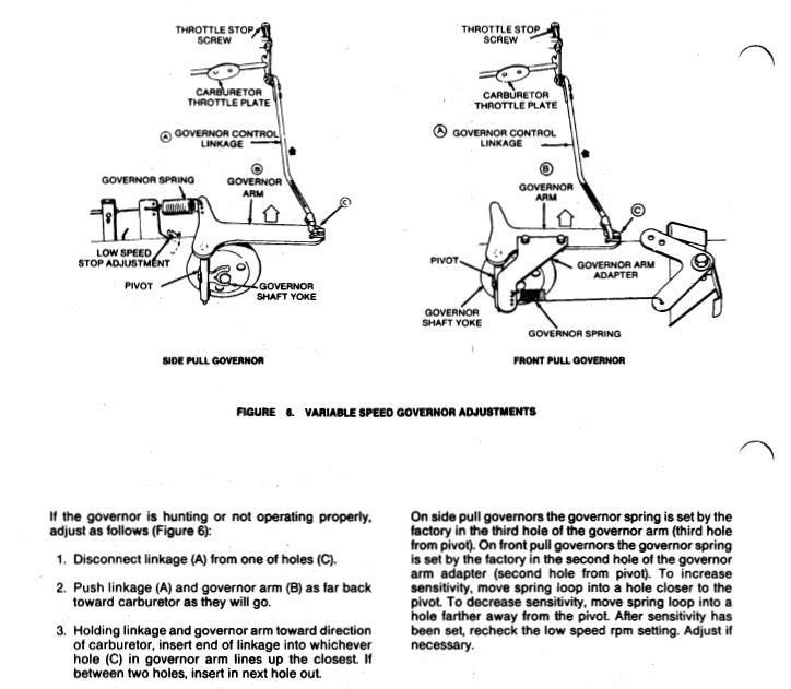

Kurt-NEPA 756 #5 Posted July 24, 2018 Any chance you could post a picture of what you have? Share this post Link to post Share on other sites
Kurt-NEPA 756 #6 Posted July 24, 2018 This any help? Share this post Link to post Share on other sites
Robertrueker 1 #7 Posted July 25, 2018 Crazy thing is.. that was exactly how I had put it back on. In the first place. But I thought there had to be something wrong. I had the cable adjusted wrong so it would pull the lever but just would bottom out and not operate the carb. I adjusted the cable so it can use the spring to push as well as pull. It's working fine now. Thanks Guys I was having a moment there🤦 1 Share this post Link to post Share on other sites
