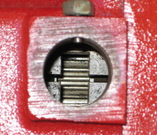

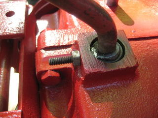

953 nut 69,120 #3 Posted July 21, 2018 If your shift lever comes out of the transmission or is stuck in one gear first back out the “Dog-point” screw that retained the shifter. Take a look in the hole the shifter came out of to be sure it is in neutral as shown above. Inspect the dog-point to be sure it is in good condition and back off on the locking nut a couple of turns. Insert the shifter and run the dog-point into the dimple in the shift lever collar snugging it up with an allen wrench, don’t tighten it. Be sure the shifter works smoothly then tighten the lock nut while holding the dog-point steady with the allen wrench. 6 3 Share this post Link to post Share on other sites
JP56 42 #5 Posted August 7, 2018 On 7/21/2018 at 1:29 PM, Achto said: You should be able to put that back in. Make sure that your shift forks are aligned in the neutral position. Adjust the set screw for it & you'll be good to go. Achto & 953 Nut, thanks for the info ! 953Nut, It was that set bolt that holds the shaft bearing into the hole. It actually had stress fractured where it was a smaller diameter where it meets the threads. I took a grade 8 1/4 x 20 bolt, machined the threads down at the end of the bolts, until the diameter was thin enough and just long enough to bottom out in the collar hole, left the hex head on the other end and used a double 1/4 x 20 nut set for locking it into place! It was so loose after the end snapped off, I was able to unscrew it w my finger tips ^ the smooth end was just lying in the threaded hole & had to be pushed out with a pin. Thanks for the great pics! 1 Share this post Link to post Share on other sites
