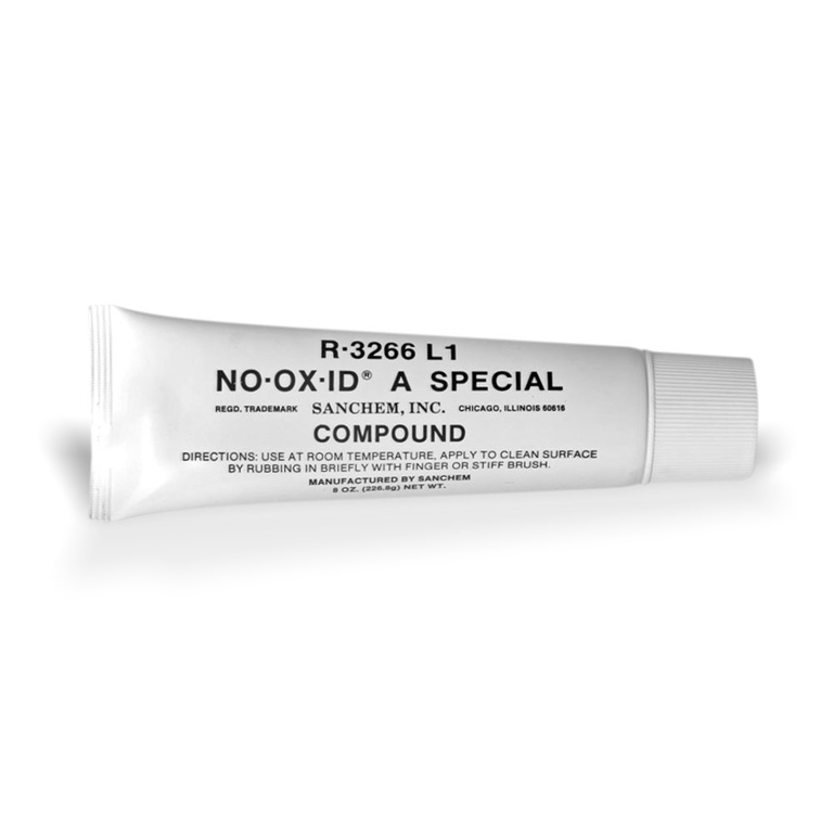

Sarge 3,470 #8 Posted July 28, 2018 I use a product called No-Ox, it's used by satellite and phone companies to prevent corrosion on connections inside of those pedestals you see along the road. Very tough to get your hands on it, but I've never had anything corrode again once the parts are coated with this stuff. Sarge 1 Share this post Link to post Share on other sites

Sarge 3,470 #10 Posted July 28, 2018 No, this is a communications-specific product - the company that makes it is in Chicago, I need to spend some more time getting in touch with them and trying to source some of it in these little tubs, love the stuff but I'm getting pretty low from the original score from a splicer that worked for AT&T. He said the stuff was in nearly every pedestal they used in/around the cell towers as well as their satellite link boxes - they kept those pedestals stocked with it when wiring had to be replaced or modified. Sarge Share this post Link to post Share on other sites

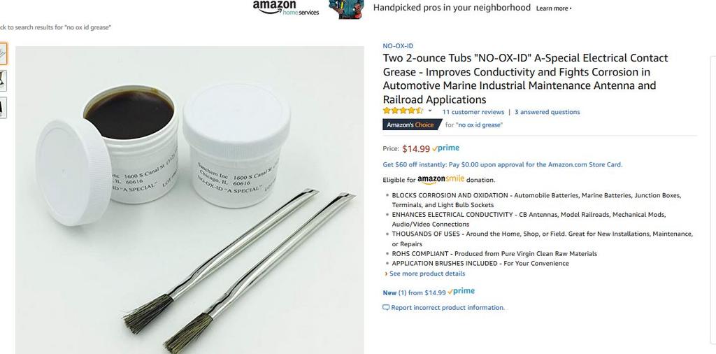

formariz 12,352 #11 Posted July 28, 2018 is this it? Amazon carries it. Share this post Link to post Share on other sites
pfrederi 19,245 #12 Posted July 28, 2018 Also in small tubs 1 Share this post Link to post Share on other sites
Sarge 3,470 #13 Posted July 29, 2018 Well, I'll be dipped in dielectric grease, and here I about gave up trying to find the stuff - excellent find, guys ! When I do any splices on terminals, the wire gets crimped properly, then soldered. While the terminal is still quite hot, it's dipped into the No-Ox just enough to coat the mechanical connection part of the terminal, then the shrink boot is put over the barrel part and heated to set it down and allow the adhesive to flow out. I've always used this process on race cars, heavy equipment, semi trucks and my offroad truck builds - never had a terminal rot out since. Added the two tub deal to my list, thanks again guys.... Sarge Share this post Link to post Share on other sites
