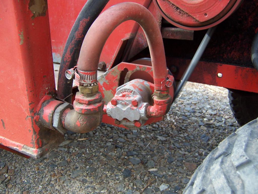

19richie66 17,937 #28 Posted July 21, 2018 You could mount a small pump directly below the engine and drive it off the electric clutch setup. Plenty of ground clearance and enough frame there to bolt a bracket to. 1 Share this post Link to post Share on other sites

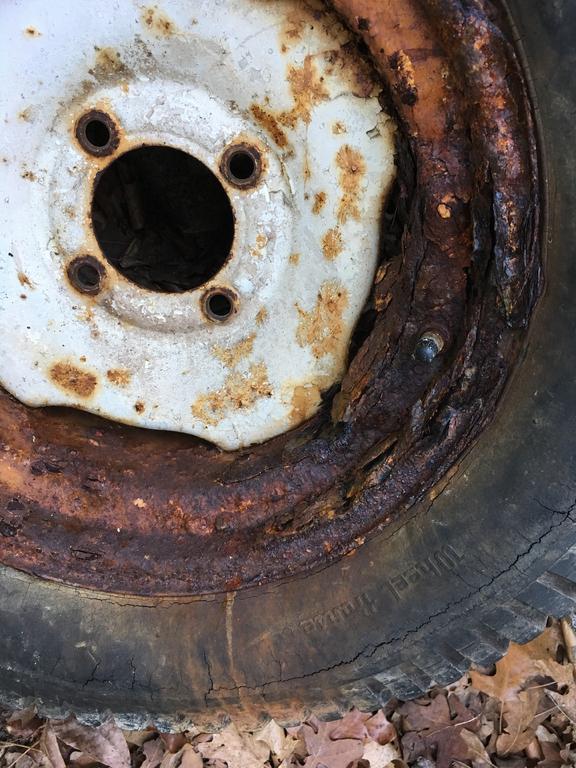

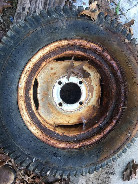

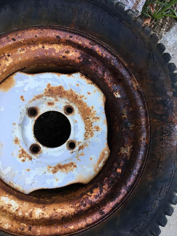

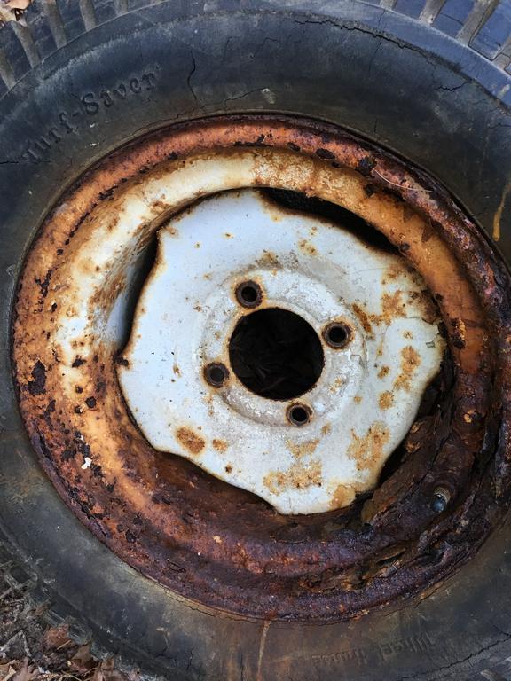

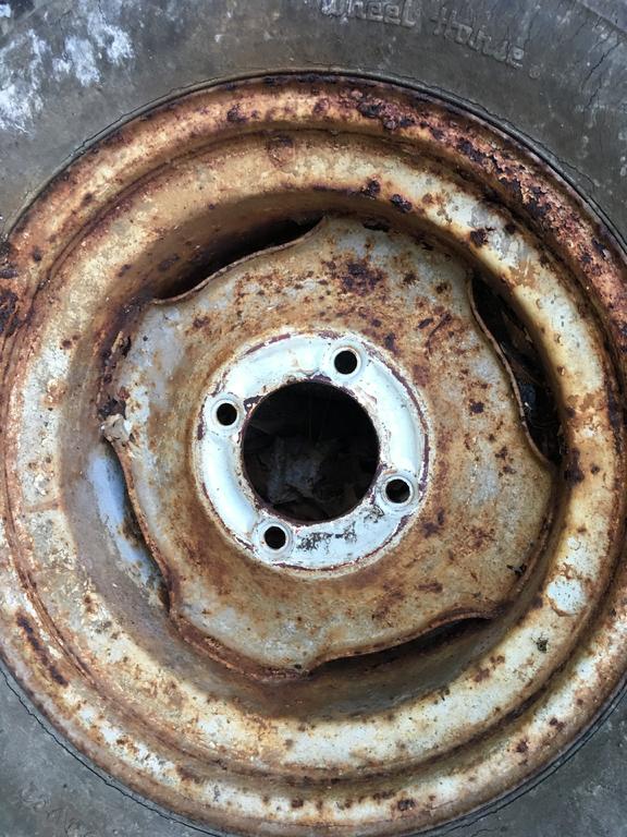

T-Mo-(Moderator) 4,979 #29 Posted July 21, 2018 Here are the liquid filled tires and rims that, for some reason, Randy didn't want. As you can see, the rims and tires are in pristine condition and Randy could have sold them for big, big bucks. The first three pictures, the tire still has about all the stuff in it, and as you can see, the one (back) side of the rim is pretty well rusted beyond repair. The front side, the third picture, the rim looks okay. The last 3 pictures was the other tire, and it had leaked over half of the stuff out. 3 Share this post Link to post Share on other sites
953 nut 70,076 #30 Posted July 21, 2018 6 hours ago, 19richie66 said: You could mount a small pump directly below the engine and drive it off the electric clutch setup. Plenty of ground clearance and enough frame there to bolt a bracket to. That is how the pump for my loader is mounted. 1 4 Share this post Link to post Share on other sites

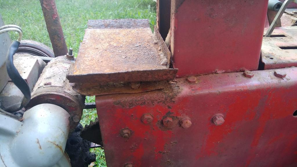

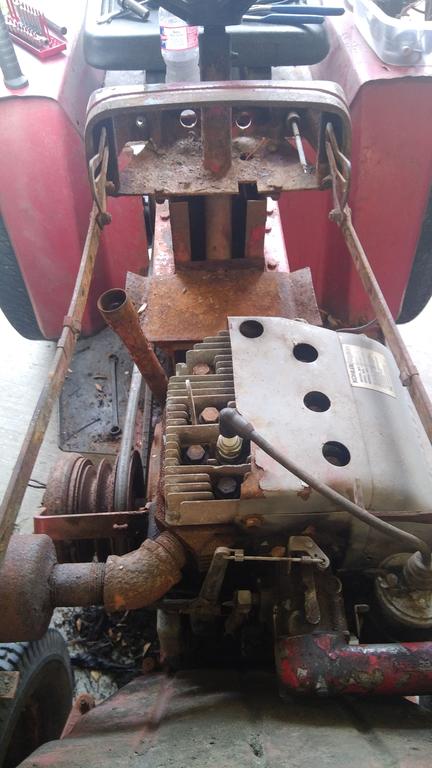

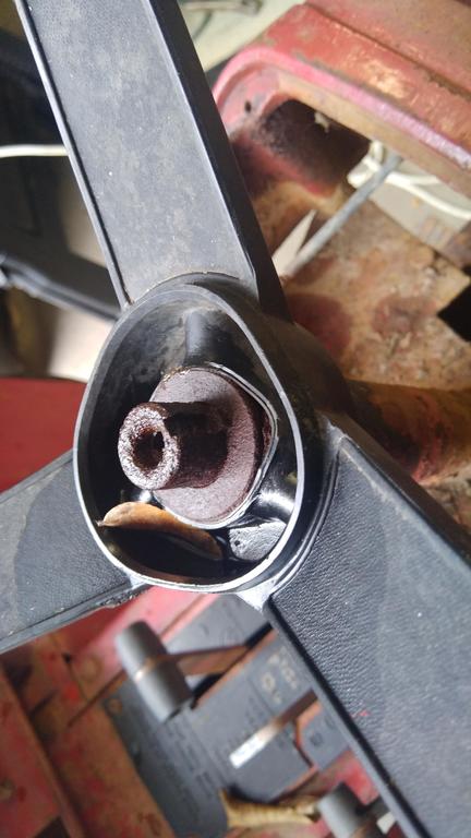

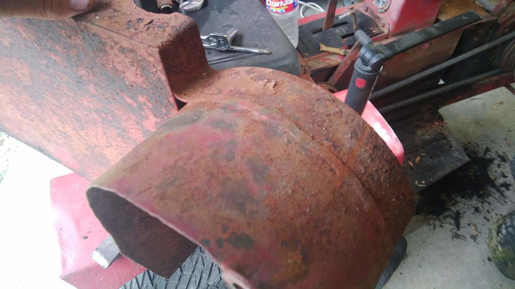

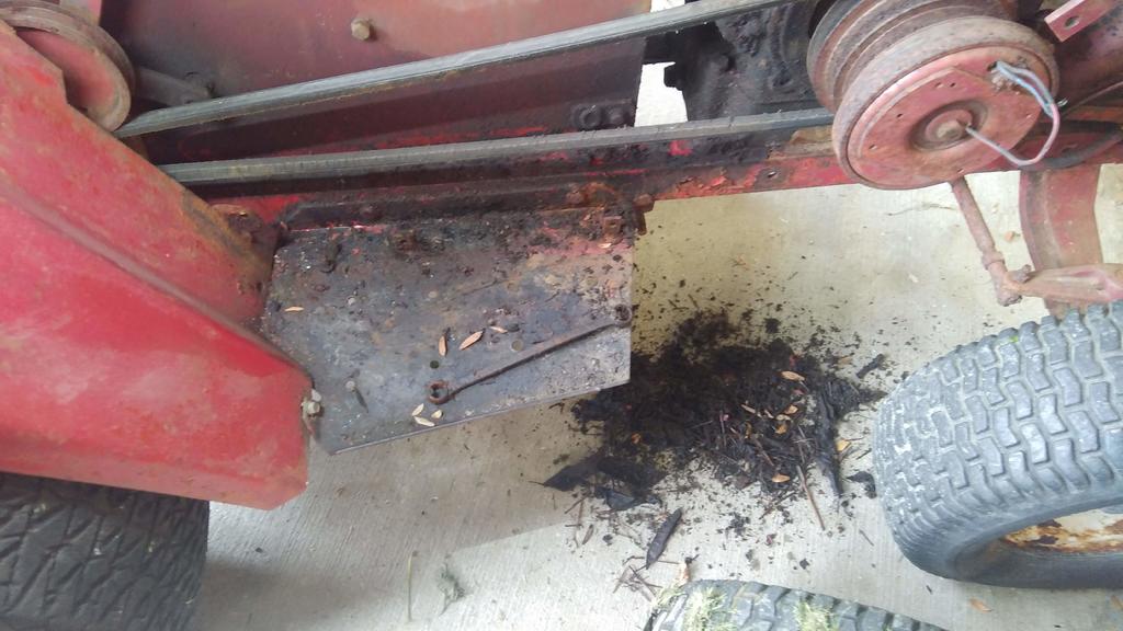

RandyLittrell 3,946 #38 Posted August 19, 2018 (edited) Started a little tear down on the Mule this afternoon. The wiring is toast, so I cut it all out. I will use some of the threads on GT14's for inspiration on the wiring, you guys have made them look pretty nice. Also starting putting liquid wrench in nuts and bolts and the steering wheel. By the looks of it, that wheel may not make it off in one piece. I know its not original anyway and this is not gonna be a resto. Pulled the right side panel off and its was full of sticks and such plus a wrench, but luckily it has had enough leaks it was oily not rusty!! It looks like it has a PO mod on the right side shield, but looks half way decent so I may make it a little nicer and leave it on there. Looks like the PTO is gonna need some work! Anywho, here are a few pics from today. Edited August 19, 2018 by RandyLittrell 2 1 Share this post Link to post Share on other sites

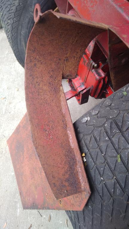

RandyLittrell 3,946 #39 Posted August 20, 2018 (edited) Here is the pic of the side panel. Got a free wrench out of the deal! Edited August 20, 2018 by RandyLittrell 1 2 Share this post Link to post Share on other sites

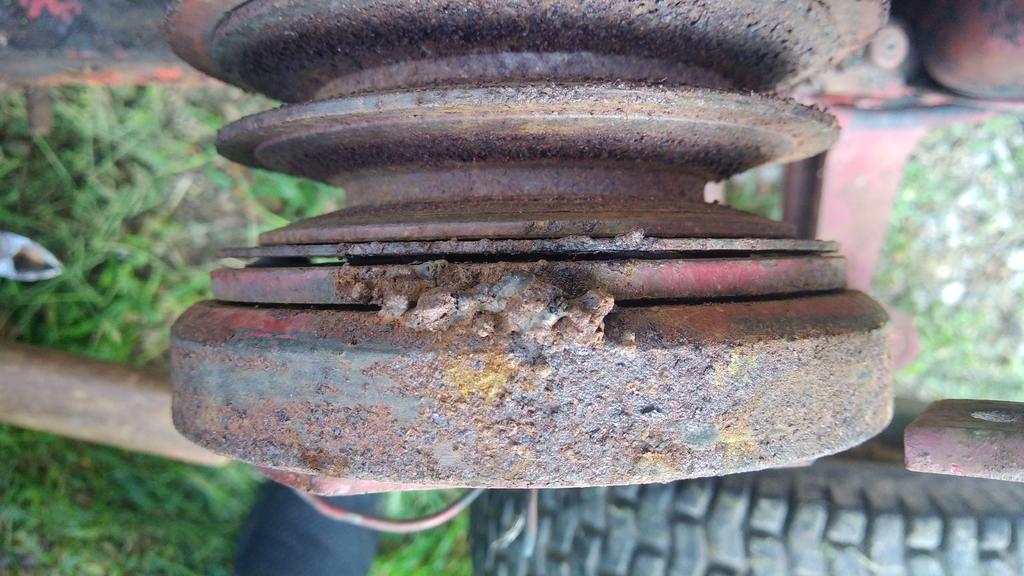

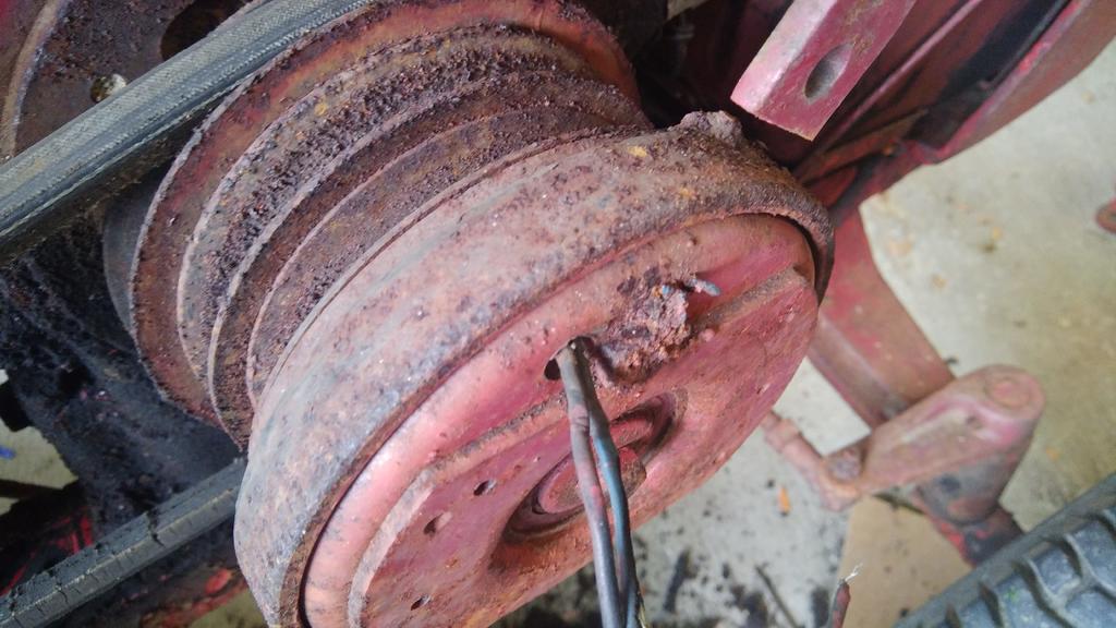

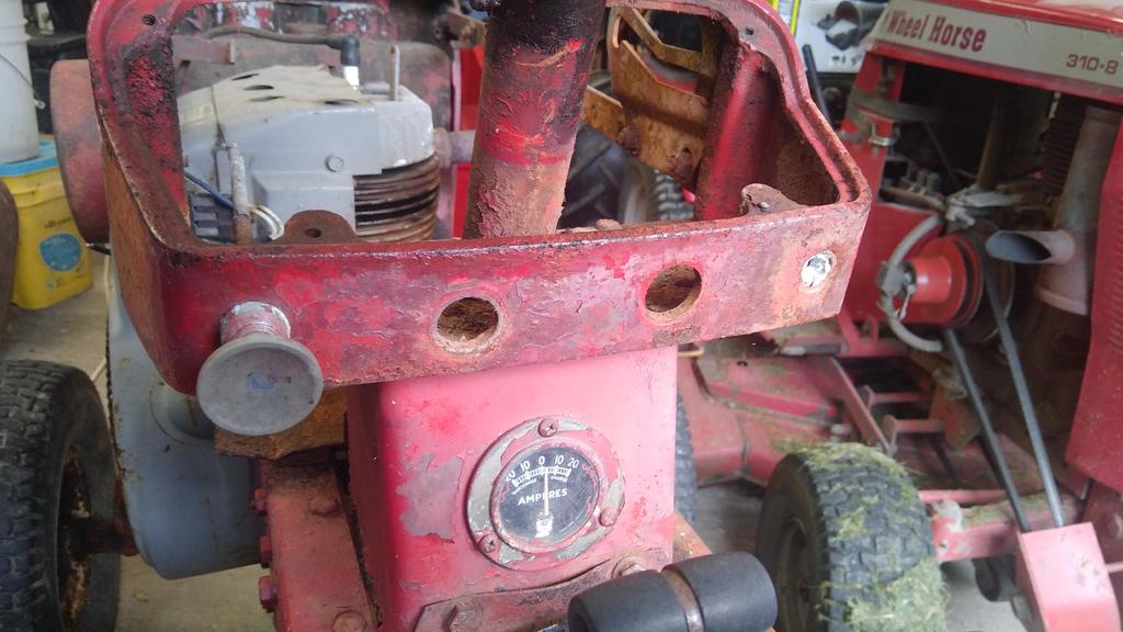

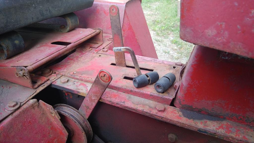

RandyLittrell 3,946 #44 Posted August 25, 2018 Went out to the shop this morning and removed a few more parts this morning. I have been surprised by the fact that even though it looks plenty rusty all the bolts have come apart really easy. This makes me happy! The motion control lever and drive belt lever knobs came apart easy and are in good shape. I think I will try to use them on the throttle and choke levers. Somebody did some BAD PO mods to the PTO! I am guessing the pto quit working so they just welded it up! But fortunatly they did a really crappy job of welding and I should be able to fix it. The battery tray is a bad shape and I will have to make a new one. I may have to beg for someone to show what it is supposed to look like. I am taking lots of pics, because this may be a long build. 3 1 Share this post Link to post Share on other sites
Pullstart 71,483 #45 Posted August 26, 2018 At what point does someone look at that weld job, and say “yeah, that’ll work!”? 2 2 Share this post Link to post Share on other sites
AMC RULES 37,260 #46 Posted August 26, 2018 Kinda common looking... them vintage welds. 3 Share this post Link to post Share on other sites
RandyLittrell 3,946 #47 Posted August 26, 2018 45 minutes ago, pullstart said: At what point does someone look at that weld job, and say “yeah, that’ll work!”? I know, right!! Looks like I will be able to grind the welds away and be able to fix the PTO. The also cut off the tab that holds it still, but I could fix that too. I guess I need to figure out if its fixable before I spend too much time on it. 4 Share this post Link to post Share on other sites
