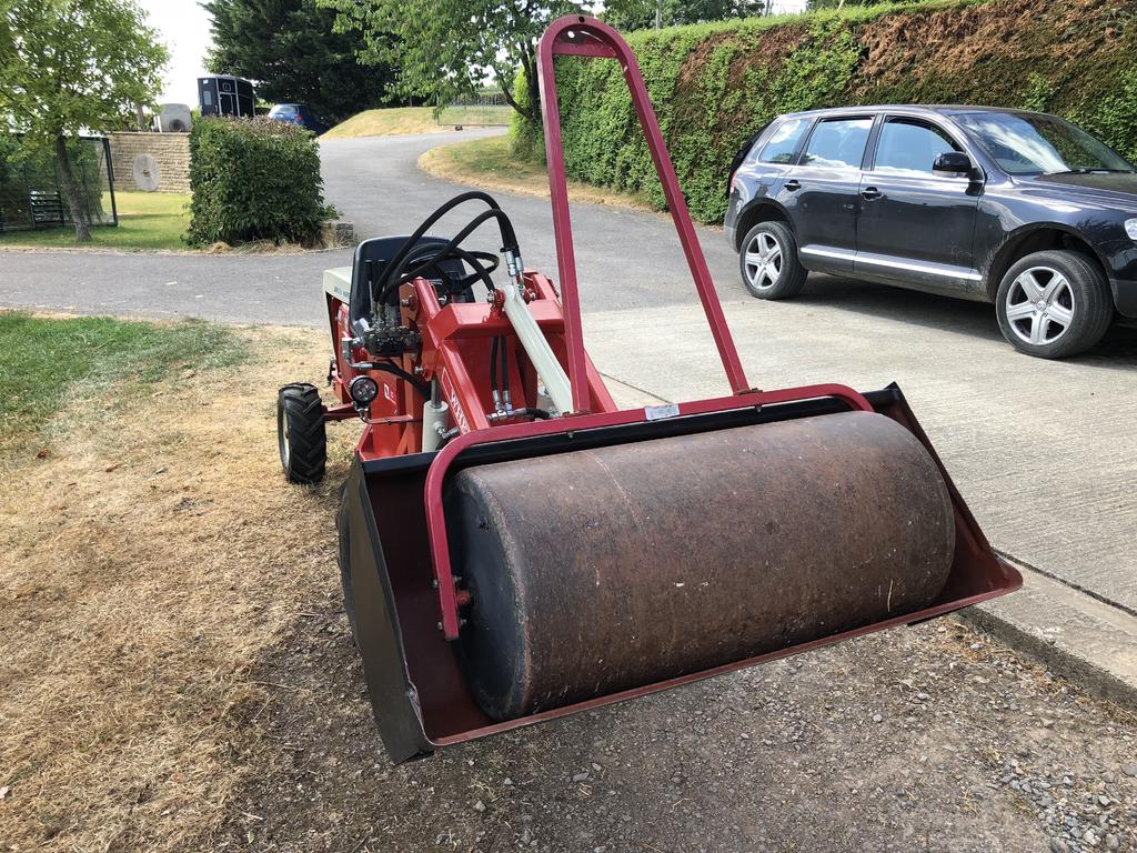

farmer 1,081 #32 Posted October 26, 2018 @Tractorhead have you posted pictures of your loader? It sounds interesting especially as it’s aluminium! I think i misunderstood your question, did you mean how much will mine lift? If so I haven’t actually tested it with weights. I have picked up this lawn roller full of water without sitting in the seat, so I’ll guess with a driver 200/250kg? 2 1 1 Share this post Link to post Share on other sites

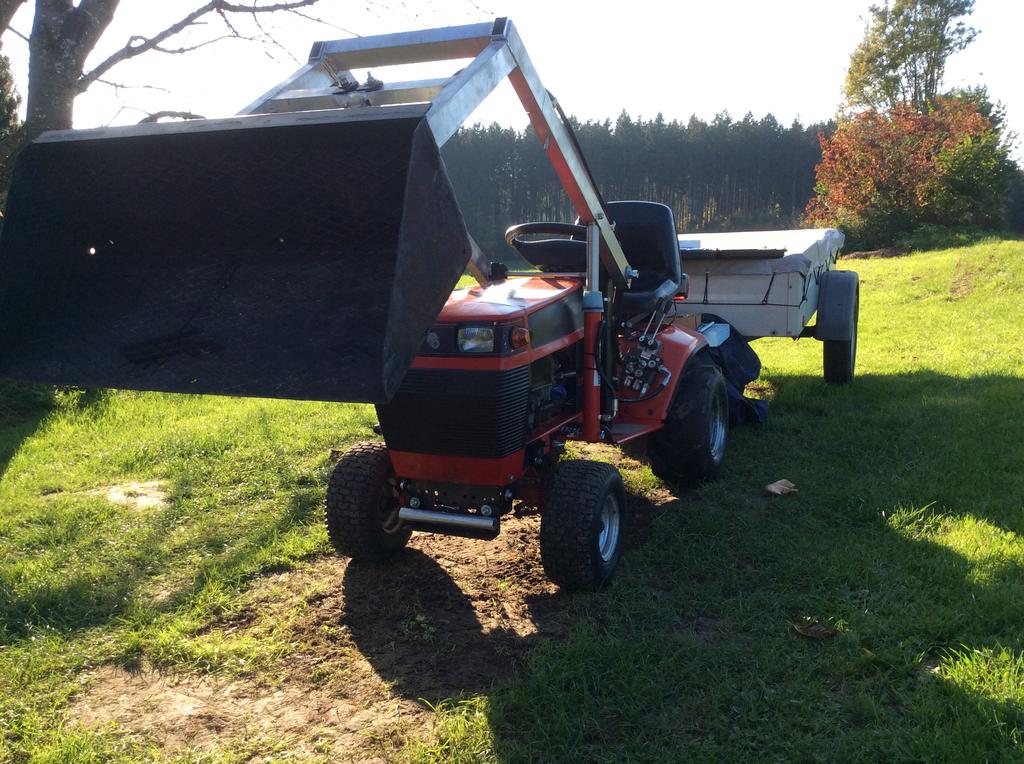

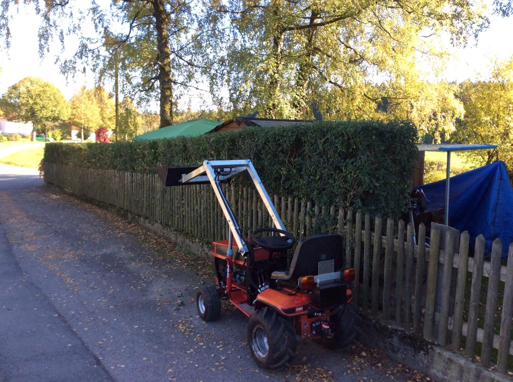

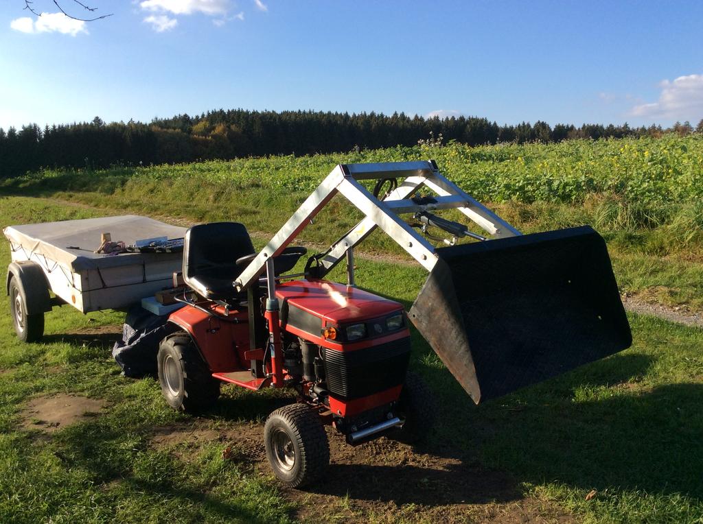

Tractorhead 9,217 #33 Posted October 26, 2018 Here are few pics, actually i got few troubles, the onan engine E125V give a loud "popp"sound while running and stops immediately working and will not run further. Several time, i fire it up, there is running mass of gasoline and a bit oil out of the engine, but i can actually not said, what happen. The "popp" sound doesn't sounding for a easy to solve issue. the flywheel is allready proven and look so far fine with all needed parts. 2 Share this post Link to post Share on other sites
