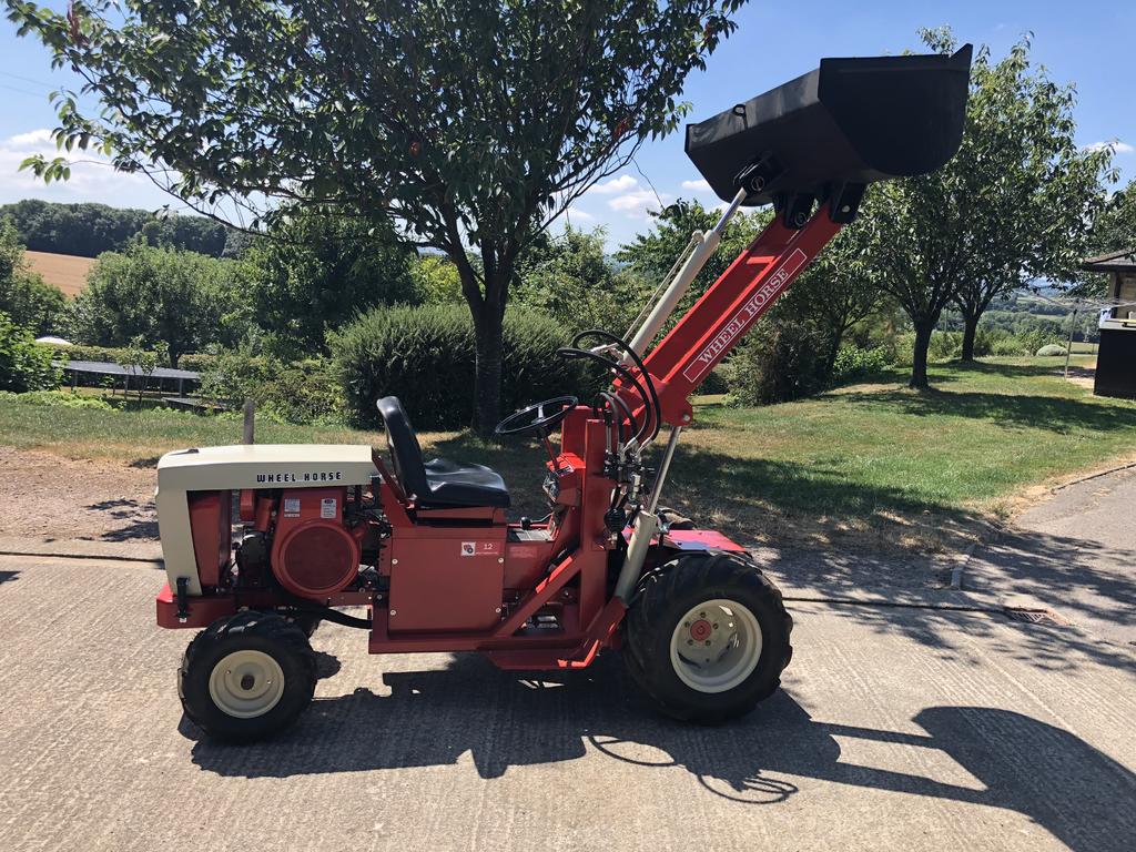

farmer 1,081 #1 Posted July 15, 2018 As this is now a completed project I thought I’d post a picture up in this section. (More pics in Restoration’s under ‘Something different’). 11 20 1 Share this post Link to post Share on other sites

The Tuul Crib 7,340 #4 Posted July 15, 2018 (edited) It's a hybrid!! Super Pooper. Scooper! extremly impressed! Great work! Edited July 15, 2018 by The Tool Crib 2 Share this post Link to post Share on other sites
Chris G 3,369 #5 Posted July 15, 2018 I watched that build and it was very well done on your part. Very awesome machine you fabricated and looks really good as well. 1 1 Share this post Link to post Share on other sites
Sparky-(Admin) 24,635 #6 Posted July 15, 2018 Damn incredible that is!! For show? Or will it get dirty? 1 1 Share this post Link to post Share on other sites
BOB ELLISON 2,983 #7 Posted July 15, 2018 That is one of the best conversations on a tractor I've ever seen. Plus it even more stable like that then a d200 with a loader on the front. Great job Farmer 2 1 1 Share this post Link to post Share on other sites
Cvans 1,009 #8 Posted July 15, 2018 Beautiful craftsmanship. Really impressive! 2 1 Share this post Link to post Share on other sites
farmer 1,081 #9 Posted July 15, 2018 Thanks chaps for your nice comments, to answer your question Sparky it’s definitely for work! I have a lot of horse poop stacked by our stables that I loaded by hand once, never again! Straight after that experience I started planning my loader, I’ve got a fair sized garden and I’m not getting younger so I see a very useful future for it. 2 5 1 Share this post Link to post Share on other sites

Retired Wrencher 6,452 #11 Posted July 16, 2018 Farmer. Well done. It turns like a fork lift. Make sense that way put the load up front. Enjoy the tractor. Or would you call it that? 1 1 Share this post Link to post Share on other sites
posifour11 723 #12 Posted July 19, 2018 @farmer does it have power steering, too? Share this post Link to post Share on other sites
DennisThornton 4,773 #13 Posted July 19, 2018 With most all of the weight on the rear, or the now front, or the 12" rims, or under the bucket or whatever I should refer to now, I don't think it needs power steering. 1 1 Share this post Link to post Share on other sites
farmer 1,081 #14 Posted July 19, 2018 Regarding power steering. 1 Share this post Link to post Share on other sites
DennisThornton 4,773 #15 Posted July 19, 2018 I find the more I look at it the more I like it! Could we get some photos of the owner/builder and it in use? 1 Share this post Link to post Share on other sites

DennisThornton 4,773 #21 Posted October 24, 2018 Now that you've had a chance to use her, what are your thoughts? What are you even more thrilled with? What might you do differently? 1 Share this post Link to post Share on other sites
71_Bronco 1,072 #22 Posted October 24, 2018 Now that is sweet. Just curious, any concerns about having too much weight on the now-front, and the now-rear-steering wheels not having enough weight on them to maneuver? 1 Share this post Link to post Share on other sites

farmer 1,081 #25 Posted October 24, 2018 How do all, l made a short video awhile back but for some reason (me I suspect) it wouldn’t load. I will try again soon or maybe use YouTube whichever works. There is one major disadvantage to my design and one little ‘niggle’ that I’m going to have to live with. The niggle is the hyro over runs, I’m having to squeeze down on the backwards pedal to slow down going forwards and vice versa when in reverse, I’ve got the hang of it but it’s not perfect by any means. The major disadvantage is unless your lifting or crowding as you load the bucket, you break traction and spin the wheel. This isn’t a problem most of the time as I’m loading dung off a concrete floor and can keep the driving wheels loaded down. But say you wanted to grade a surface you would struggle to stop the wheels from spinning, in that type of situation a tractor loader would be much better tool. But for my needs it fits the bill, one other thing, I’m really surprised how heavy the steering is with or without a loaded bucket, the seating position and oil tank all add up I suppose. 4 Share this post Link to post Share on other sites
