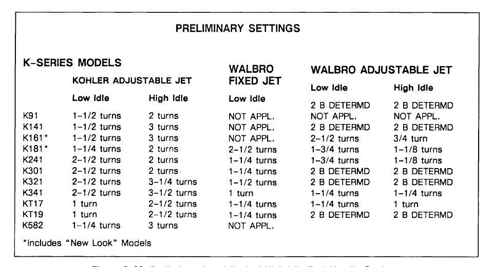

Bpriest 0 #7 Posted July 15, 2018 I will get back to you guys. Quick question whats the spec on adjustments for the points as well as the carb jets. Thanks for the welcomes and quick responses! Share this post Link to post Share on other sites

Bpriest 0 #9 Posted July 16, 2018 Will do, does anyone have the specs on the points adjustment and carb adjustments Share this post Link to post Share on other sites

Bpriest 0 #11 Posted July 19, 2018 Okay so today I adjusted the carb to spec. I then checked for spark, I got 12volts at the + of the coil. No spark at the plug, I then disconnected the condenser on the - of the coil and still no spark. I have fuel, I haven’t tested compression but it’s got enough to open the rain cap on my stack. What do you guys think. Share this post Link to post Share on other sites
