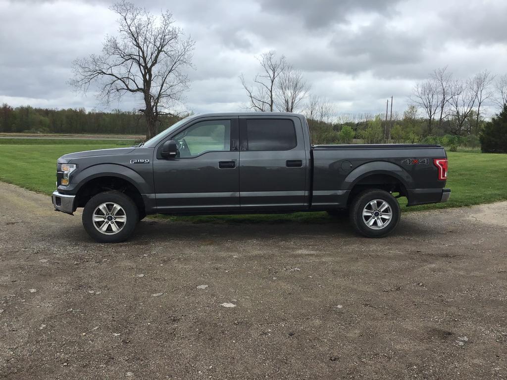

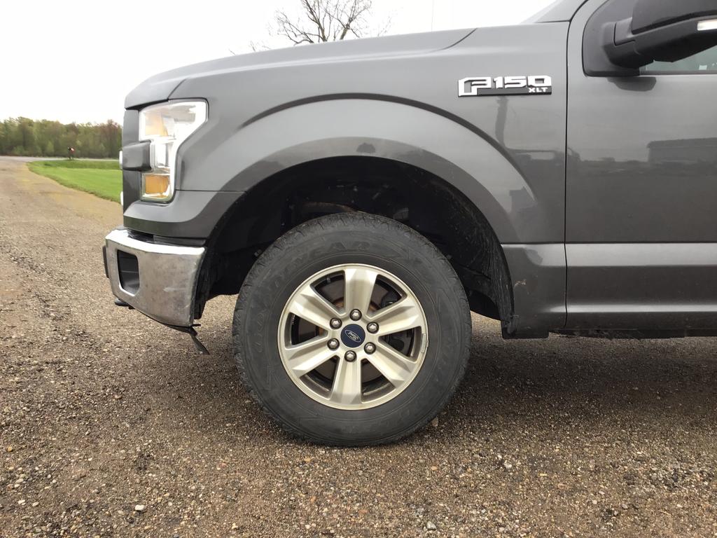

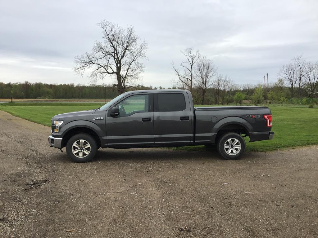

Today’s shop time will be spent with a little customization in mind.  This customer’s truck has nothing wrong with it... Well.... Sorry I have to... Ford the most part :ROTF:
I’m installing his 2.5” front leveling kit, then off to the alignment rack, then his new tires and wheels will show up later this week.
  • Haha 1
pullstart
Phase one is complete.  It’s off to the alignment shop, then tires and wheels will arrive soon.

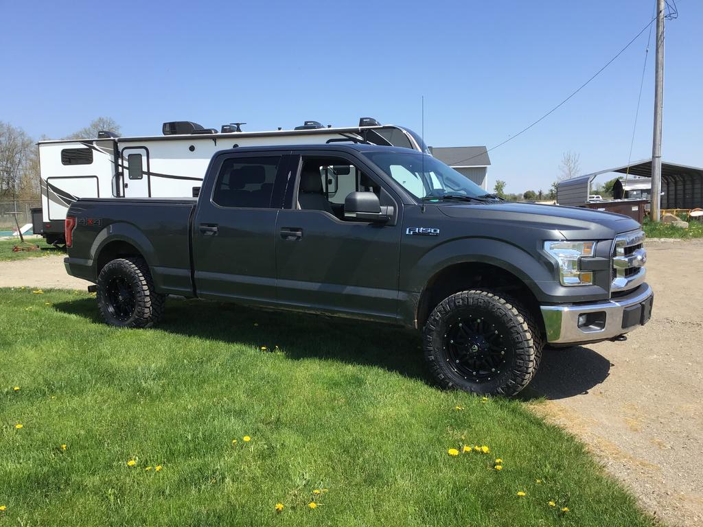

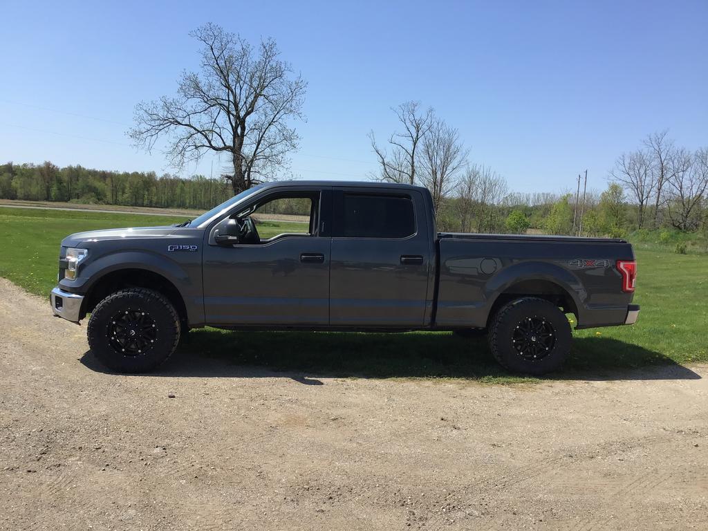

Tires and wheels showed up today!
It’s a 2016 F-150 with the 5.0 v8 and 4x4.
Mammoth 2.5” leveling kit (spacers)
33x12.50r18 Nitto Ridge Grappler tires
18x9 5” backspace Fuel Hostage wheels
it looks good, the lift supposedly clears 35” tires, but I’m glad we agreed on 33’s.

ebinmaine
Looks good Kevin. I prefer older boxy style trucks myself but that is definitely a big improvement on that one.
I have no first-hand experience with using lift kits or spacers but I've known people over the years that have. I'm kind of wondering if when they say you can clear a certain size tire that it is while the truck is not moving over any bumps???

pullstart
:ychain:
I prefer older to newer in most situations as well.  Most companies don’t disclose the width of tire, wheel or backspacing when advertising their maximums and backspacing combined with turning radius are huge when figuring clearance.
