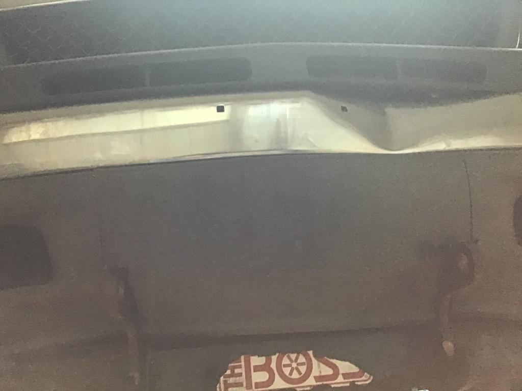

Pullstart

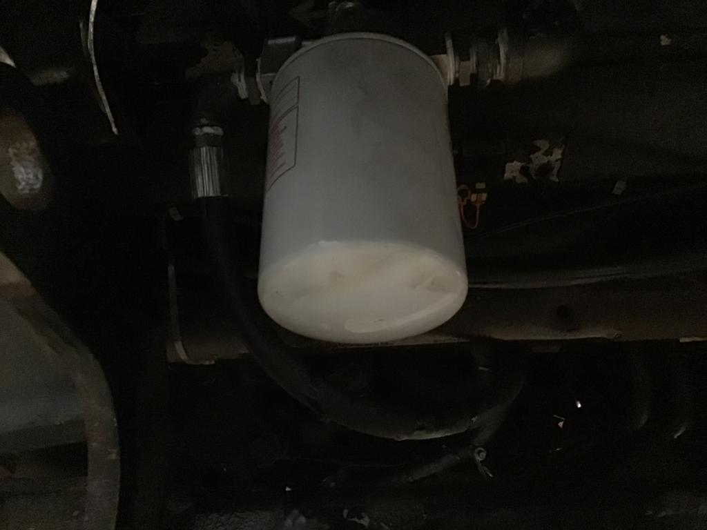

Getting somewhere, my father in law helped me in the shop a bit tonight.  We mounted the filter behind the bumper.  We can remove the center plastic section and service the filter now.  Wiring is together, linkages and driveshafts are tight.  We need to finish the exhaust, install tires and fill the transmission.

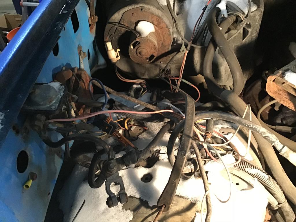

Pullstart

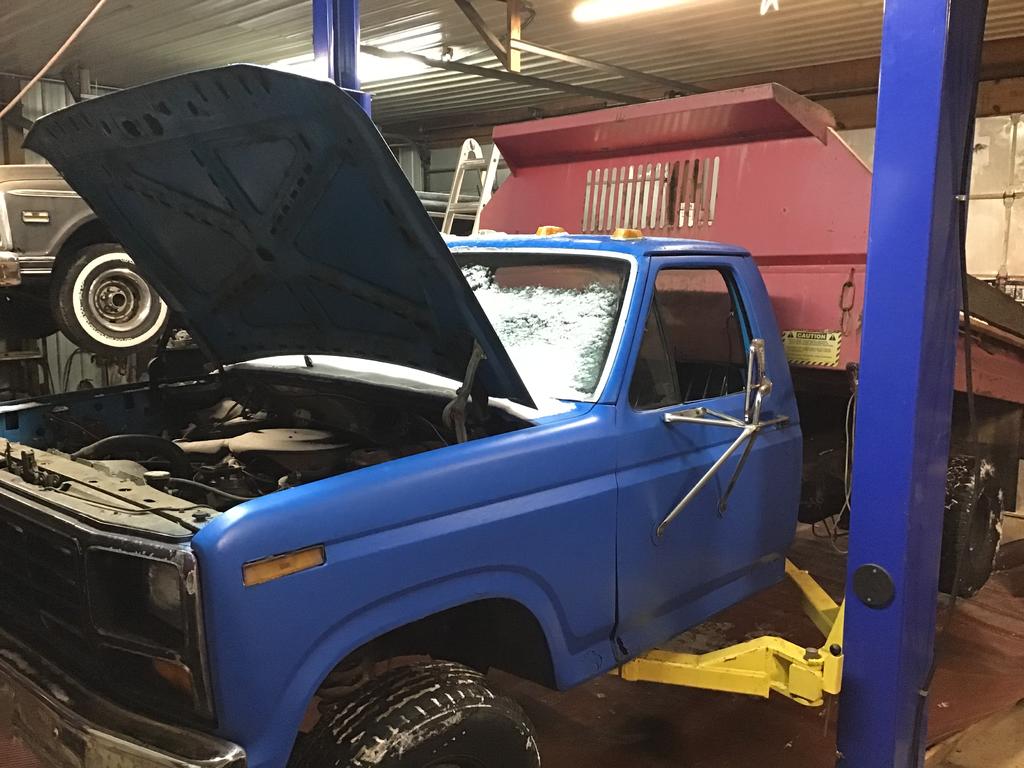

Next shop subject, this old 84 F-350.  I’m not a blue oval guy, let’s just clarify this right now, however I think this was a pretty slick body style.  Based on the wiring cobble jobs alone, I’m pretty sure the PO shouldn’t have been allowed to breed.  This will never be intended as a road vehicle.  When we started talking about a pond, I got this for what I would call a song.... sight unseen at the auction.   It runs and the dump system works great for what I need.  I might be getting a visit in the next month from my big brother, who can use his work excavator on the weekends to help me dig a pond.  I better get this thing moving and stopping!  I need to fix the transmission lines, brake lines, wiring and maybe clean the carb.  I replaced the fuel lines already, along with the distributor cap and rotor.

ebinmaine
Kev. Don't worry about not being a blue oval guy.
We can all be re-educated...
:P
Seriously though. I've had all kinds of brands of cars but really only Chevy and Ford trucks. Had about equal luck with both of them. I agree that the body lines of those early 80s are nice.
I'll be looking forward to see how this one works out for you.

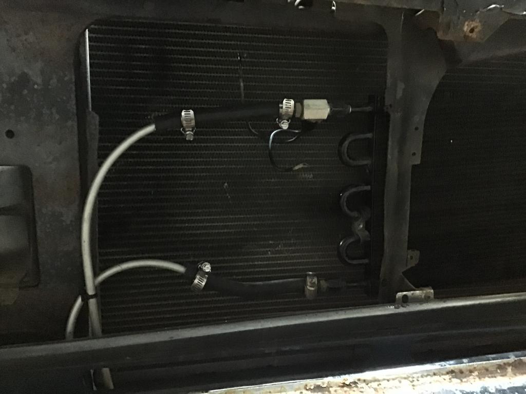

Pullstart

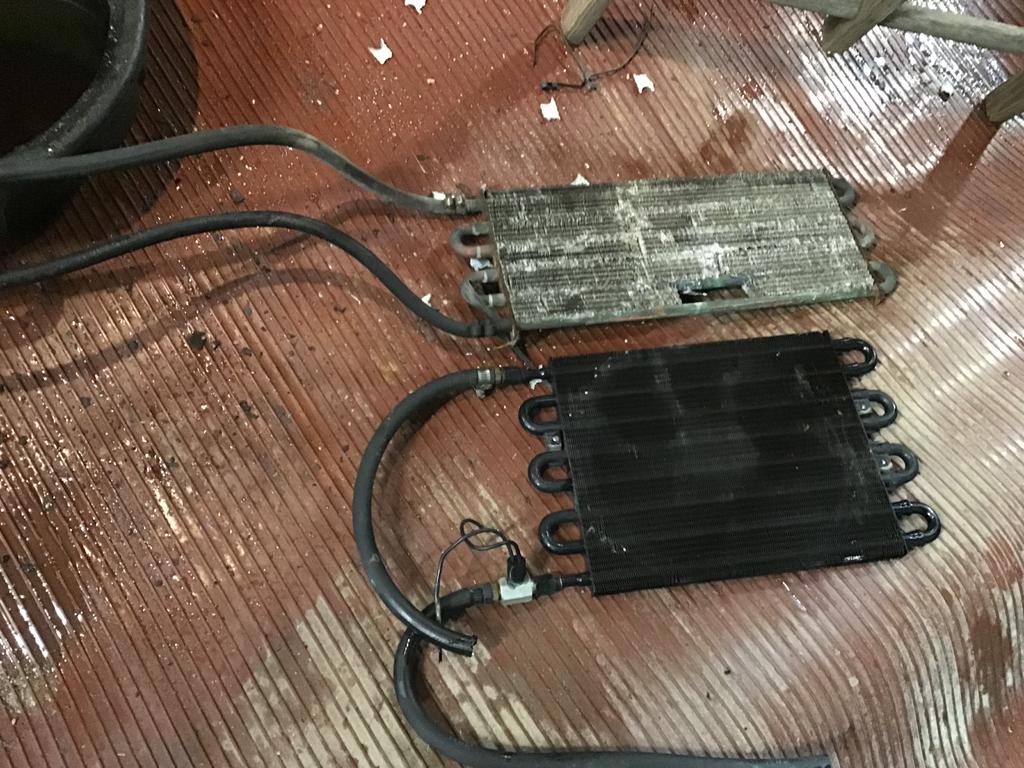

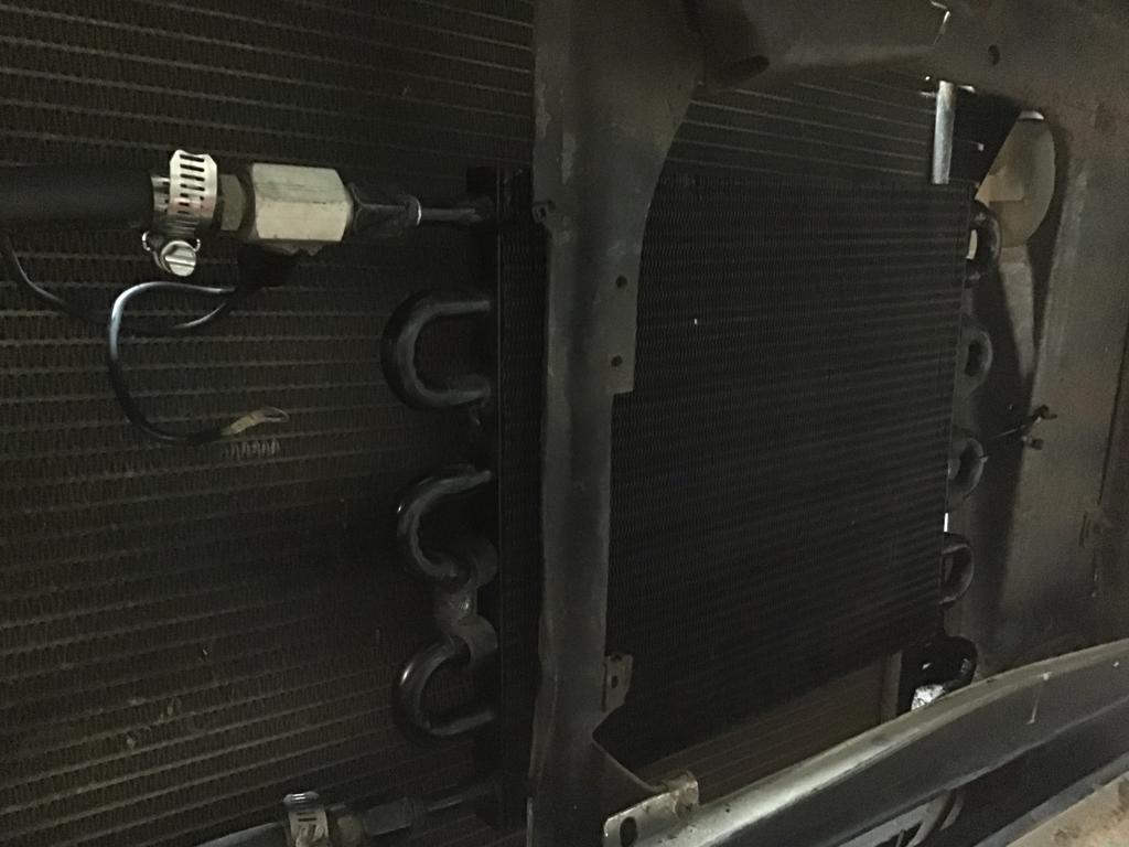

Old cooler on top, new to this truck on bottom.  The lines were leaking, but if I can upgrade AND fix, why not?  It has a 180 degree thermostat switch if I ever decide to install a fan, but I doubt this will ever work hard enough to get too hot.

Pullstart
Well, the lines are fixed and the “new” cooler is mounted.  Oh how versatile zip ties are!

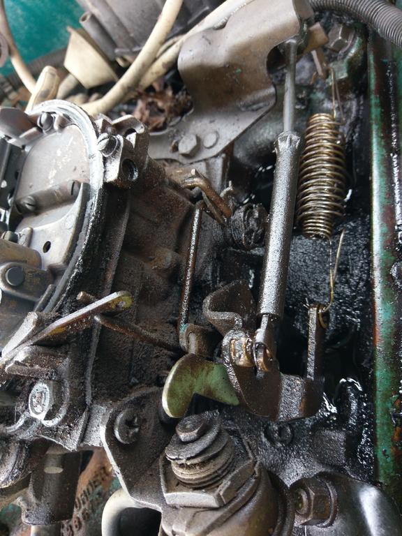

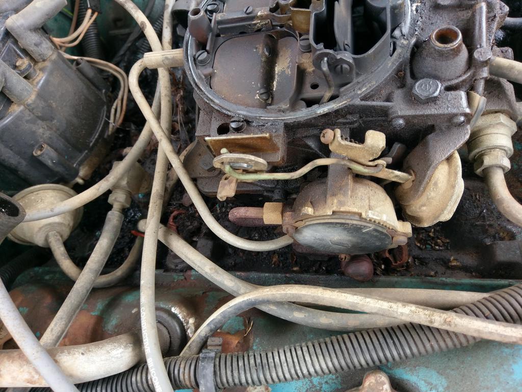

Pullstart

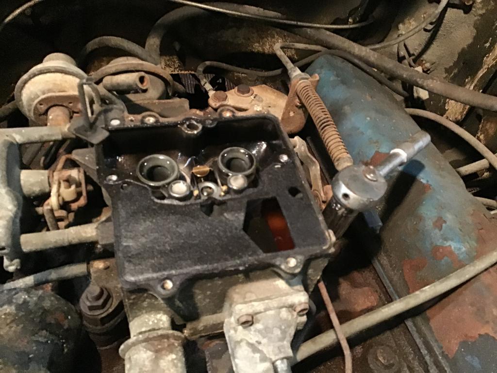

Yum.... molasses!  Most of the carb is plugged up.  I’m pulling it to clean up,  then we’ll see if it’ll start by itself maybe?
  • Like 1
  • Sad 1

Tractorhead
Looks yummy....
do you did a oilchange also?
think if the carb lookslike that, maybe the oil looks identically?
Just after a first Fireup i would do.

WVHillbilly520H
I feel ya... But you'll get it.
  • Like 1
ericj
if the carb looks that bad, what does the fuel tank look like ?????

Pullstart
eric j
It was empty, luckily.  When I ran new fuel lines, I put two inline filters right near the tank to switch out often, if needed.

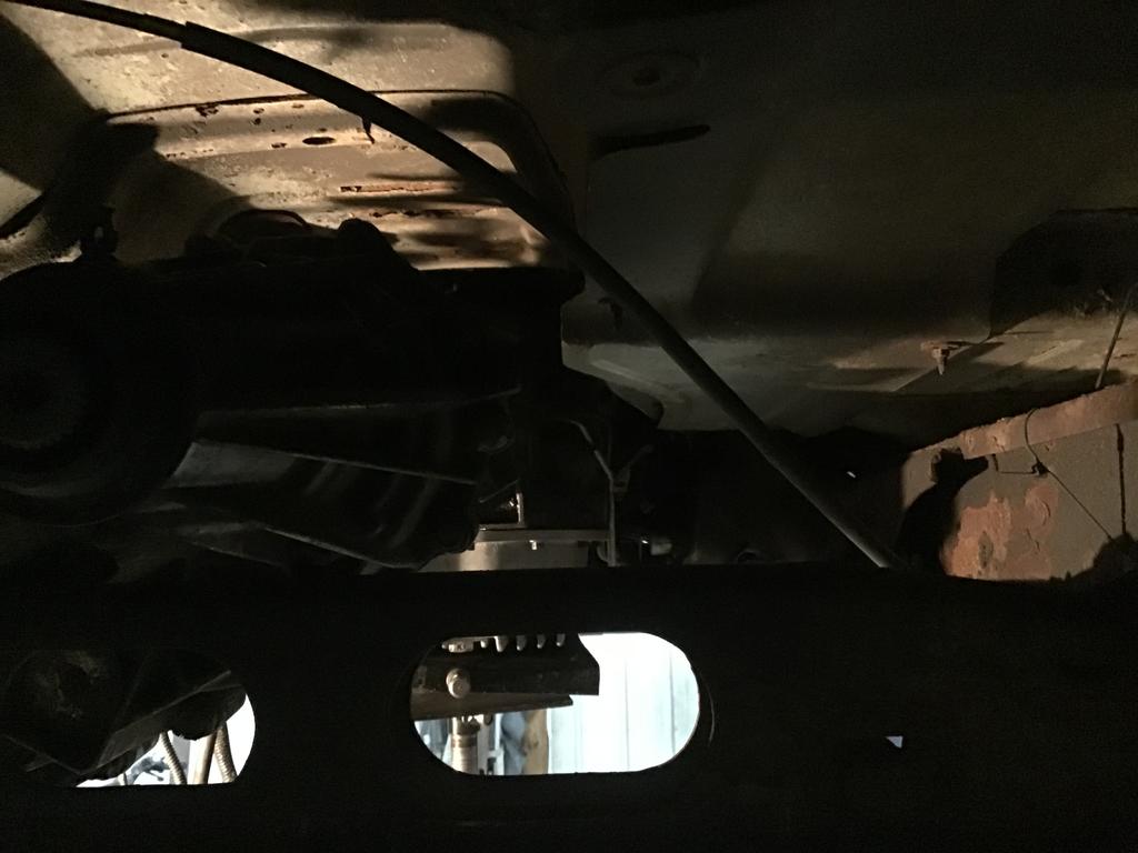

Pullstart
What a mess.... someday I’ll have the time to clean house again!  Pulling the t-case for inspection today.
  • Like 3
Pullstart

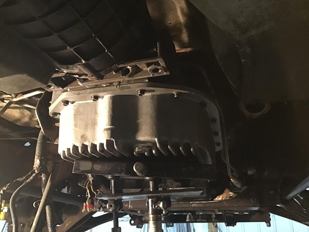

Well, good news is that the t-case is fine.  Bad news, the transmission output shaft is spinning free when the gear selector is in park, drive, reverse, or anywhere in between.
