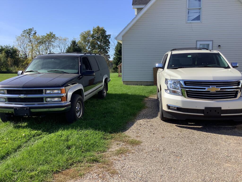

I mentioned this in the vintage rides thread, but momma got a “new” 1997 Suburban K2500 from Aurora, CO.  Selling her ‘15 LTZ, we made enough money to pay for the new ride and have just $1,100 in shipping costs and PayPal fees.
She works at a factory in town and most people there seem to have no regard for other’s property.  Her last three Suburbans have gotten more door dings than one vehicle should ever get… and she even parks IN THE LINES!
Since she drives but 6 miles round trip daily, fuel mileage is pretty much not a concern.

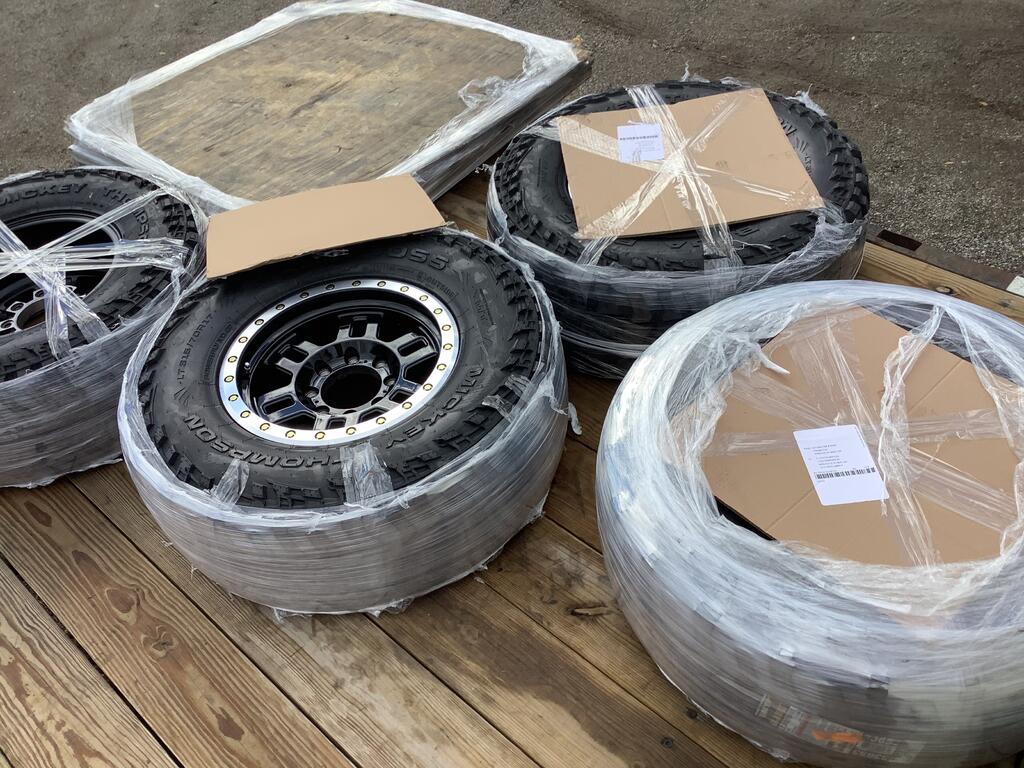

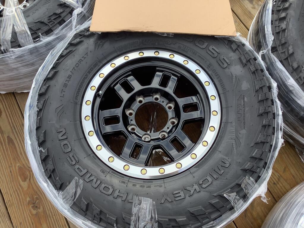

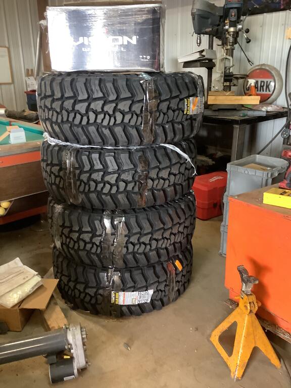

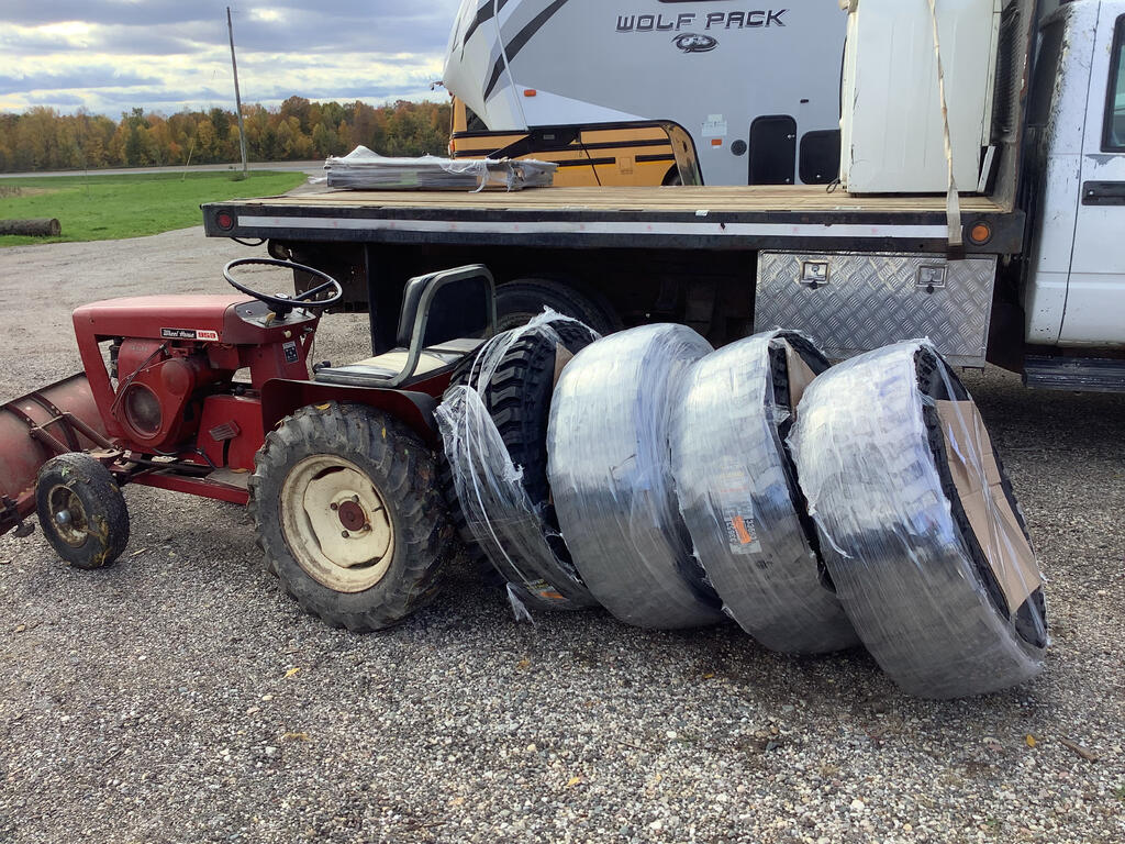

Today, the first piece of the puzzle showed up.  Or is this the second?  The 6” Superlift is still on the way.  These are 35x12.50-17 (or metric equivalents) Mickey Thompson Baja Boss load range E tires on Vision Manx wheels.
953 shown for size comparison.  Quite the meats!

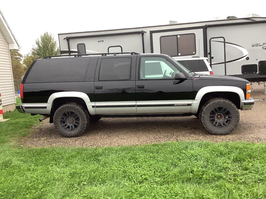

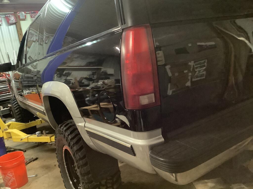

So far, our biggest issue has been headlight direction.  It was shining for coons across four lanes to the right and 100 feet high.  We found out how bad they were on our way home from Chicago in a rain storm after dark.  Tonight, I made enough room in the shop to pull a vehicle in and do some adjustments.  Time for a test drive.
Headlights are much better!  I imagine I’ll need to adjust them again soon after an altitude adjustment.

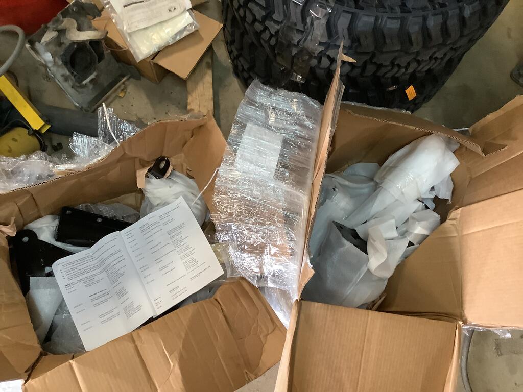

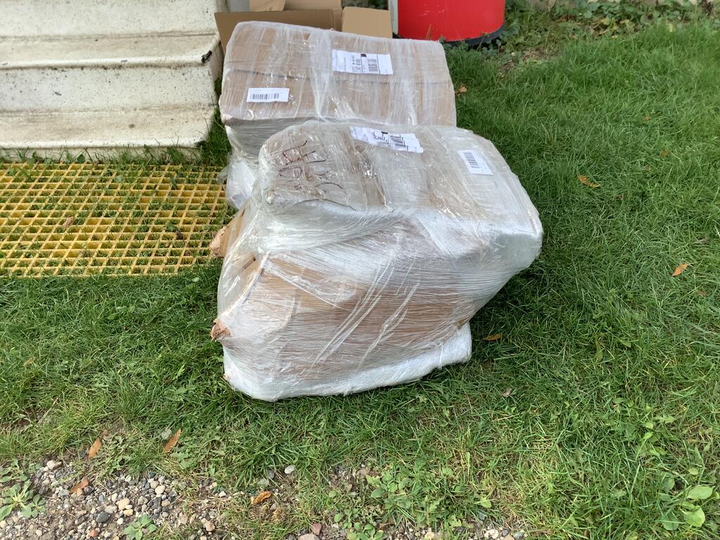

Though they look like Ace Ventura delivered them, these two boxes showed up and the contents seem intact. I believe one or two more boxes are expected, but time to start sorting pieces and fasteners!

Sooo, what's in the boxes?? Some added ground clearance?

most of the added ground clearance… missing shocks and rear lift.

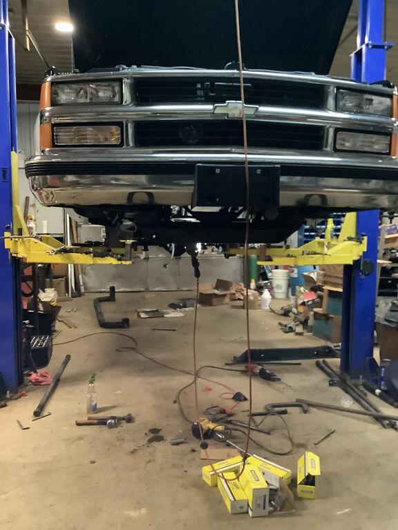

I had a cylinder #8 misfire problem on my truck we call “The Cadillac,” plaguing me.  I replaced the  spark plug, then swapped wires with another cylinder, then replaced the coil, but still no change.  Still #8 misfire.  Air, spark, fuel?  No fuel.  Yesterday, I quick pulled the fuel rail and that injector was absolutely packed full of rust.  A byproduct of old fuel lines, I suppose.  Remember, even though it has all new fuel lines, that truck sat about 4 years.
A little brake clean, compressed air, and an electrical jumper test, it went back in.  No troubles any longer!

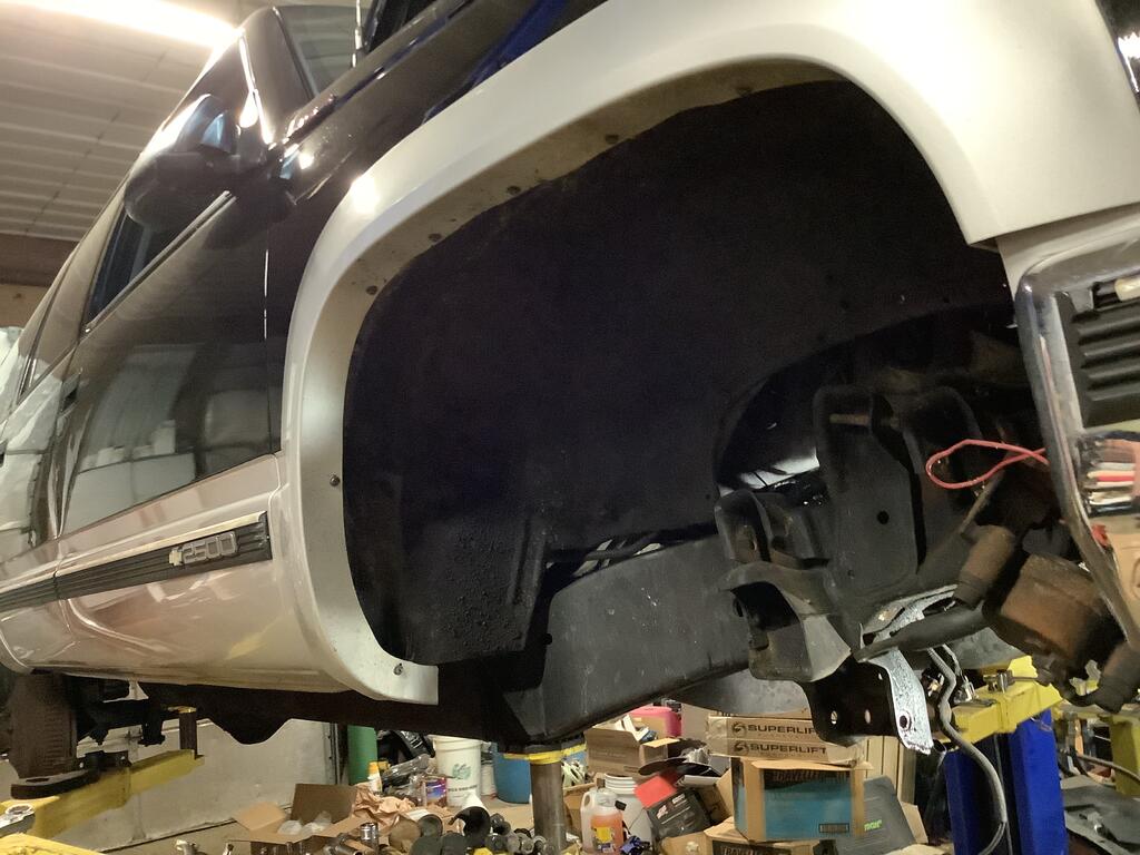

Today, the lift begins on the Suburban.

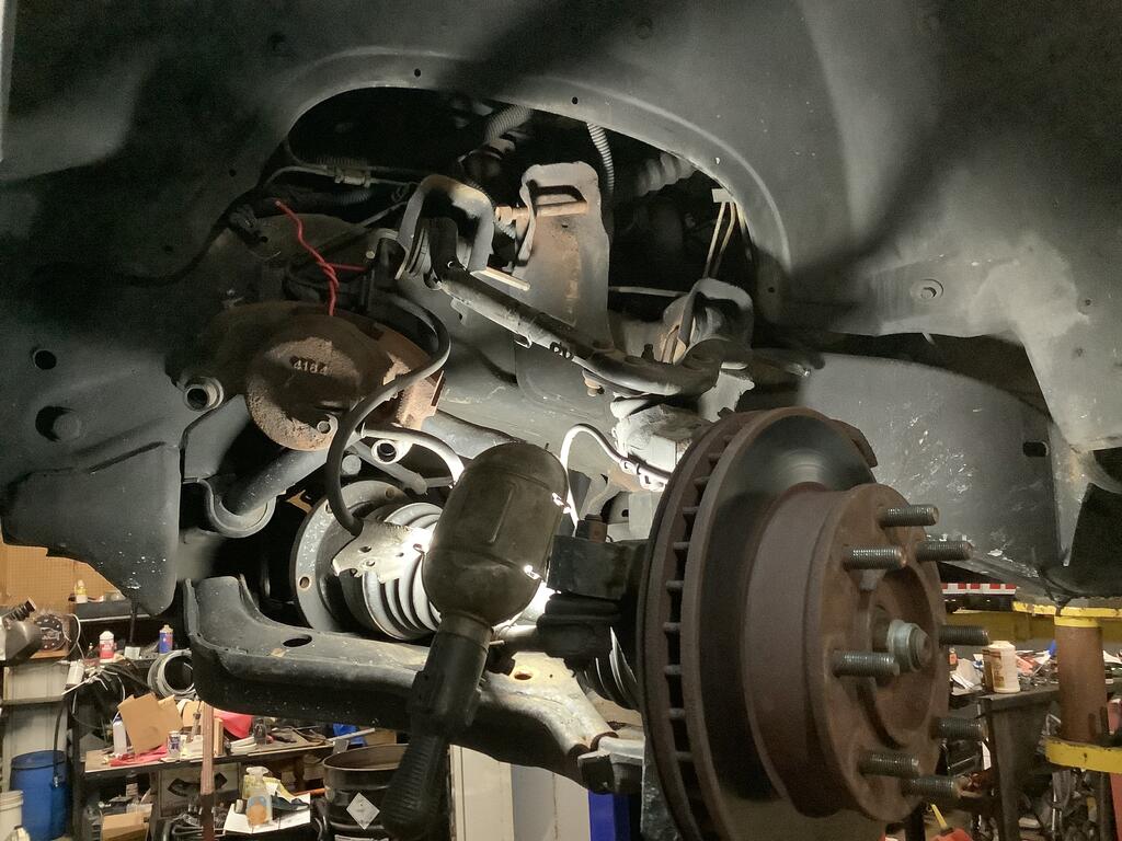

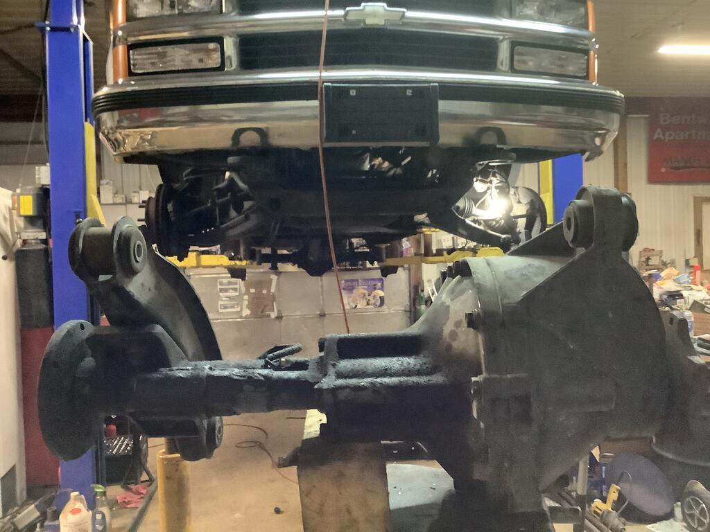

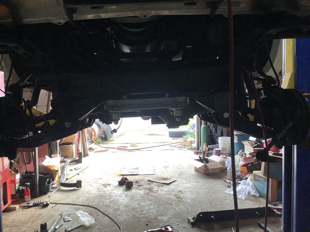

The torsion bars and crossmember are removed.  They will drop below the frame and the transmission crossmember.
LF suspension is hanging, front differential is removed.  Almost time to start putting it back together!

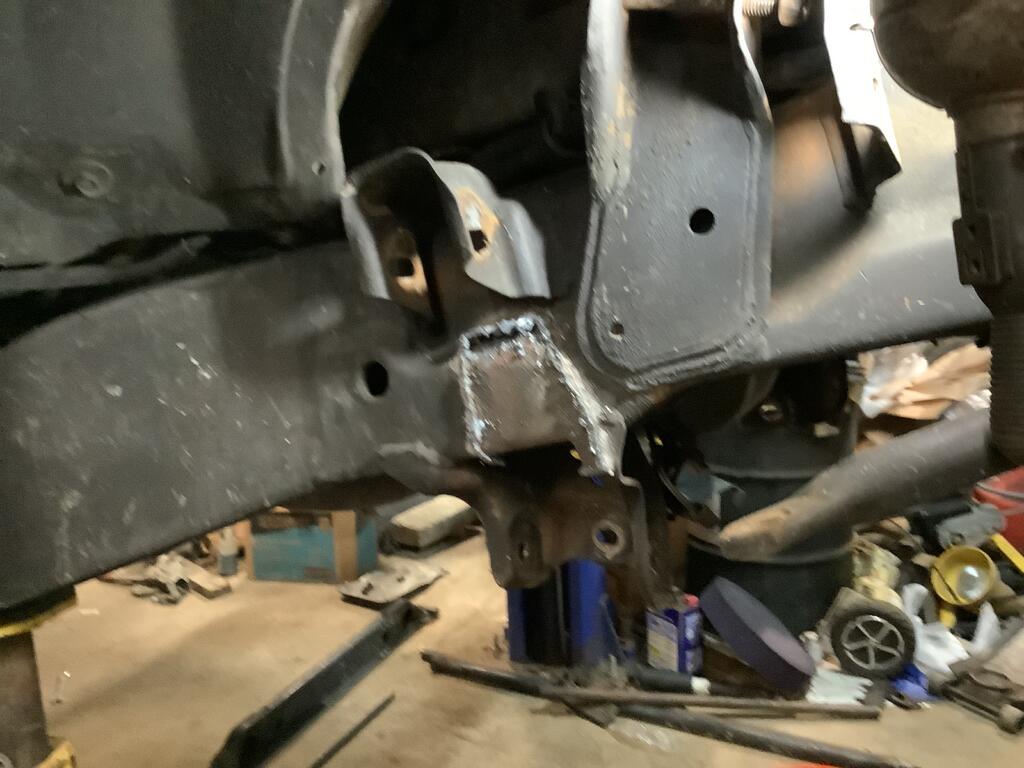

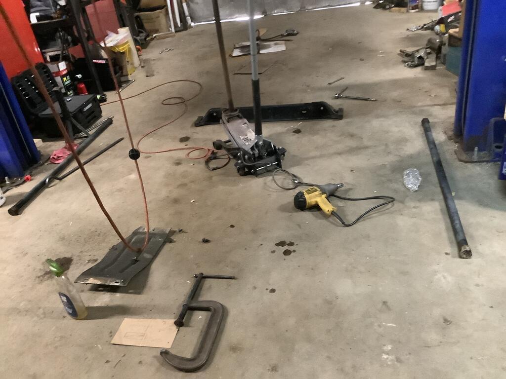

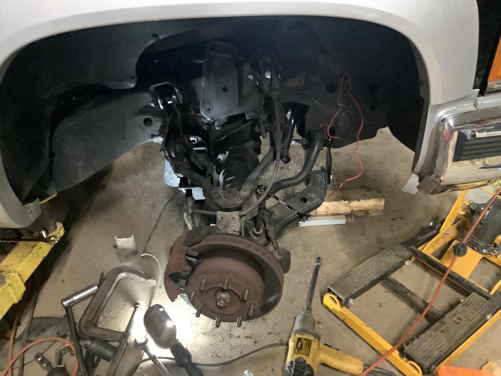

Past the point of no return… turned the hot wrench on and trimmed some unused bracketry.
All front suspension is removed.  Now it’s time to dress the slag areas, prep and paint the frame, then begin reassembly.

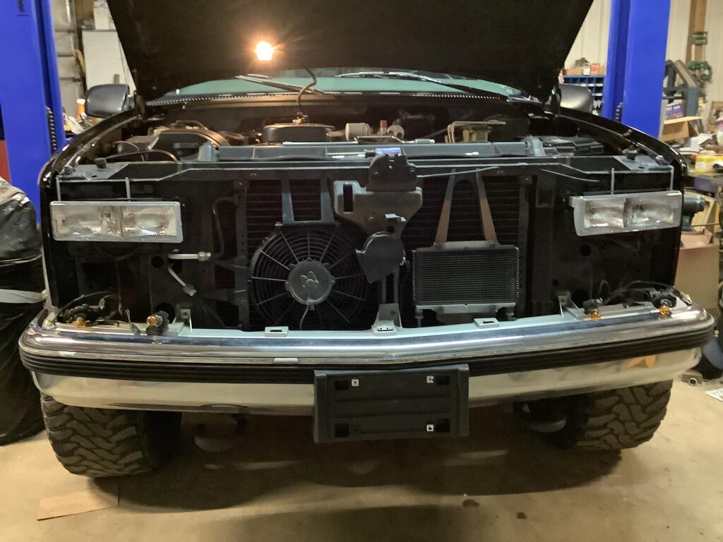

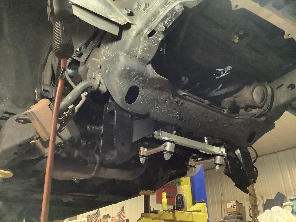

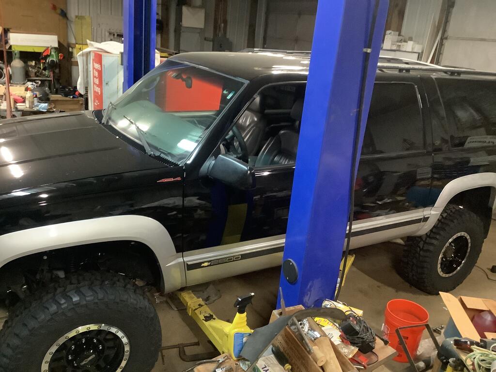

One corner very close to complete finally.
Driver’s side is together.  Need to replace inner tie rod ends, install the torsion bars, put the tires on and eyeball the camber and toe to get to the alignment shop… then start on the rear.

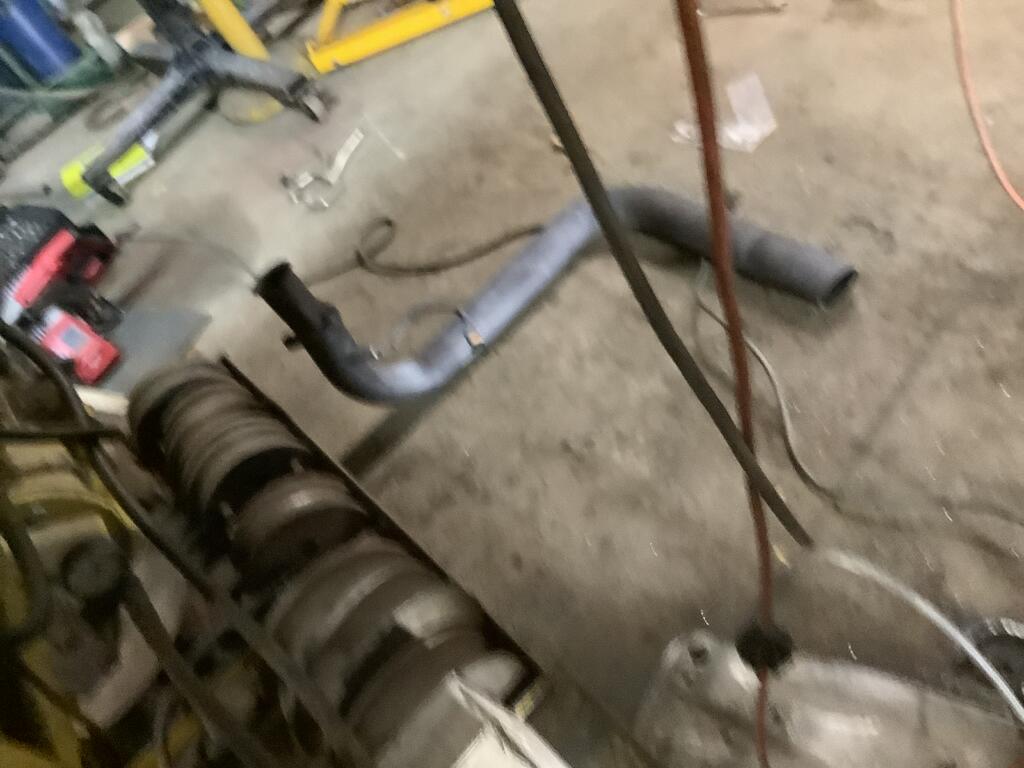

Check that front end out!  :banana-linedance:It’s sitting on the front tires and still on the lift on the rear.  Time to get the rear springs swapped out, then lift blocks!  I need to re-route the driver’s side exhaust down pipe to hook up the front driveshaft.
  • Excellent 3
It’s on 4 tires!  Now, the exhaust crossover and driveshaft are trying to take the same real estate.  Time to play with another “kind if inherited” shop tool.

Very handy having a set of tubing benders. B)
