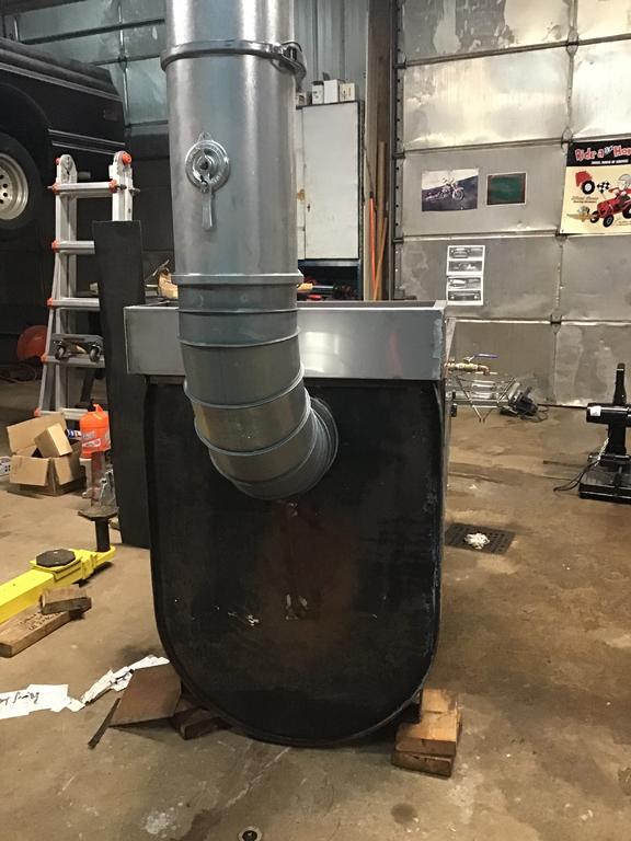

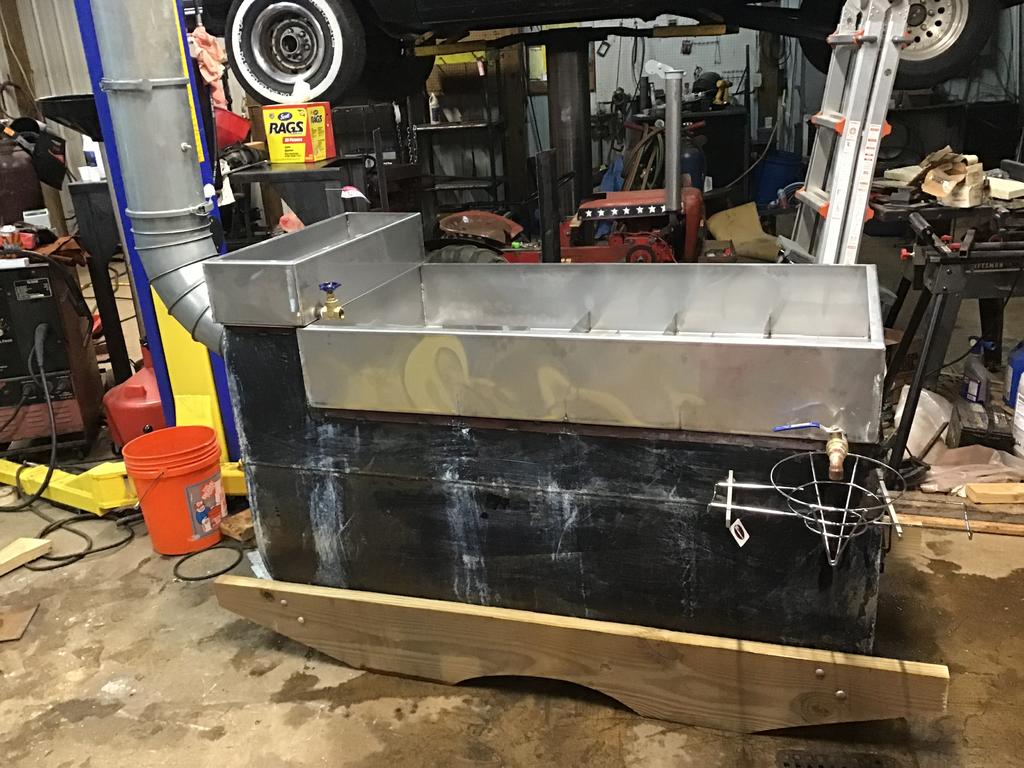

The Fire itself just shall burn under the Pan, or did you conducting the exhaust?
i'm asking because so you can conduct the exhaust with a structure of ribs maybe...
Edited by Tractorhead

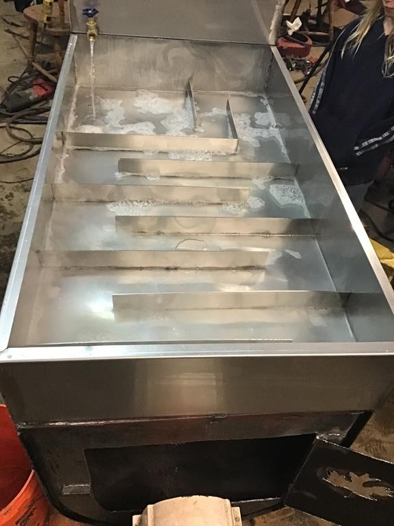

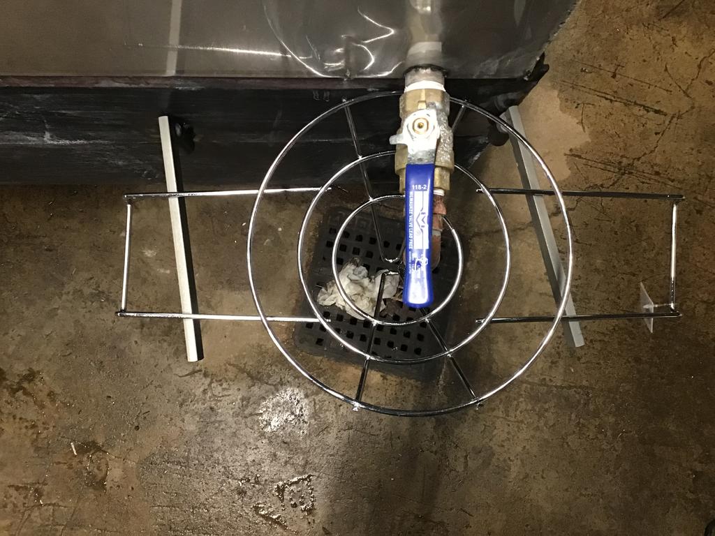

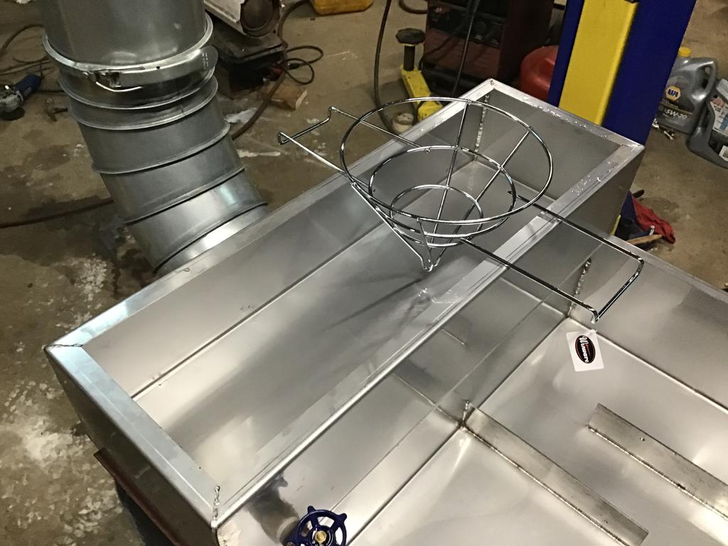

The fire will be directly under the pan.  This game is all about heat transfer, we are boiling 39 gallons of water out of 40 gallons of sap to produce 1 gallon of syrup..

No worries, I don’t think it will take more or less... mainly even heat.  We are essentially keeping a simmer (just below boiling) and the whole pan will be steam rising.

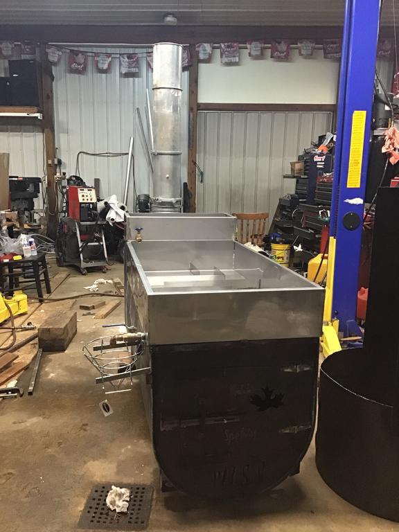

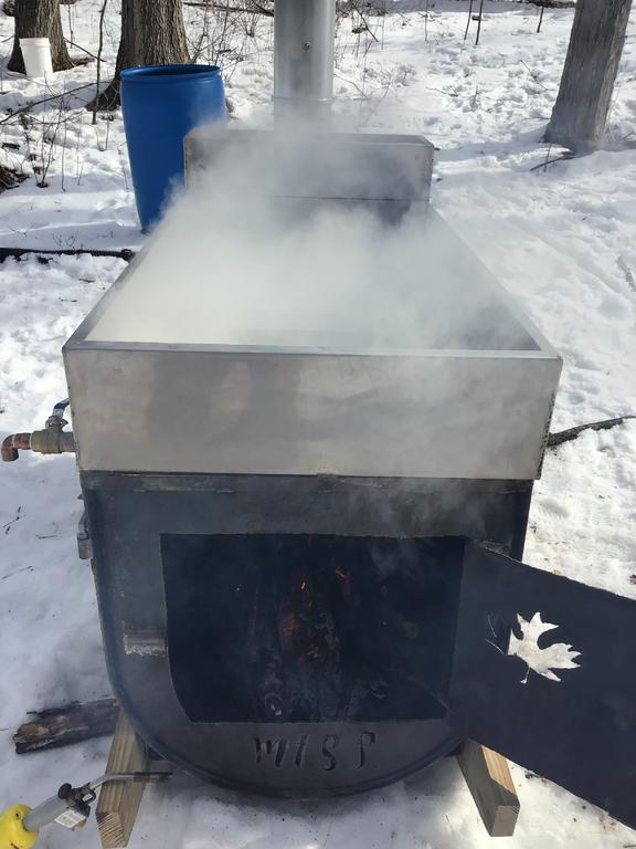

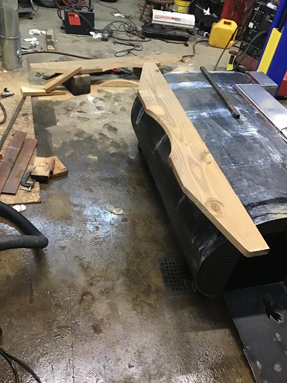

It’s ready, shy of some skis to get out to the spot we’ll process at!

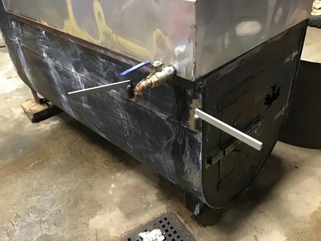

A couple finishing touches, just needs one more thing (other than fire and sap!).  Skis are tonight’s project, tomorrow is a test run on site with water to burn off any fuel oil residue inside the tank.

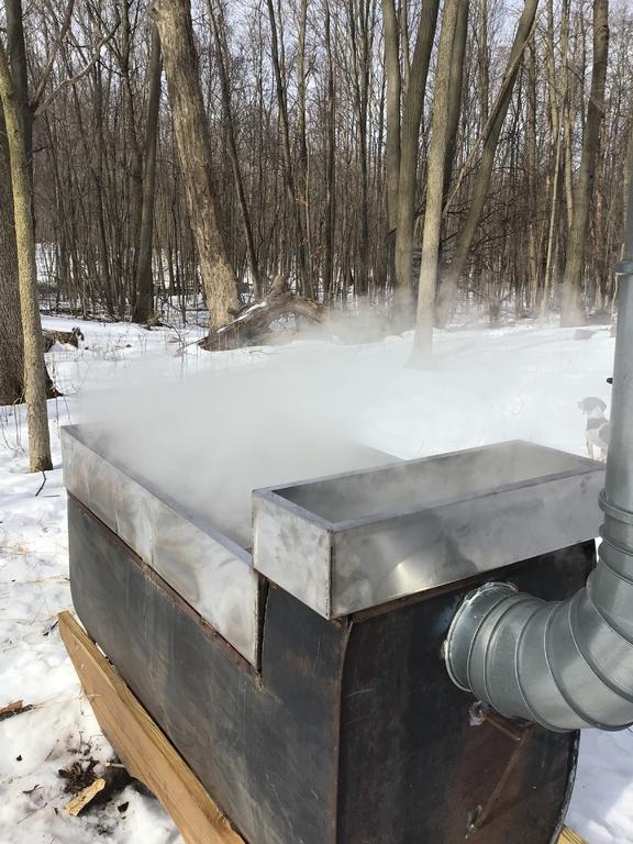

It’s finished!
The water test run is proving to do what it should today, but my helper passed out chopping wood!

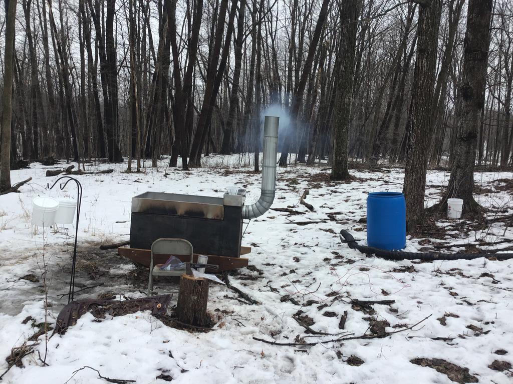

Here we are, first syrup making day!  We have 80-100 gallons of sap to run through today.
