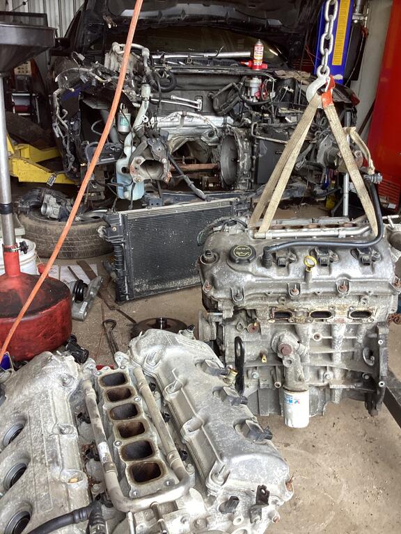

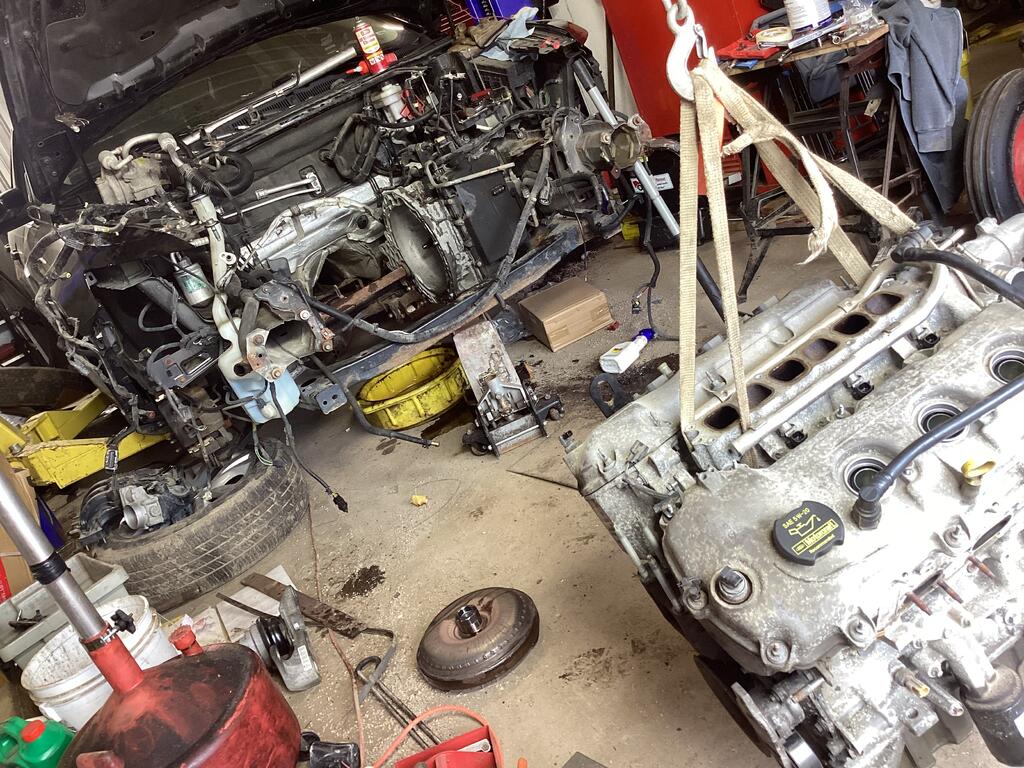

The torque converter pilot got seized up in the crankshaft.  Before I realized it, I had damaged the TC bearing.  I’ll replace that while I’m in there.
Good news, I got the engine, radiator, a/c condenser and fan I need for the car.  Bad news, the torque converter in the donor car hung up too, even though I tried so hard to keep it safe.
The local transmission supplier will get me a new TC soon, something like $160.  Not terrible, for peace of mind.
This’ll be a fun one!  I have about a month to get this running, driving, shifting into all gears, and charging.  There might be some other wiring snafus along the way, if I can get everything else caught up.

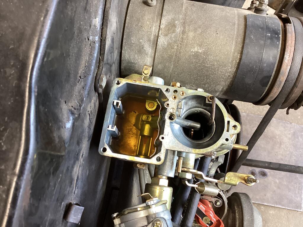

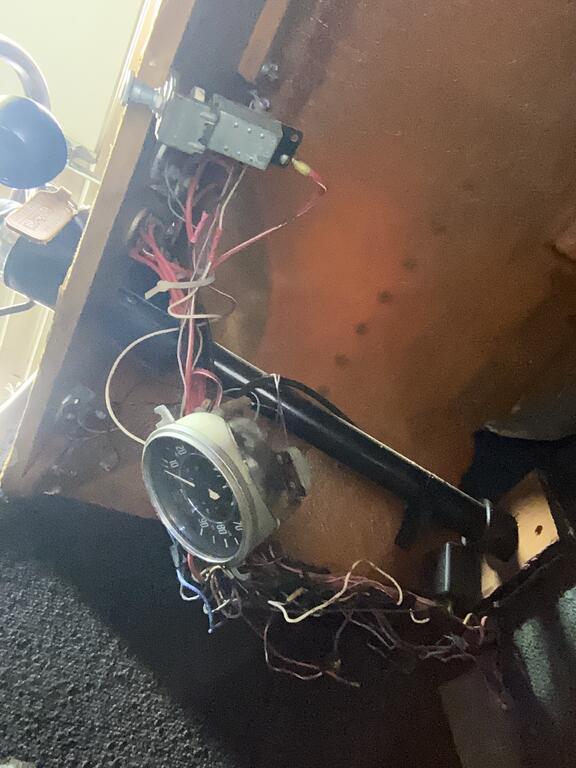

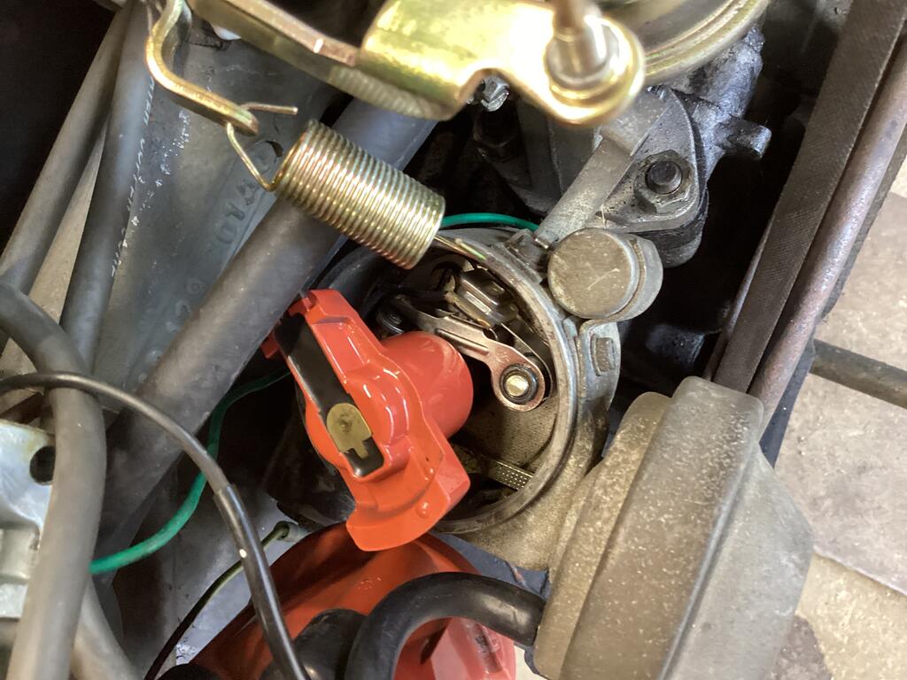

It doesn’t charge.  I don’t think there’s any exciter bulb for the generator.  It runs quite rough.  The filthy carb may have something to do with that.  I’ll also clean and adjust the points.

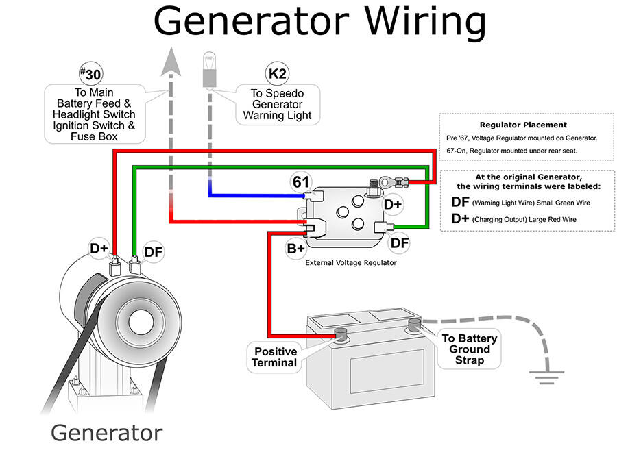

While the carb sits in the dip…. Wiring.  There is no generator light to excite the generator.  Without that, the entire charging field is kaput before we start.

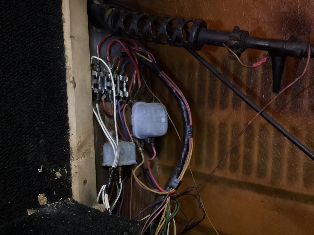

Now which wire is my wire I’m looking for?  :lol:

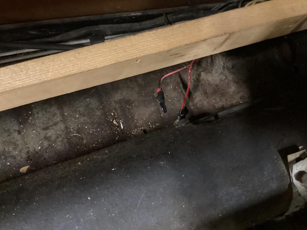

It might be time to step away for a bit.  It’s late and dark, and I’m finding things I don’t enjoy seeing… like live bare wires sitting in the pan.  Only saw one sparks before I tossed a bit of tape on them!  None of this worries me, but I think I need a fresh head to dive in.
  • Sad 1

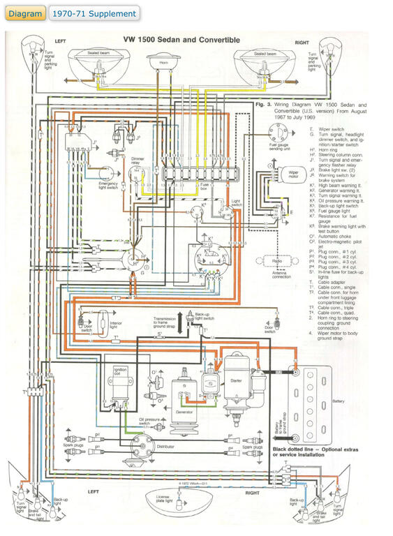

Though I feel like the entire wiring harness needs cleaning, I am going to attack the charging circuit alone.  Afterwards, I’ll clean it up a bit at a time. I found a separate wiring diagram to simplify things.

The funny thing here, is he has had this about 40 years he said.  He said he just keeps the battery on a charger for his cruising on occasion.  I am pretty sure the generator wire is simply missing / not hooked up to the regulator.  The light is not in the gauge cluster like it should be.  I’ll see about finding a generic red light to install under the dash to have all the components make it work proper, then troubleshoot.
Use a square hood genny lamp.       Cole-Hersee  PL 20 RC
Edited by squonk
The parts store didn’t have that available, but they had a clear license plate lamp and some red paint!
Parts stores only want to stock and sell stuff that their high volume repair shops use and what the "baloney muffler"  crowd want. Lots of places on the net to get Cole Hersee items
