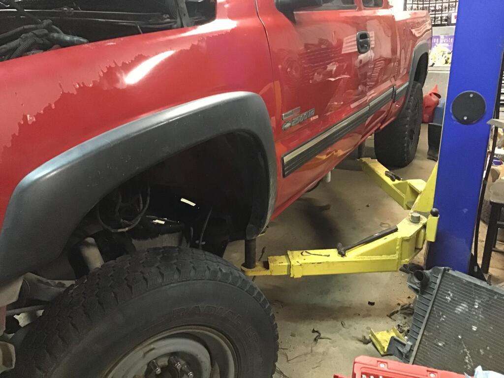

Cab’s off!
No wonder the transmission went out, there was no fluid in it!
  • Confused 1

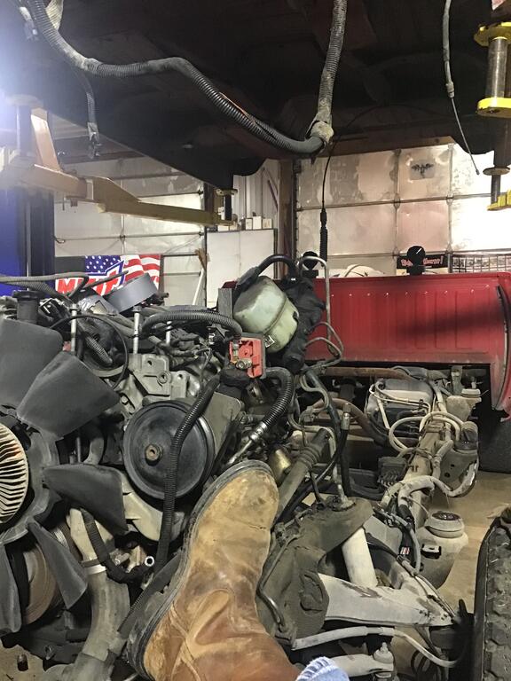

No flip flops? is summer over?
  • Haha 4
Either kevin fell down and his feet are up in the air while taking the picture or he is kicking back and relaxing!          :soapbox:  No goofing off, get back to work! ! !
  • Haha 4
I was in my step stool / chair admiring my work Richard :hide:  They’re ain’t no rest for the wicked, I’ll get back to work!  :orcs-whip:

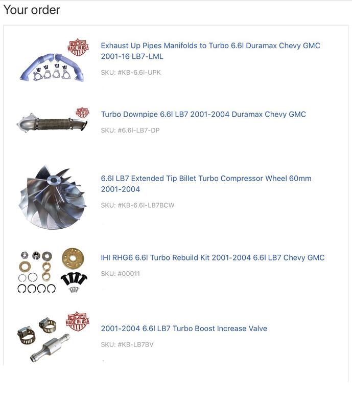

I took a moment to think about a few “while I’m in there” PM items.  The stock GM up pipes from the exhaust manifolds to the turbo Y pipe are known to stress and crack under a constant load (like pulling 12,000 lbs for 4-5 hours straight) so I have ordered new stainless steel heavier gauge pipes with stronger bellows.  For the value of doing it now, I ordered a turbocharger rebuild kit along with an upgraded compressor wheel to move a little more air, reducing exhaust gas temperature overall.  Heat kills theses things, and for the purpose of reducing temps, the money was well worth it as far as PM goes.  Additionally, I tossed a 3” down pipe in the order too.  It’ll help get rid of spent exhaust gas quicker, yet again reducing the EGT’s considerably.  Along with swapping the AirDog lift pump from the donor vehicle, I believe Norman will thank me as soon as we hook up to the trailer!  I miss you, buddy!
  • Heart 2
Here is the list of items too.  The boost increase valve will allow a little more air (6-7 psi) without over speeding the turbo, still within a safe parameter.  As a baseline, it is safe to assume that every time you add another barometric pressure (14-ish psi or 1 bar) you effectively double the HP capacity of the engine.  6-7 psi doesn’t sound like much, but I feel like the addition of the air moving abilities added to the engine, it’ll be a total game changer! Stock measures are 300 hp and 520 lb-ft of torque.  If I hit 375/600 or more, it’ll be a big difference and I feel like the extra fuel volume and more air will be make that a fair target!

Maybe a bigger Oilcooler for Engineoil path will also be an helpful gadget to keep the temps down.
