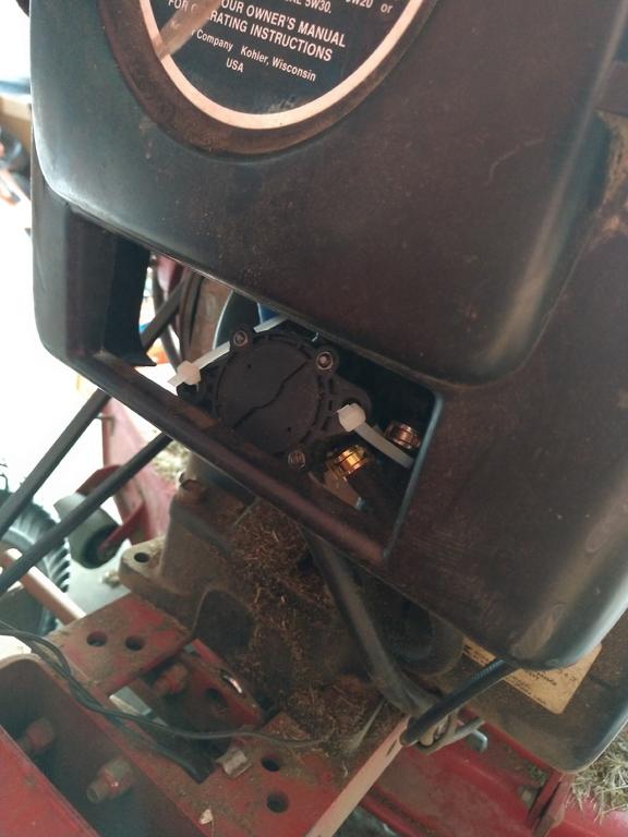

wildfire305 59 #15 Posted July 18, 2018 I had fuel issues after some water got in the tank. The cap was bad and it sat out in the rain for a day. The fuel pump died a few hours of use after I got all the water out of the system. Bought a new cap and also Bought new replacement pump - not impressed with the pump. Didn't run right at all. It turned out that the arm was 1/4" shorter and only engaged the diaphragm half way through the stroke. I got a refund for it and decided to use my noodle. I gutted the brand new pump of all the mechanisms, cut the metal disc out of the diaphragm, capped the outlet to the carb and basically created a Crankcase pulse adapter out of the pump. Then I installed a mikuni style plastic pump zip tied on the old one with the pulse port hooked up to my "adapter". The air cover hides all of it and it has been very reliable for 20 hours now. It also only cost me $10. I had previously replaced the fuel lines. Share this post Link to post Share on other sites
wildfire305 59 #16 Posted July 18, 2018 (edited) After doing all of this, I found out that Taryl Dactal has a YouTube video showing the same thing. Apparently, the replacement Kohler fuel pumps (even genuine) are not exactly reliable nowadays. The mikuni style is used on everything from quads, generators, dirt bikes, zero turns, etc. And doesn't require electricity. It also won't be dumping fuel if your engine dies and your not within arms reach to shut off the key. Edited July 19, 2018 by wildfire305 Spelling Share this post Link to post Share on other sites
