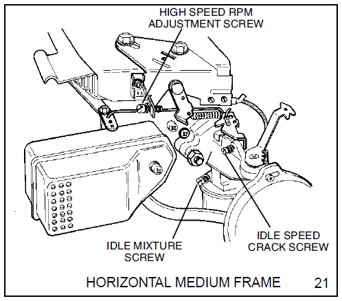

mpoore 34 #1 Posted July 9, 2018 I need some help with the governor linkage on a Techumseh H60 in a Lawn Ranger L-105. I bought a L-105 that had the governor bypassed so that the throttle was directly connected to the carb. The engine manual shows numerous governor setups of which the one below was the closest (muffler is obviously different). The problem is that the linkage is missing. It should not be hard to make a linkage, but I have to assume the correct length is important. Could anyone confirm the image below is the correct setup and tell me the length of the linkage? A bonus would be knowing the type of spring used between the carb and the throttle cable lever. Short of the exact info, is there a way to ballpark these? For instance, would the linkage be the length from the governor fully engaged and the throttle fully closed? Lastly, will any steel rod of the correct diameter work or do I need spring steel? Share this post Link to post Share on other sites
Wild Bill in VA 1,596 #2 Posted July 9, 2018 OK this ain't gonna be easy but first off the small linkage arm that is shown on top of the muffler that has a 5/16 hex head bolt with screw driver slot is also adjustable. So you can have some wiggle room for mistakes. Do you know if the plastic governor drive gear is still in one piece ? They have a habit of breaking when the throttle cable is hooked directly up to the carburetor throttle shaft. You will have to pull the side cover off to find this out. There also several hole in the throttle arm to hook the link up to. I will take a look during the day light to see if I can get a length on the rod for you. Wild Bill in Richmond, VA Share this post Link to post Share on other sites
wallfish 20,733 #3 Posted July 9, 2018 (edited) Exact length of the rod is not critical because there is adjustment there. If you have an old throttle or choke cable around, use that wire to make one. Best to size it in the full open positions instead of closed. Nevermind, looks like Bill will fix you up with a measurement The Spring and the tension from it is more critical as that needs to counteract the the pressure from the governor arm, which is always trying to close the butterfly on the carb. In the past, I've just bought a bunch of small springs that seem to close to the size and different tensions and try them until one works. Probably not the best way but works for me. They're cheap enough. If the engine runs you can test that gov gear by holding the gov arm as you increase RPMs. You should feel it pushing towards the carb if it's working. Just be careful the carb doesn't open to full throttle so use your third hand if necessary. I'll see if I have a spring. have a couple of old h70s out there from snowblowers. spring tension should be about the same, I think. Edited July 9, 2018 by wallfish Share this post Link to post Share on other sites

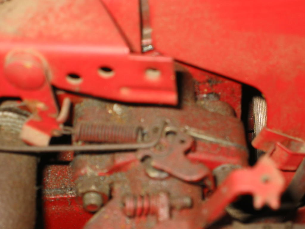

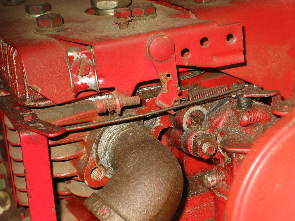

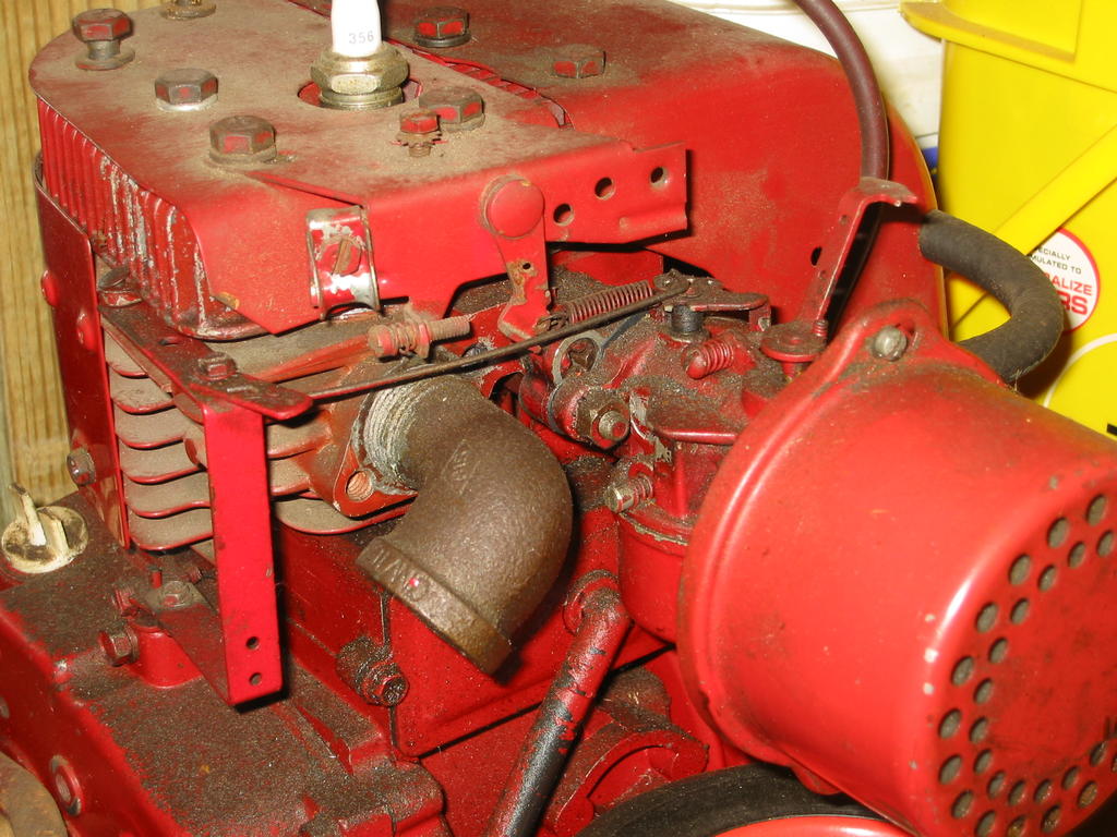

pfrederi 21,300 #7 Posted July 9, 2018 From the original engine on my L107. The rod is 3-7/8" 1 Share this post Link to post Share on other sites
