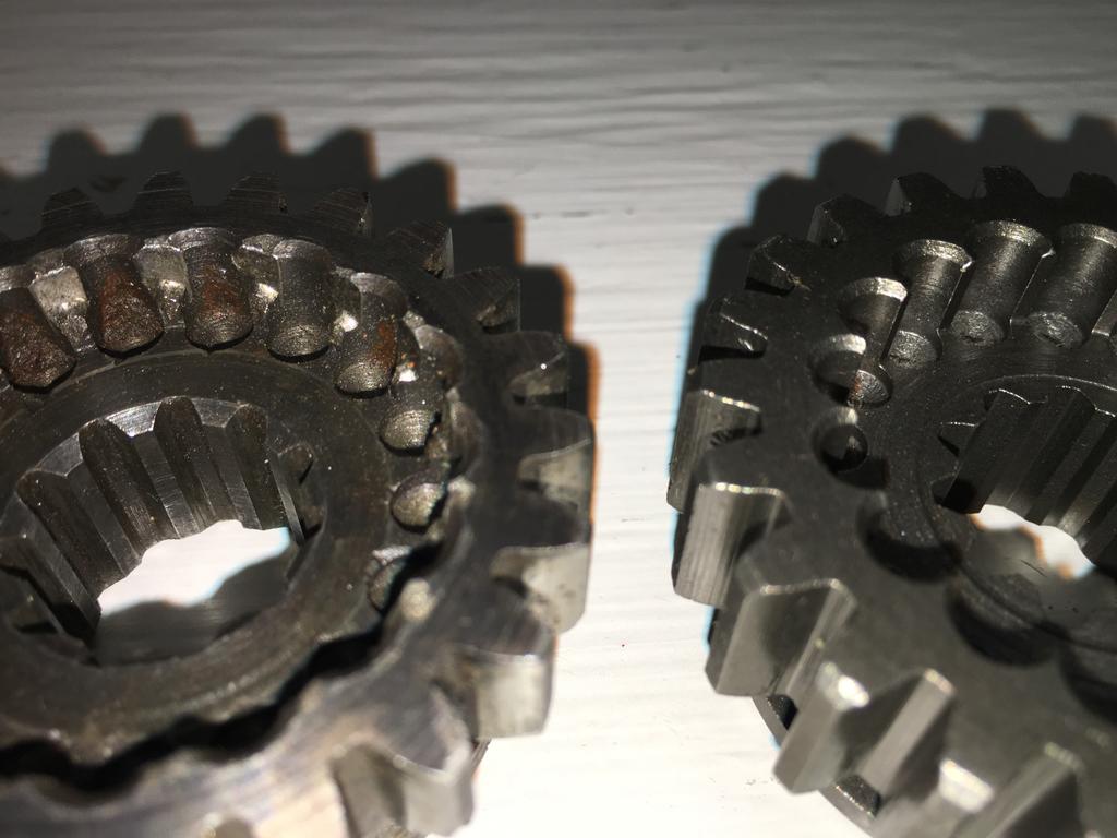

WHNJ701 4,164 #1 Posted July 8, 2018 (edited) I had this in the shop found this trans a few years ago, it didn't shift, shift forks were rusted, and no oil in it. I got bored took it all apart, before I go and order all the new needle bearings could someone decide if these gears are still ok to use? they still mesh somewhat ok, all the other gears are seem fine. Edited July 8, 2018 by jabelman Share this post Link to post Share on other sites
WHNJ701 4,164 #2 Posted July 8, 2018 it's the input shaft gear and the 2nd/high gear Share this post Link to post Share on other sites
wheelhorseman 3,197 #3 Posted July 8, 2018 Here is a picture of a bad gear and new gear side by side yours is wore if you put it back together like that it will pop out of 3rd gear while driving. 2 Share this post Link to post Share on other sites
WHNJ701 4,164 #4 Posted July 8, 2018 thanks that kinda what I thought, what do you think of the input gear, is it supposed to be beveled. so the big question is that 2nd/high gear available or is not even worth rebuilding? Share this post Link to post Share on other sites
wheelhorseman 3,197 #5 Posted July 8, 2018 Yes they are available here is the link to them, look through the pictures you’ll see other pictures of the gears and You will see pictures of the input shaft. https://www.wheelhorsepartsandmore.com/transmissions.html#!/3523-3rd-gear/p/84932562/category=23548039 1 Share this post Link to post Share on other sites
