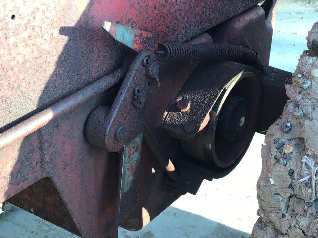

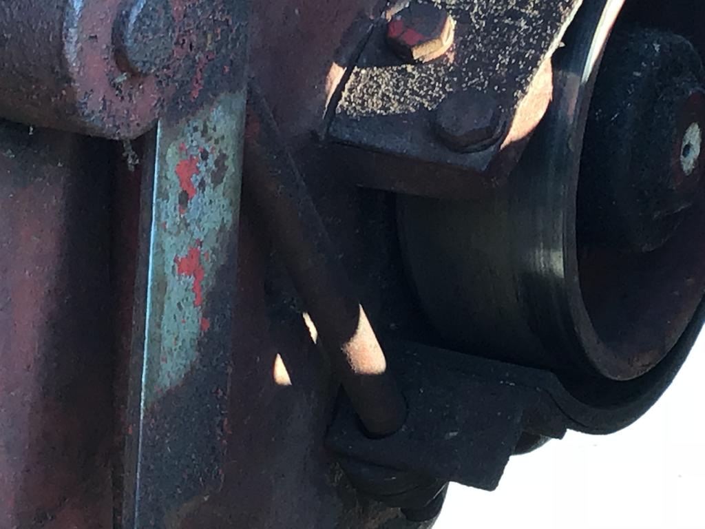

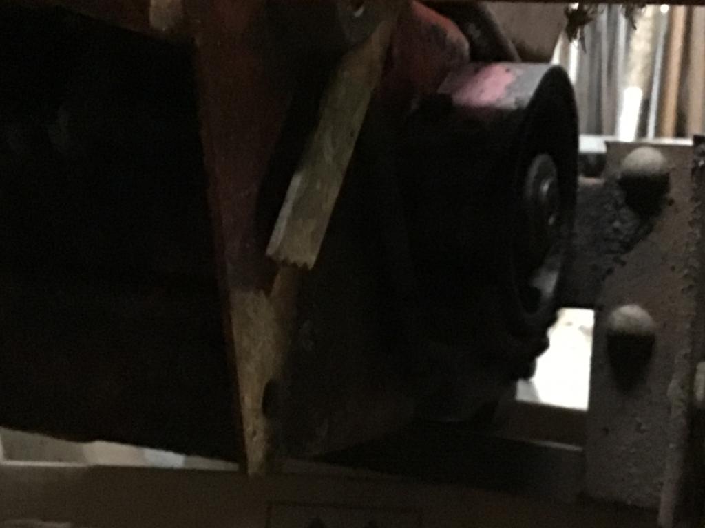

Pullstart 71,482 #3 Posted July 5, 2018 These are from a Commando 800... I’ll check the 857 and 656 too for comparison. Share this post Link to post Share on other sites

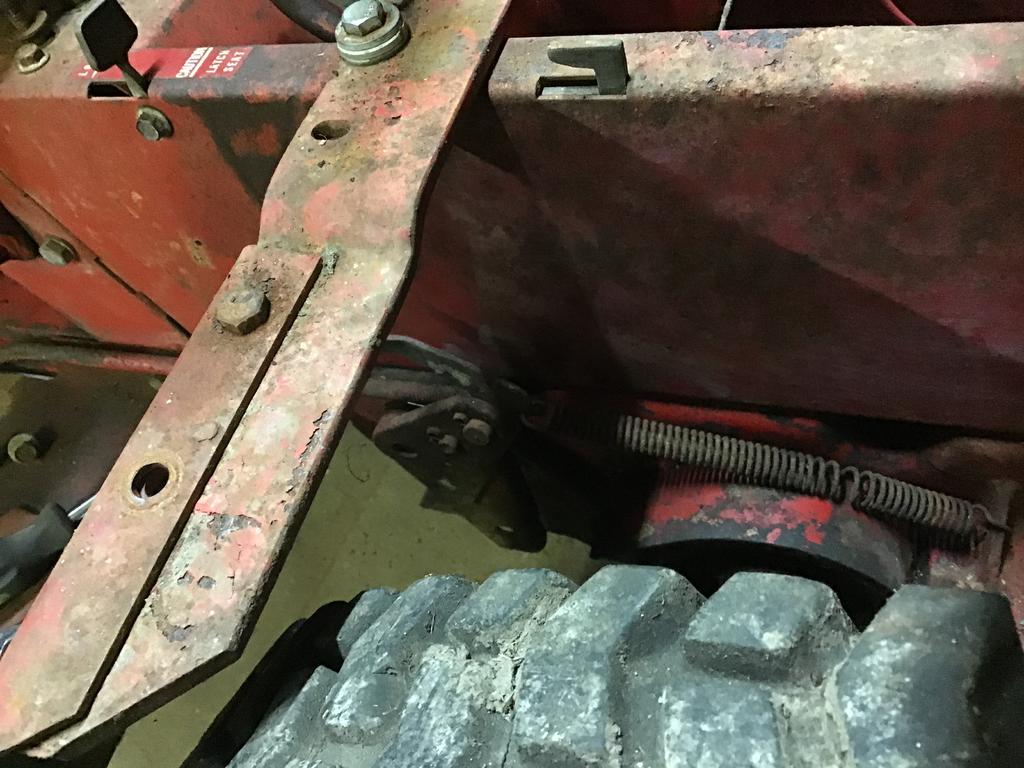

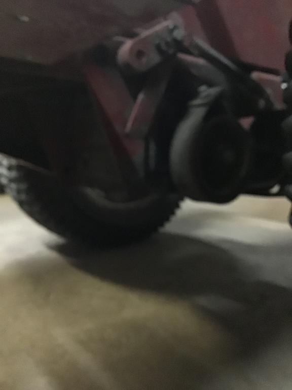

Pullstart 71,482 #4 Posted July 5, 2018 These are the 857, the brake band is upside down from the commando. Share this post Link to post Share on other sites

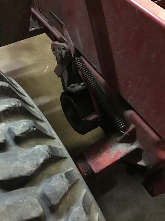

Pullstart 71,482 #5 Posted July 5, 2018 And the 656 with better lighting. 1 Share this post Link to post Share on other sites
The Tuul Crib 7,354 #6 Posted July 5, 2018 Thanks brother these are real helpful!! Made my day easier for sure. Next time I will take better pics.😳 Share this post Link to post Share on other sites
Pullstart 71,482 #7 Posted July 6, 2018 7 hours ago, The Tool Crib said: Thanks brother these are real helpful!! Made my day easier for sure. Next time I will take better pics.😳 Not a problem... take more pics even if it’s just for us! Share this post Link to post Share on other sites

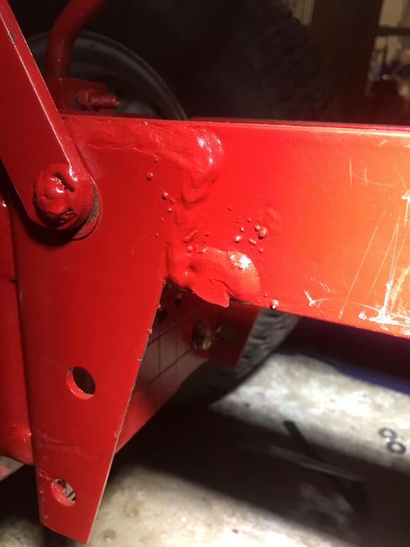

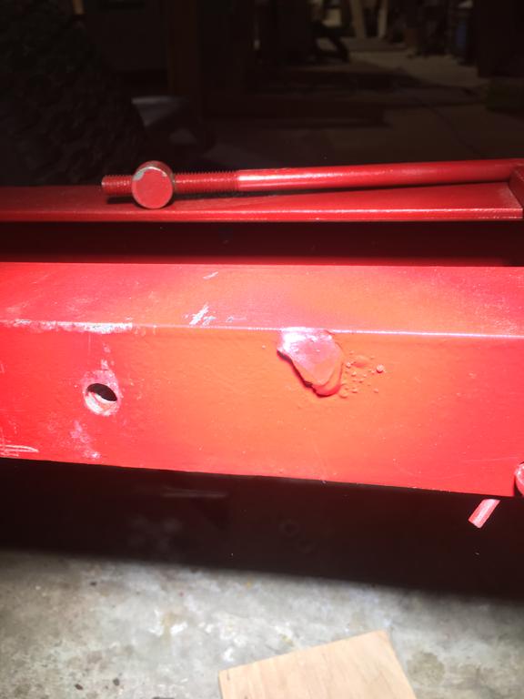

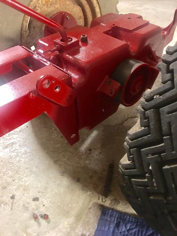

The Tuul Crib 7,354 #8 Posted July 6, 2018 Hey I have another question for you I'm trying to put the cover on for the drive belt and I think I'm missing a couple of brackets on the frame of the tractor that holds the cover on. Do you by chance have a pic of this? I think mine where broken off. Share this post Link to post Share on other sites
Pullstart 71,482 #9 Posted July 12, 2018 Sorry for missing the question... I think those welded parts on the frame are factory, a few people have asked about those in the past. You should have a tab that bolts to the engine, a screw just behind the hood stand by the shifter, one at the back of the belt guard and the hole through the frame has a 1” or so spacer between the guard and the frame. Share this post Link to post Share on other sites
