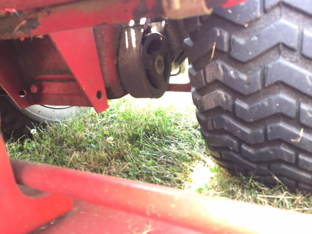

Volant1006 42 #1 Posted July 3, 2018 Well I feel like a dumb ass. Just picked up a 312-8 last week. Mowed the yard for the 1st time and everything was great! Hopped on it yesterday to move the tractor around my house from my shed to the garage. The clutch was making a squealing noise and something wasn't right. All of the sudden smoke started coming up from under the seat and I smelled burning. Shut the tractor down. Looked under the seat, smoke was coming from the wheel in the picture. Drove it around to the front, smoking again. Looked in the manual, found out this was the drum brake. Yep my dumb as had the parking break ON! Full disclosure this was only the 2nd time I was on the tractor but that's no excuse. The dash board lights don't work but I probably wouldn't have seen them anyways. My question is, what kinda damage was done. The brakes still work, but you have to press the pedal to the floor and they feel kinda weak. Haven't tried them yet on a hill. Hopefully I didn't ruin the poor thing. Leave it up to me, tractor's been around for 30 years. I get it for a week and try to burn the brakes out of it. I came across basically a brake pad (drum) on ebay (see pic). But it says you basically just use silicon glue to install? Has anyone done this before? Could I adjust the brake to make it tighter? Would I need a new brake drum? 1 1 Share this post Link to post Share on other sites
ebinmaine 78,453 #2 Posted July 3, 2018 I'm just going to go ahead and admit that I've done the same thing but on a manual transmission. 1974 b80. Smelled hot and nasty. Same as you. Wore out the shoe Some. As far as buying a new one, get a hold of Bob Maynard. One of our redsquare vendors. He sells them. 2 Share this post Link to post Share on other sites
SPINJIM 1,997 #3 Posted July 3, 2018 If there is still enough of the pad left on the shoe, you might be okay if you adjust the length of the connecting rod for the brake pedal. There aren't any rivets holding the pad on like there are on car brake pads. If it burned down to the metal, get one from Bod as Eric suggested. And don't be embarrassed, we've all done it, and I've done it more than once. Jim Share this post Link to post Share on other sites
953 nut 65,513 #4 Posted July 3, 2018 Bob is the Ebay vendor you have copied in your post, but he sells them for less to members here. Have you checked your drive belt to see if it suffered any damage? 2 Share this post Link to post Share on other sites

PeacemakerJack 10,945 #7 Posted July 4, 2018 Wish I could say with all the seat time that I have on various motor vehicles that i’d Never done that—but I can’t! When I first bought GhostRider (314-8), several times at various plow days, I’d lock my parking brake and leave the tractor. A little while later come back to it and decide to plow a few rounds. I’d be 150’ down a furrow when I’d smell the smoke. At first I would think I was working the tractor so hard that the drive belt was smoking—NOPE! Just an idiot driving his machine with the parking brake on—nothing to see hereI haven’t replaced my brake band yet and what I have is still functional. See how yours works with a little adjustment. If you don’t like the results, contact Bob! You have a great little tractor that should serve you well for years to come Share this post Link to post Share on other sites

Tractor boy 239 #9 Posted July 9, 2018 Did that on my 312, on the second time driving it also. Thankfully there was pad left so all I had to do was tighten the linkage a tad and the parking brake was better than before! -Tractorboy Share this post Link to post Share on other sites

Burnerman 759 #16 Posted August 24, 2019 To adjust the brake set the parking brake on the first or 2nd detent and then tighten the brake rod nut so the band is gripping the drum tight. I wore out mine by leaving it on. I used a thick piece of leather as a brake band for awhile. I Share this post Link to post Share on other sites
