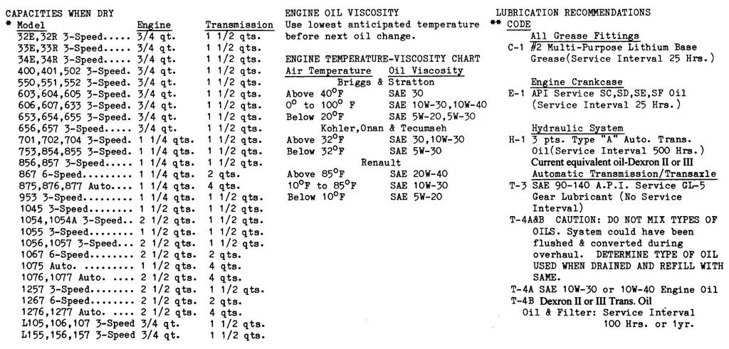

Wild Bill in VA 1,550 #6 Posted July 3, 2018 Try to get 85w-140 weight gear oil and install 1-1/2 quarts through the gear stick opening. The factory original amount was 1 quart but this found not to be enough when operating on the slant of hills. The thick gear oil also helps take up some up some of the slack from worn gears. Wild Bill in Richmond, VA 1 Share this post Link to post Share on other sites
Racinbob 12,996 #7 Posted July 3, 2018 The 3 and 4 speeds specified 1 1/2 quarts, the 6 and 8 speeds 2 quarts. Anywhere in that range will be fine as well as using the pipe plug on the right side as the manual states. I have used 80w90 in all mine for decades with no issues at all. 1 Share this post Link to post Share on other sites
