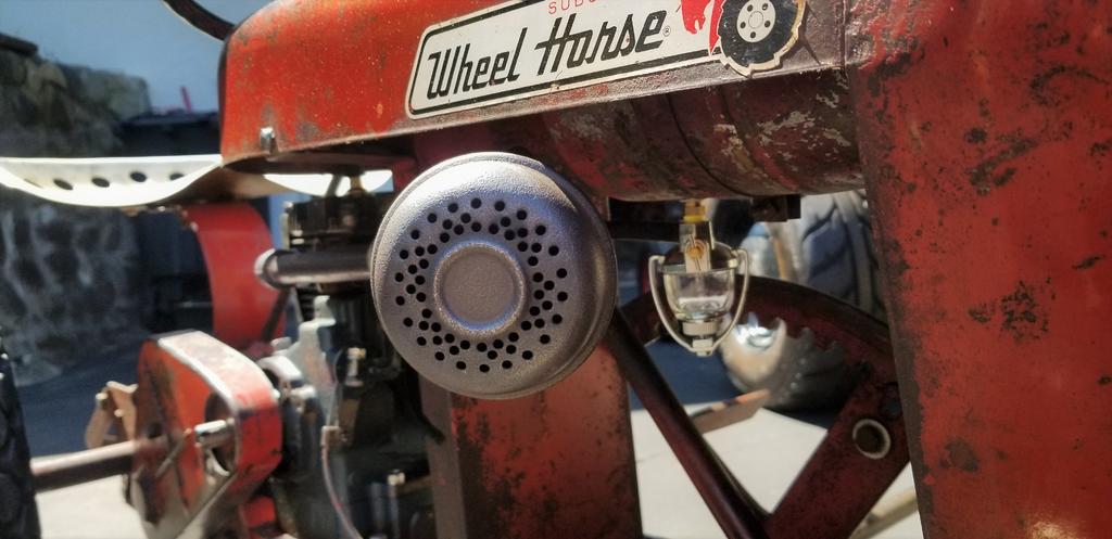

Blackie 0 #1 Posted July 2, 2018 I recently acquired a 1958 RJ 58 and need to replace the cork gasket on the glass has bowl. I need help determining the size of gasket I need to replace the old one as it has withered away to next to nothing. Share this post Link to post Share on other sites
rmaynard 17,589 #2 Posted July 2, 2018 The RJ used a sediment bowl assembly, part #1786. This is a common item and is still available under various manufacturers part numbers. I used the Briggs & Stratton 690612 on my 701. Unless you are trying to keep the RJ totally original, for $12.00 it's a lot simpler to replace the whole bowl assembly than find the correct cork gasket. 6 Share this post Link to post Share on other sites
pfrederi 21,184 #4 Posted July 2, 2018 Pick a small sheet of cork gasket material at the auto parts store and cut your own. Share this post Link to post Share on other sites
WHX?? 58,228 #5 Posted July 2, 2018 (edited) I just got a bunch of replacement rubber ones off ebay for the smaller 1/8 npt ones. https://www.ebay.com/sch/sis.html?_nkw=5+Sediment+Bowl+Gaskets+fits+Briggs+%26+Stratton++%23+692190+68477+kohler+210468S&_id=231992097877&&_trksid=p2057872.m2749.l2658 Edited July 2, 2018 by WHX20 Share this post Link to post Share on other sites
squonk 48,163 #6 Posted July 2, 2018 (edited) Napa sells the complete set up or all the individual pieces. There are 2 sizes of bowls. Just ask for the smaller one. "Sediment Bowl "is French for " Gas Leak" Edited July 2, 2018 by squonk 1 Share this post Link to post Share on other sites
