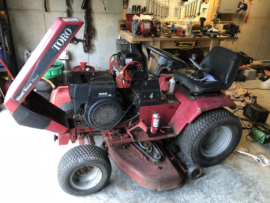

nnero 14 #6 Posted July 2, 2018 (edited) Haven’t had a chance to do anything but charge the battery. The seat safety switch has been disconnected. Here’s some pics... Edited July 2, 2018 by nnero 1 Share this post Link to post Share on other sites

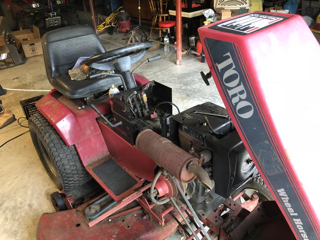

nnero 14 #8 Posted July 3, 2018 Starts on it’s own fine with a different battery and says it’s putting out 13.6v. Ampmeter and hour meter dont seem to be working. Definitely needs some carb work. I added some fresh gas with startron but couldn’t tell how much was in the tank. Also the deck only raises up on one side. Everything seems to be in place? Maybe things are just sticky? The deck needs some tlc as well 1 Share this post Link to post Share on other sites

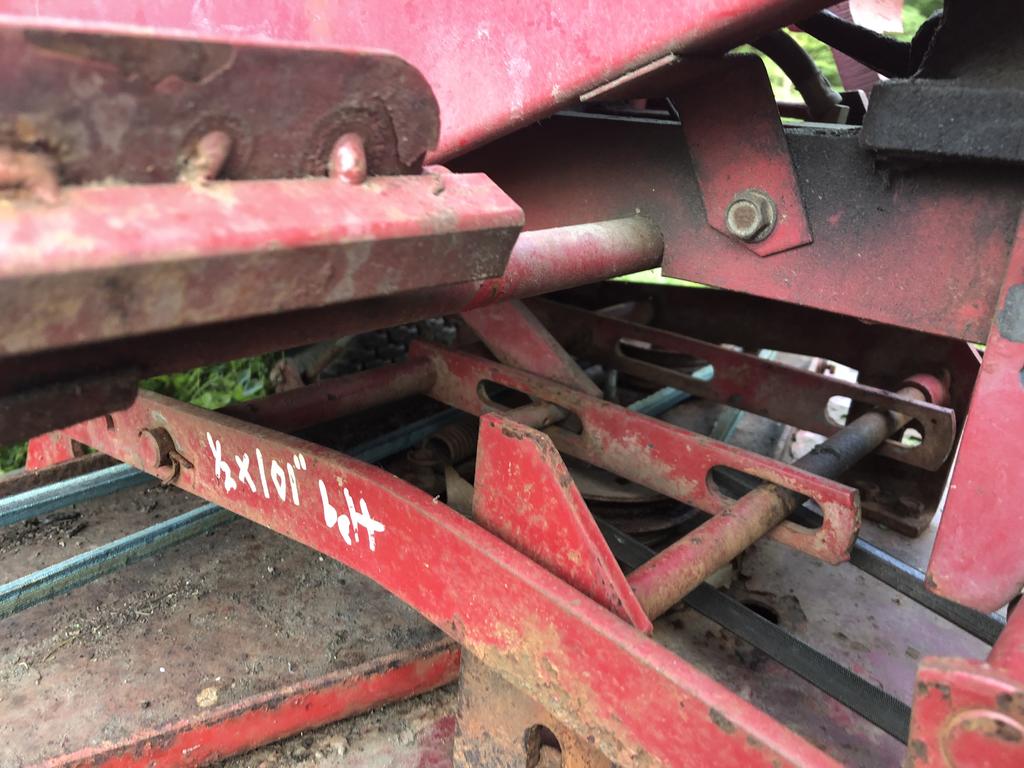

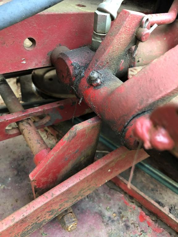

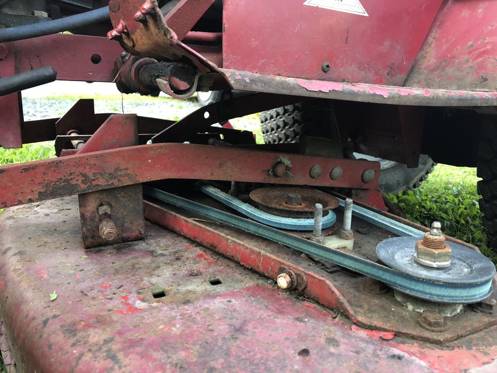

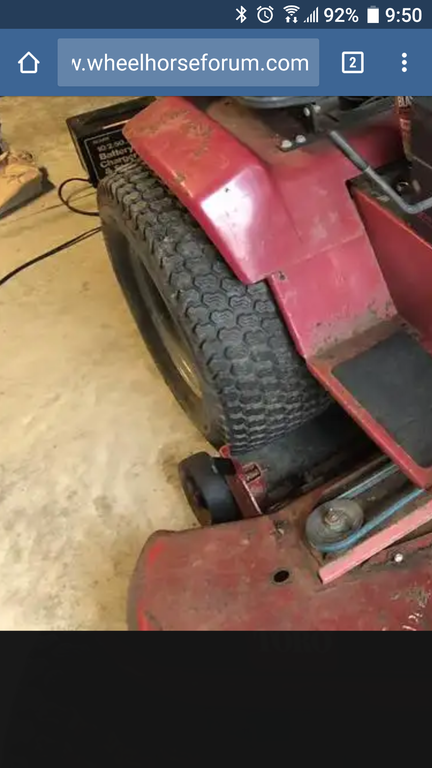

nnero 14 #9 Posted July 4, 2018 Just noticed that this bracket on the deck hits against the brake rod. This is the side that won’t raise properly. I know this deck isn’t original to this particular tractor. Is something bent or is there and issue with the compatibility of the deck and tractor? Sorry if these are dumb questions. I’ve only ever used my cub or an ingersoll. Thanks Share this post Link to post Share on other sites
WVHillbilly520H 10,378 #10 Posted July 4, 2018 12 minutes ago, nnero said: Just noticed that this bracket on the deck hits against the brake rod. This is the side that won’t raise properly. I know this deck isn’t original to this particular tractor. Is something bent or is there and issue with the compatibility of the deck and tractor? Sorry if these are dumb questions. I’ve only ever used my cub or an ingersoll. Thanks Should look more like this...i believe who ever changed the deck/lift linkage put it on backwards. 1 1 Share this post Link to post Share on other sites

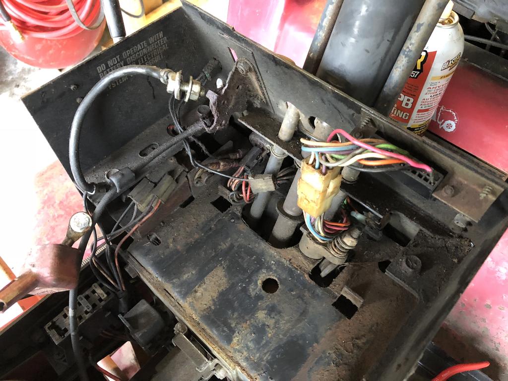

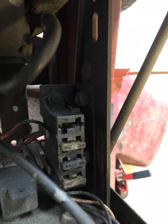

nnero 14 #11 Posted July 4, 2018 (edited) Doh! You are right! I need to pull the deck of anyways. Thanks! The fuse block has a contact missing for the fuse closest to the battery. So I should probably just replace the whole thing. Would this work? http://store.wheelhorsestables.com/index.php?route=product/product&product_id=94 The tires appear to be like new and the rears are loaded with washer fluid. Edited July 4, 2018 by nnero Spelling Share this post Link to post Share on other sites

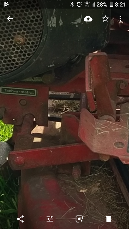

Tractor boy 239 #12 Posted July 4, 2018 Is it just me or is that belt partway off the pulley? Maybe it slipped off or my eyes are playing tricks on me. I would get some covers for those belts as say something fell in there or your leg went in there things could get very nasty very fast. I would check the connections on those gauges. -Tractorboy 1 Share this post Link to post Share on other sites
nnero 14 #13 Posted July 4, 2018 4 minutes ago, Tractor boy said: Is it just me or is that belt partway off the pulley? Maybe it slipped off or my eyes are playing tricks on me. I would get some covers for those belts as say something fell in there or your leg went in there things could get very nasty very fast. I would check the connections on those gauges. -Tractorboy It does look that doesn’t it? I haven’t ran the deck yet. Wasn’t going to until after I pull it out and check things over better. There’s no serial number on deck so I need to measure it for the width. Share this post Link to post Share on other sites
lynnmor 8,736 #14 Posted July 4, 2018 The fuse block probably never had the fourth fuse, check the wiring diagram. One source of a fuse block is here: Dorman 85668 1 1 Share this post Link to post Share on other sites
nnero 14 #15 Posted July 4, 2018 (edited) I worded that poorly haha. It’s one of the slots that has a fuse that’s messed up. That may actually be easier since i wouldn’t have to splice the wires an it’s cheaper. I never thought of rock auto. I have to order stuff from them anyways. I already found this link: Thanks Edited July 4, 2018 by nnero Share this post Link to post Share on other sites
WVHillbilly520H 10,378 #16 Posted July 4, 2018 11 hours ago, nnero said: It does look that doesn’t it? I haven’t ran the deck yet. Wasn’t going to until after I pull it out and check things over better. There’s no serial number on deck so I need to measure it for the width. See here in your pic, the gauge wheel height selector is on the right side which equals 42" side discharge while if it's on the left side it's a 48" side discharge, those 2 being the most common then there's rear discharge and a 60" side discharge for the 520s and C195, Jeff. 1 1 Share this post Link to post Share on other sites
nnero 14 #17 Posted July 6, 2018 Ok thanks that helps! I would like to eventually find a 48” deck. The current one definitely needs some tlc. Would this run a 48” deck ok? So the wiring diagram shows the 314 only having two fuses. Someone must have stuck one in an empty slot. I changed the 15 and now have lights and guages! I’ll still replace the fuse block. Need to clean/adjust carb then i should be able to run it for a while and change engine oil. I need to find the Kohler manual for carb adjustment. It’s not in the WH manual. Then I’ll clean/degrease everything I can. I also pulled the deck out so I can mess with it easier. Thanks! 1 Share this post Link to post Share on other sites

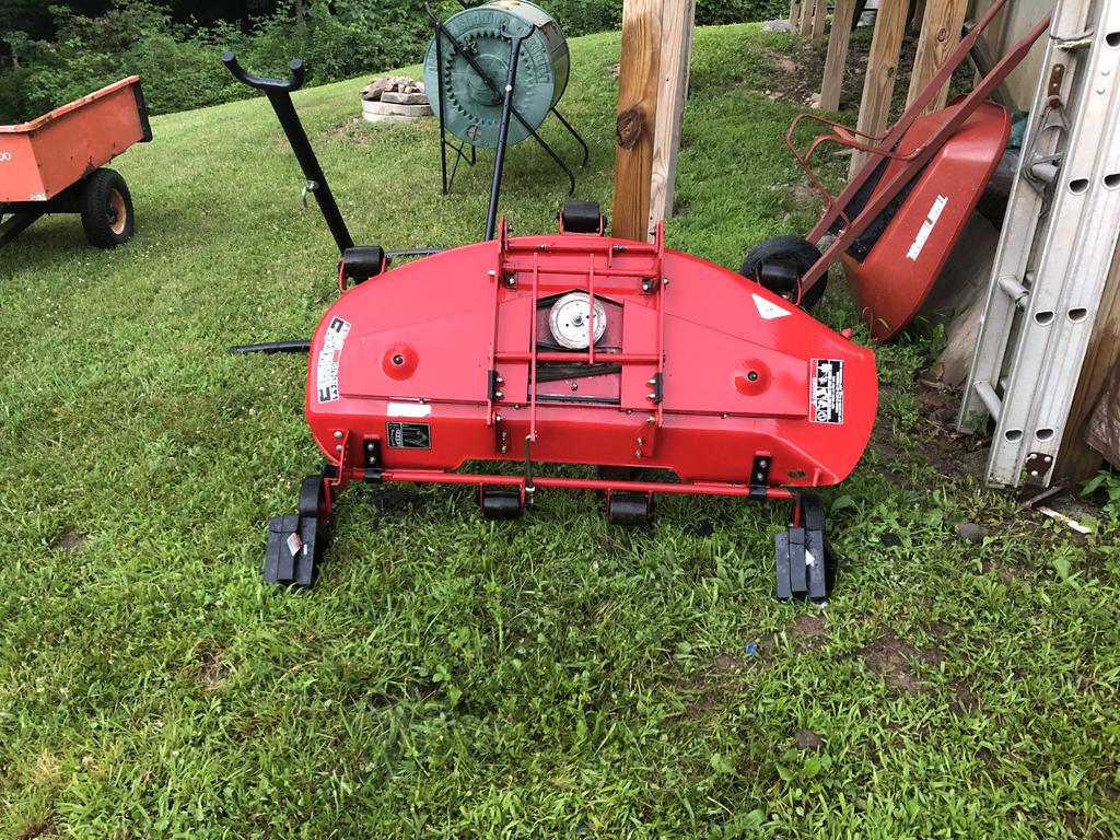

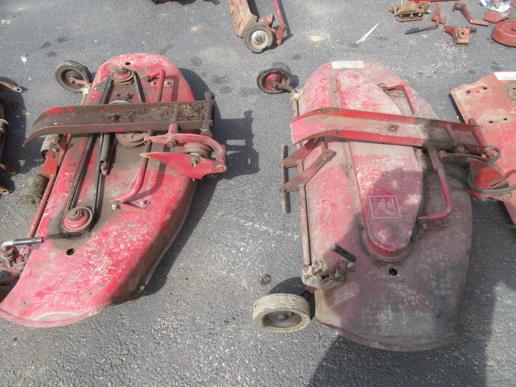

nnero 14 #24 Posted July 10, 2018 (edited) Gonna clean the carb and change engine oil. Got a used idiot light circuit board. It works but needs a little repair. Also picked up this nice 48” deck. It’ll be nice having a bigger deck and this one doesn’t need anything. First mowing should be this week hopefully! Edited July 10, 2018 by nnero 3 Share this post Link to post Share on other sites
Tractor boy 239 #25 Posted July 10, 2018 41 minutes ago, nnero said: Gonna clean the carb and change engine oil. Got a used idiot light circuit board. It works but needs a little repair. Also picked up this nice 48” deck. It’ll be nice having a bigger deck and this one doesn’t need anything. First mowing should be this week hopefully! That board must of cost you a pretty penny. Share this post Link to post Share on other sites
