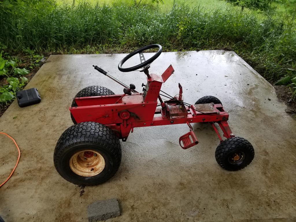

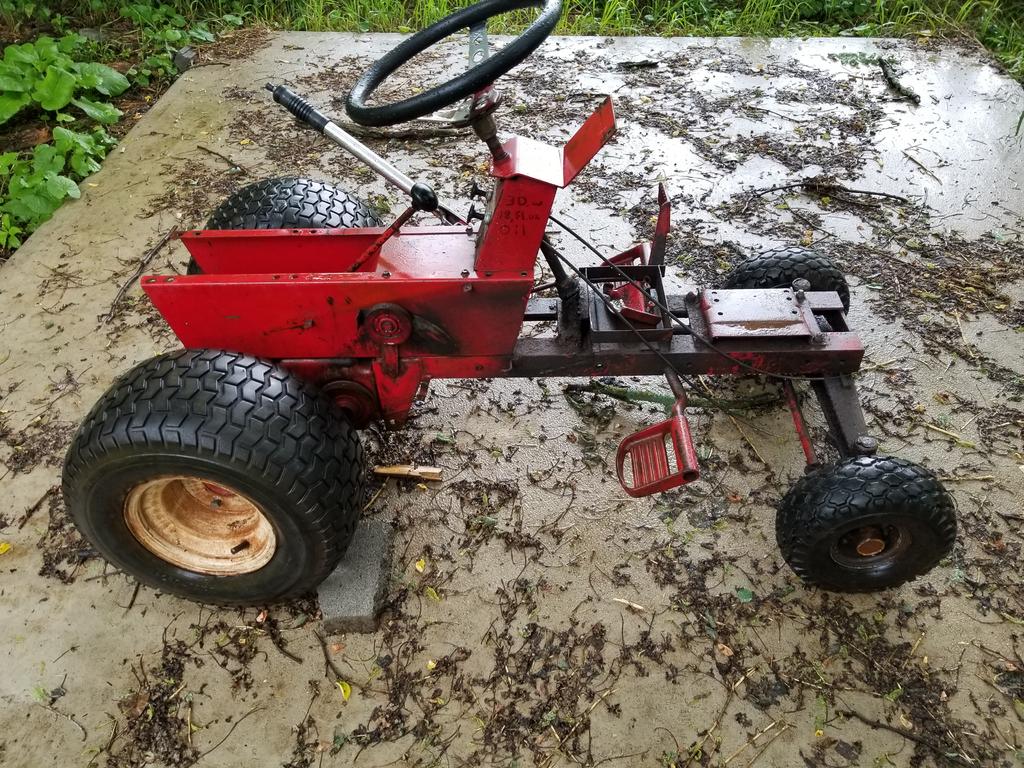

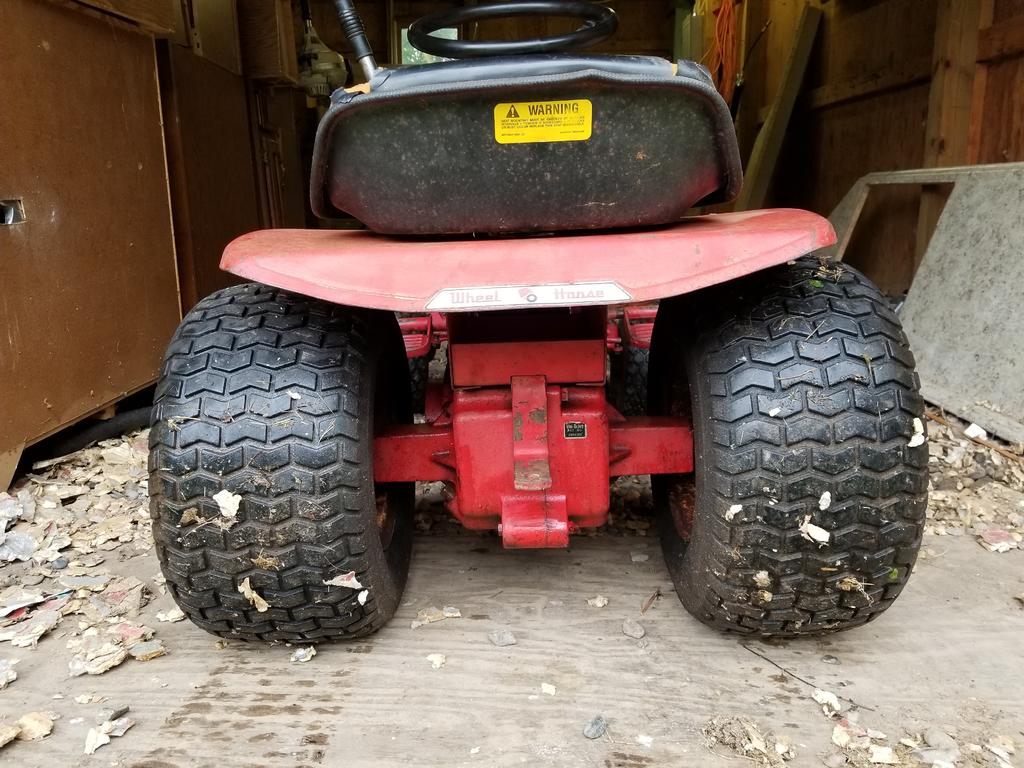

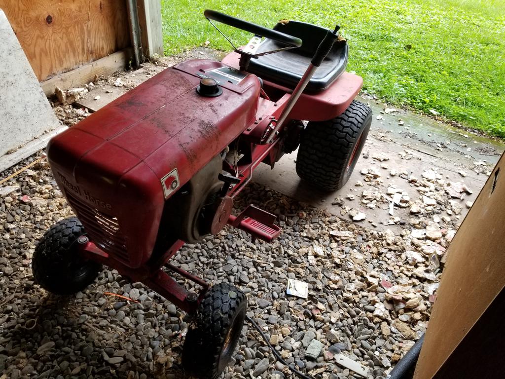

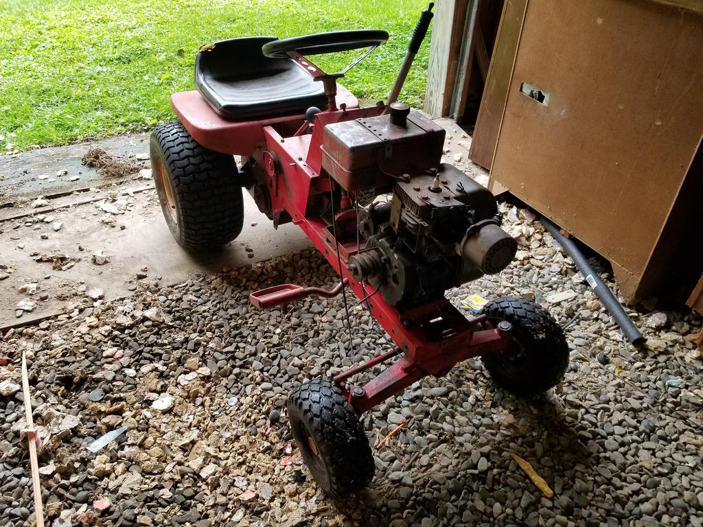

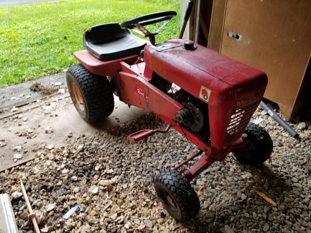

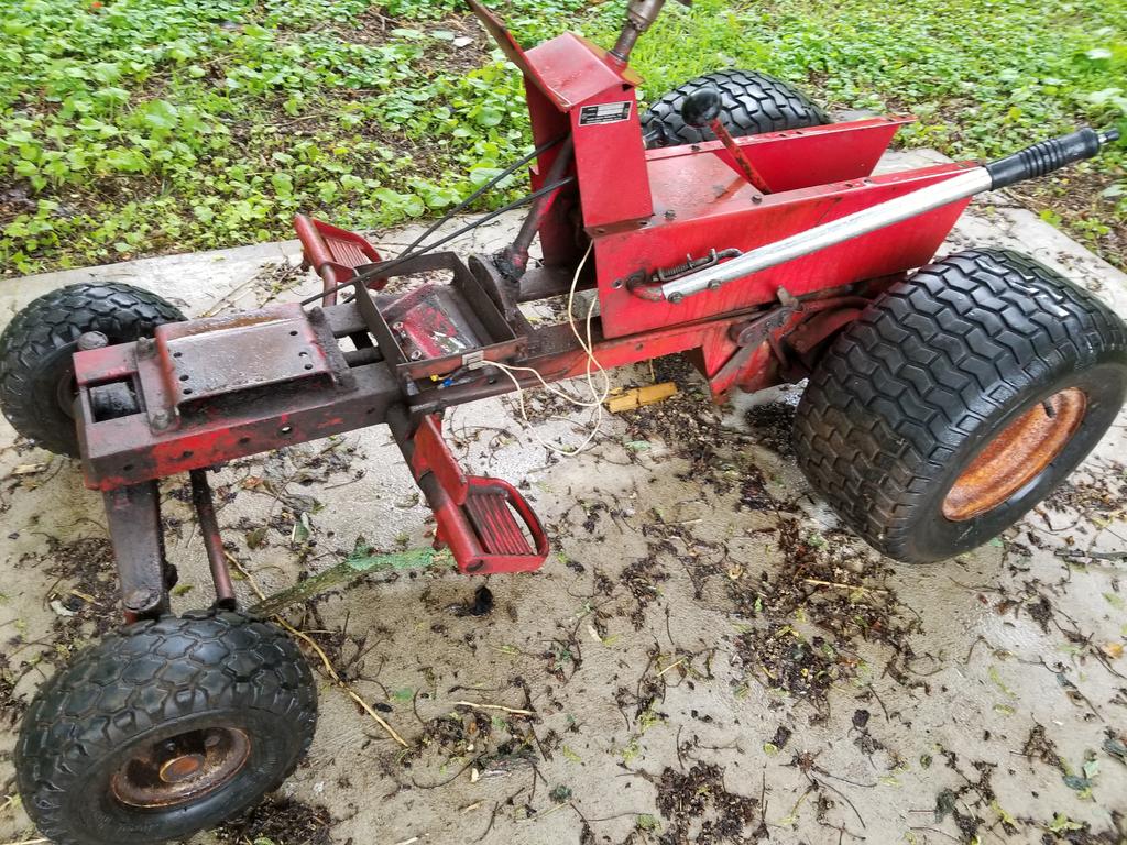

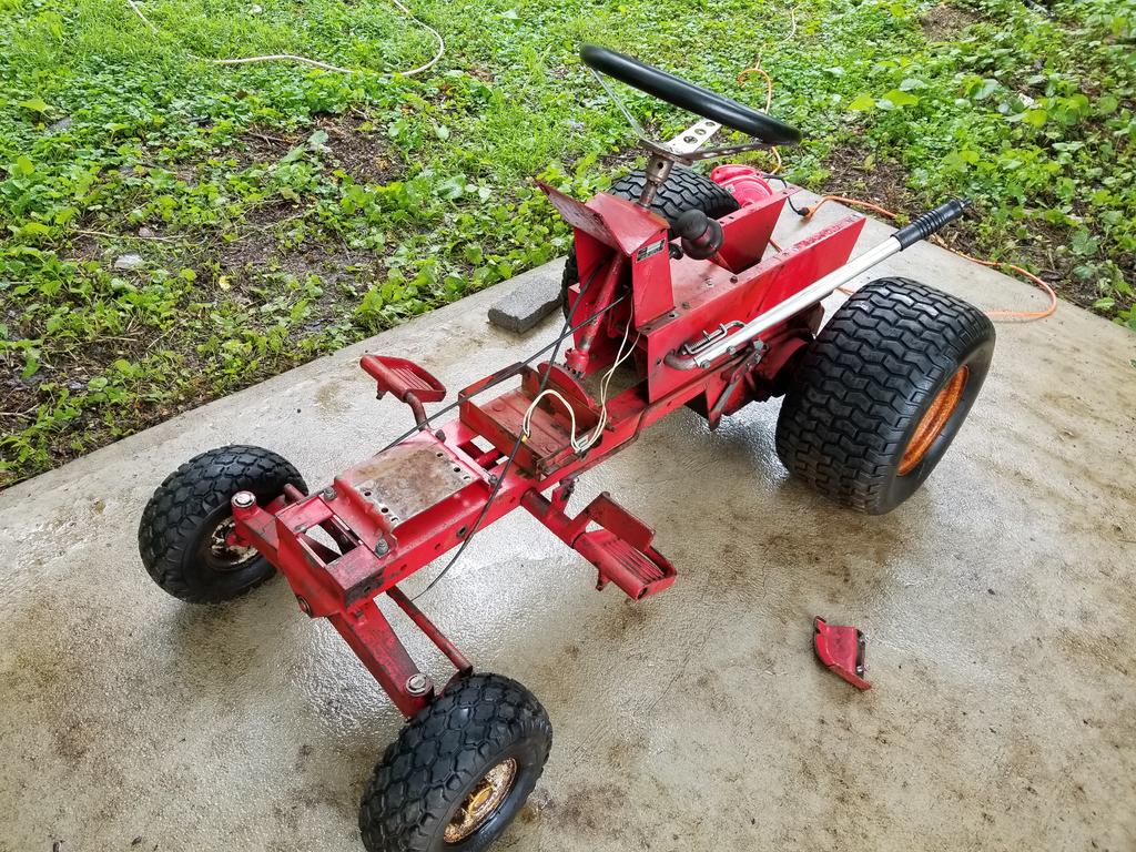

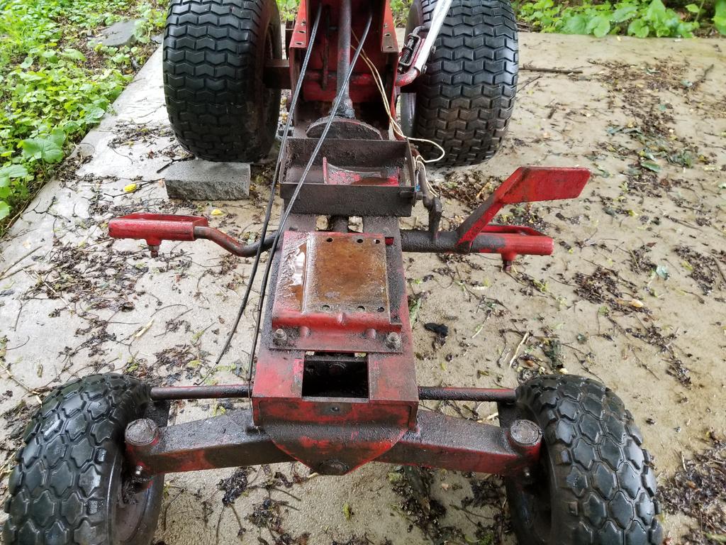

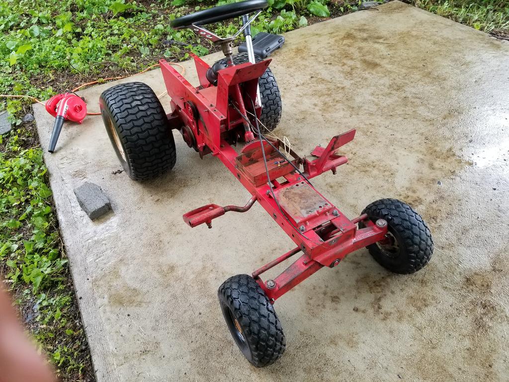

MarkS 122 #1 Posted June 28, 2018 Picked up my new l-165 lawn ranger yesterday. The guy I bought it from was going to do a restoration, but got the tractor apart and lost interest. When I picked it up, the motor was off, as well as all the cover pieces, fender and hood. Today I spent the day degreasing and cleaning the frame and other parts. I got everything back on, except the hood, so I can work on the engine. The engine had no exhaust, so I picked up a muffler and some pipe to use. I changed the engine and transmission oil, spark plug, and air filter. Right now the engine isn't getting spark or fuel, so tomorrow I will look at the magneto, and the carb. Hopefully tomorrow I will have the engine running, and when the drive belt I ordered arrives Friday, hopefully I can take it for a spin! I've attached photos (hopefully in order) of before and after I did some cleaning, and after putting some things back together. The seat is just sitting on there, I'm not sure if it the right seat or not. How are they supposed to attach? 5 2 1 Share this post Link to post Share on other sites
Terry M-(Moderator) 2,322 #2 Posted June 28, 2018 Looks like a nice mostly original Lawn Ranger!! Steering wheel and seat are not original, but the rest looks nice and straight... ( the seat can just be bolted directly to the fender pan) Share this post Link to post Share on other sites
Tankman 3,528 #3 Posted June 28, 2018 Looks great! 2 Share this post Link to post Share on other sites

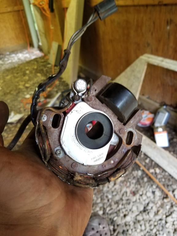

MarkS 122 #4 Posted June 30, 2018 Got the carb cleaned out and a few other things, but I cannot get spark! I tried a new condenser, but I still barely produces any voltage. I cleaned up the magnets and the magneto, but can't quite figure it out. Share this post Link to post Share on other sites
AMC RULES 37,259 #5 Posted June 30, 2018 (edited) You cleaned the points(even if they're new)... and, added a new plug too? Edited June 30, 2018 by AMC RULES Share this post Link to post Share on other sites
MarkS 122 #6 Posted June 30, 2018 Just now, AMC RULES said: Cleaned the points... and, added a new plug too? I looked at the points and they looked really clean. Ill try that next. And yeah, I got a new plug. Share this post Link to post Share on other sites
MarkS 122 #7 Posted July 2, 2018 Cleaned the points, but still no luck. I'm beginning to think that the whole thing may be bad. Does anyone know if there are any replacements? I have looked and not found anything. Possibly a way to change to a different type? Share this post Link to post Share on other sites
