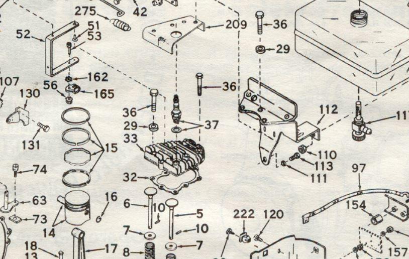

ebinmaine 79,599 #1 Posted June 27, 2018 It's highly likely that I'm just plain missing it in the manual but I honestly couldn't find it. I'm also not very good at searching on my smartphone on this website. So if one of you fine folks could tell me what the spark plug number is it would be awesome! Share this post Link to post Share on other sites
ebinmaine 79,599 #3 Posted June 27, 2018 Just now, WHX20 said: Champion RJ8C I have a j8c without the r. No resistor. That works okay? Share this post Link to post Share on other sites
WHX?? 57,361 #4 Posted June 27, 2018 It will do in a pinch as long as the threads and reach are the same. Share this post Link to post Share on other sites
ebinmaine 79,599 #5 Posted June 27, 2018 1 minute ago, WHX20 said: It will do in a pinch as long as the threads and reach are the same. Nice. I'll double-check it to be sure. Thanks! Share this post Link to post Share on other sites
pfrederi 20,837 #6 Posted June 27, 2018 The original item was a plain J-8. Don't think resistor plugs were big 50 years ago. I use the non resistor plugs if it interferes with somebody driving by GPS or Cell phone I don't care...stay off my road 2 1 Share this post Link to post Share on other sites
ebinmaine 79,599 #7 Posted June 27, 2018 53 minutes ago, pfrederi said: interferes with somebody driving by GPS or Cell phone I don't care...stay off my road Hehehehe..... I like your thinking. Thanks for the chart Paul 1 Share this post Link to post Share on other sites
