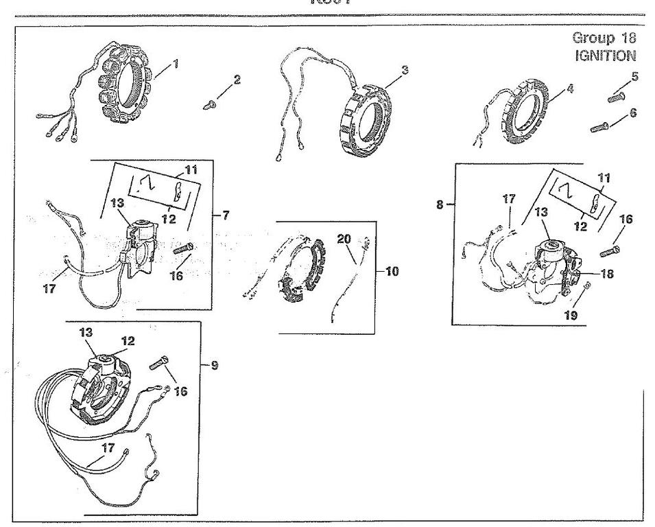

pfrederi 19,278 #28 Posted June 30, 2018 It is hard to figure out the correct mag part number. If you look up your spec number Kohler shows it having a Breakerless system. Since I assume you have a 10 amp charging system I would guess what you need is 4714502 ...only $144.00 Which stator mag does yours look like?? Share this post Link to post Share on other sites

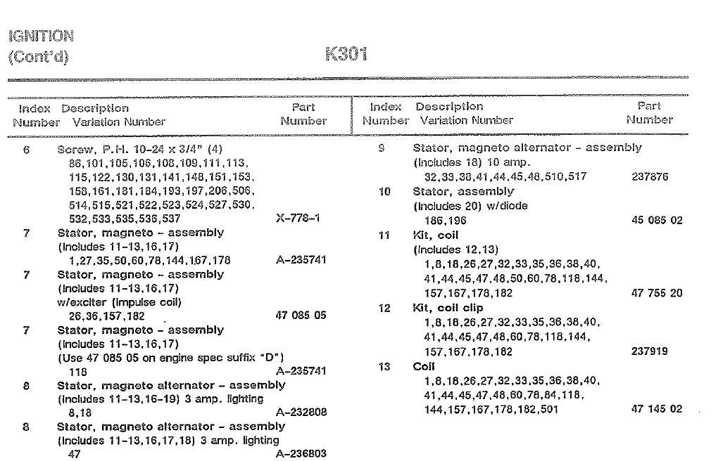

gwest_ca-(File Mod) 11,852 #29 Posted June 30, 2018 Found this using after-market catalogs. Seems Kohler missed some info in their parts lists. Click on the picture Garry Share this post Link to post Share on other sites

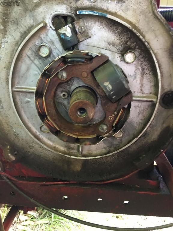

shunter 20 #31 Posted June 30, 2018 pulled the flywheel today to find the Magento (coil) has cracks see pic. Share this post Link to post Share on other sites
shunter 20 #32 Posted June 30, 2018 (edited) 6 hours ago, pfrederi said: It is hard to figure out the correct mag part number. If you look up your spec number Kohler shows it having a Breakerless system. Since I assume you have a 10 amp charging system I would guess what you need is 4714502 ...only $144.00 Which stator mag does yours look like?? can you buy just the coil or is it one piece coil and stator? Looks like this (see pic} what your best guess? Edited June 30, 2018 by shunter Share this post Link to post Share on other sites
pfrederi 19,278 #33 Posted June 30, 2018 (edited) Looks like number 9 to me but I would look for just the coil #13.. If the charging stator works and you have points you may find it cheaper easier to change to battery coil system. lots of internally resisted 12v coils very cheap and change the ignition switch Edited June 30, 2018 by pfrederi Share this post Link to post Share on other sites

bo dawg 536 #38 Posted July 18, 2018 I'm sure It was that ign coil. I had the same thing happen to me a few years back to a 68 Charger with the internal coil. I ended up converting it to an external coil and it ran great again. Plus cheaper than the cost of the internal coil. Been scared to use water on any tractor since. 1 Share this post Link to post Share on other sites
