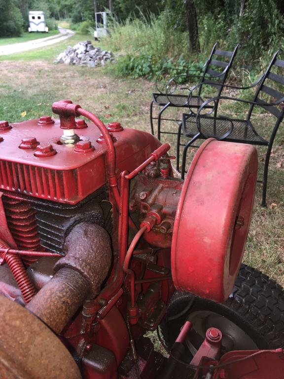

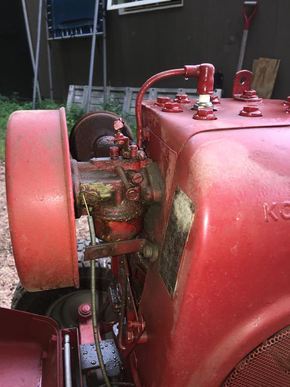

shunter 20 #9 Posted June 27, 2018 pictures of it when I first bought it Share this post Link to post Share on other sites

953 nut 68,176 #11 Posted June 27, 2018 9 minutes ago, shunter said: help me out please, where is it, the spark plug wire goes into the case, do I need to pull the side casing off? Based on the photo it appears the magneto ignition system is what you have. Th late '60s - early '70s ones I have had were trigger ignitions. Your points are located under the small removable cover in the lower left of your last picture. dry and clean them and you may be back in business. Share this post Link to post Share on other sites
