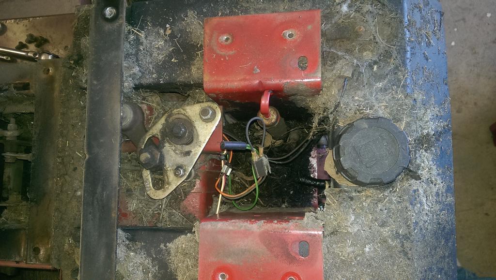

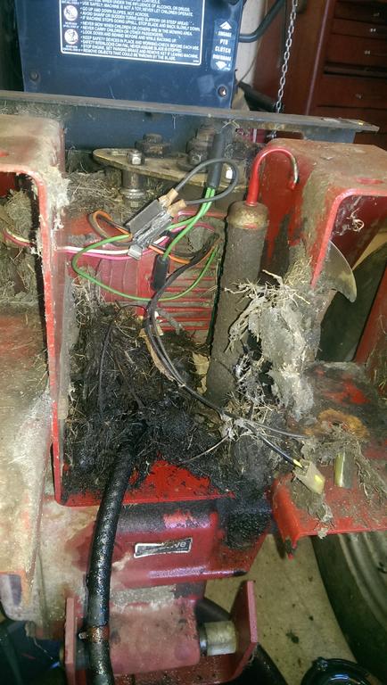

WVHillbilly520H 10,379 #11 Posted September 20, 2018 17 minutes ago, Gary520H said: Hello again, I cannot find that bolt to remove to help vent hydro when filling with new oil. Is it underneath the seat pan? I don’t think mine has the tube that is referred to in previous post. Here's a pic with the fender and seat removed but you'll be able to find it (the bolt holding the hose clamp) after this (BTW a tip to the wise remove seat and fenders and pressure wash and compressed air clean the pump fins and hydro trans clean) or it could end up looking like the next 2 pics, Jeff. Share this post Link to post Share on other sites
JAinVA 4,638 #12 Posted September 21, 2018 Great pictures of the crap you can run across when you dig into these machines.Thanks for posting them Jeff.I removed the fender pan on one of the 416Hs and except for the top of the pan support everthing was black.That coating was from less than 300 hours use. Share this post Link to post Share on other sites
WVHillbilly520H 10,379 #13 Posted September 21, 2018 5 minutes ago, JAinVA said: Great pictures of the crap you can run across when you dig into these machines.Thanks for posting them Jeff.I removed the fender pan on one of the 416Hs and except for the top of the pan support everthing was black.That coating was from less than 300 hours use. Jim, The one pictured above is the low hour (236) 520 I bought over 2 years ago, my anniversary I bought new was gunked up around the pump after 15 years of mowing and driveway repairs and fluid changes, Jeff. 1 Share this post Link to post Share on other sites
JAinVA 4,638 #14 Posted September 21, 2018 (edited) I think that most of the oil mess on the 416 was from an oil change gone bad.What a mess.I remember those pictures from a previous post and they are a good way to show what a new owner should look for. Edited September 21, 2018 by JAinVA 1 Share this post Link to post Share on other sites

Gary520H 2 #16 Posted September 21, 2018 WOW 😮! What a mess. Thanks everyone for taking the time to provide advice and suggestions for changing Hydro oil. Thanks for detailed photos. Gary Share this post Link to post Share on other sites
cleat 9,290 #17 Posted September 21, 2018 Yes, those photos look terrible. I can only imagine that rear end would heat up fast too. Cleat Share this post Link to post Share on other sites
