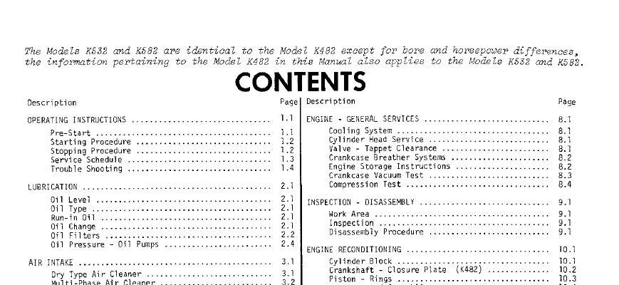

pfrederi 21,308 #2 Posted June 26, 2018 From Kohler service manual But the big issue may be the crank shaft. Different spec motor have different length an even diameter cranks depending on what the customer wanted. You would have to measure 1 Share this post Link to post Share on other sites
