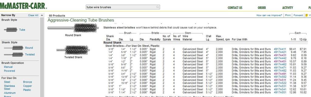

pfrederi 20,899 #2 Posted June 25, 2018 These work fairly well cleaning out threads 4 Share this post Link to post Share on other sites
