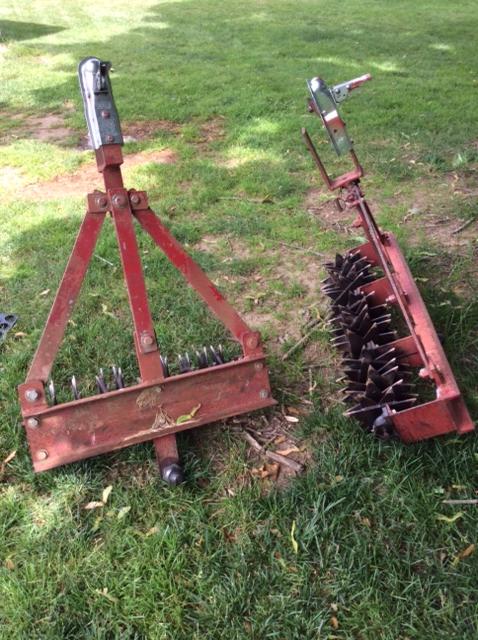

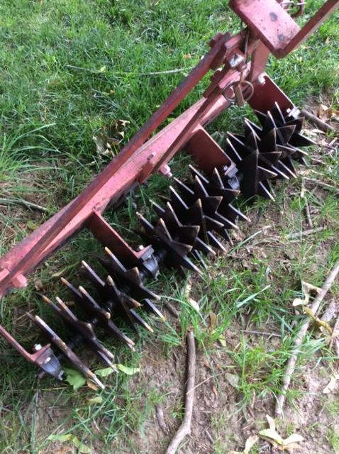

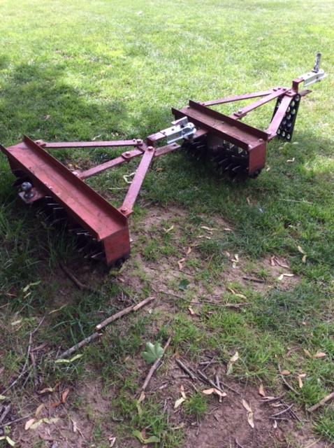

peter lena 10,016 #1 Posted June 23, 2018 built these over 30 years ago as a millwright, for lawn aeration and to break up thatch. Made them to be bombproof ,after experiencing a briny hardy spikier that was junk. 6" welded channel for base frame along with seal master pillow block bearings , welded all the spikier wheels from 1/4" flat steel, 3/4" s/s axel sleeves for hardened axel. use bush vacuum pump rotors for slotted weight that traps in channel. 90lb and 190lb. regularly tow one of them with out weight when cutting, lawn is soft and grows well. birds follow after spiking , for worms. I replaced a few of the spike wheels after 30 years, wearing down. they have never failed , combine them with a clean deck and sharp blades, and lawn looks very good. I tandem them with 270 lb. weight after a rain , my lawn looks like a strafing run, thousands of oblong holes. that's what I did today, pete 6 1 Share this post Link to post Share on other sites

peter lena 10,016 #3 Posted June 29, 2018 that's a good detacher on a solid frame with good wheels , like from another planet, nothing like that today, that's why I built mine. I use my 28" spiker more than my 40", unless the lawn calls for it, they both tow without effort and just finish off a lawn like it should be. I also never cut it the same way to avoid lines. found if you cut with the drive by line, you won't see the cutting lines , but if you cut vertically against the sight line the lines stand out. also regularly clean out and aireate my deck along with sharp blades , for a good look, good cutting , tankman , Pete Share this post Link to post Share on other sites
