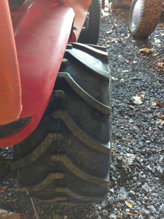

MAD MARK 74 #7 Posted July 1, 2018 Went ahead and got the Carlisles. Little tough mounting them. Got them foam filled. Added 71.5# per tire. Total weight is 107.5#. Feels a lot more balanced and sturdy on hills. 2 Share this post Link to post Share on other sites

MAD MARK 74 #14 Posted July 1, 2018 6 hours ago, RandyLittrell said: How is the ride? Do they have any give being foam filled? Thanks, Randy Rides a lot harder. Almost no give at all, but I knew that going in. I had skid loader tires filled before, that's because i drove through metal fields. It's no horrible, but it's the payoff for the weight and never going flat. 6 hours ago, oliver2-44 said: @MAD MARKCan you share any details on the foam they used. My local tire shop has 3 density of foam... he calls them soft, hard and ( really hard for large fork lifts) They inject with foam and let them cook inside a large stove for 24 hours. The guy never gave me an option for densities but i could call and ask, I know they use a book and can quote me prices and exact weight I'll gain up front. Share this post Link to post Share on other sites
MAD MARK 74 #15 Posted July 1, 2018 If you look at my picture I posted you can see the screws in each tire they use for filling and then to denote that they are filled. It's a 4" long screw. The ones in the skid loader are larger lags. Share this post Link to post Share on other sites
