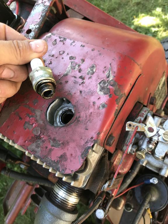

Chris1055 106 #1 Posted June 21, 2018 Hi guys. As I’m going through this tractor to get everything mechanically set. I’d figure I ask you about this. The motor runs very strong. It was sitting for a long time before I got it did the normal carb kit adjusted to book specs then tuned. Replaced fuel lines filter. Just didn’t put points or plug in as it fires right up. Actually I’m impressed right now because I don’t have to choke it on a cold start in the ct summer. But when it runs on any speed from idle to high rpm. It’s sporadically has little pops. It’s really more of a nuisance really I’d like to have it cleared up. I can say it’s definitely not starving for fuel. And the throttle arm stays put it doesn’t surge. Any little tricks or recommendations would be very helpful. thanks, Chris Share this post Link to post Share on other sites

Chris1055 106 #5 Posted June 21, 2018 I just pulled the spark plug it’s fouled pretty bad. And looks like a lot of build up inside. I never thought about this probably because when I bought it. The head was cleaned and looked like a brand new head gasket. I pulled it out and the spark plug is a j19LM. I thought these were j8c? Well I thinking know to pull the head just to see what she looks like. Share this post Link to post Share on other sites
JoeM 10,101 #7 Posted June 21, 2018 Looks pretty dark, when you screw the main jet in then out is there a difference? Share this post Link to post Share on other sites
Chris1055 106 #8 Posted June 21, 2018 Just cuts out if you turn to bottom out or unscrew all the way. As I said it runs strong on all rpm range but when it gets to mid to high. It’s as intermittent, pop pop pop. It diesnt slow the motor any. But I really don’t have a load on it. Points look really worn. Wondering if I should get a set. I don’t know if that would really help with a new spark plug. I cleaned the carb thoroughly today. And It’s clean as a whistle. I wish I could post a video. Share this post Link to post Share on other sites
gwest_ca-(File Mod) 12,372 #9 Posted June 21, 2018 I would put the proper plug in properly gapped along with some Marvel Mystery oil in the fuel and run it. Give it a chance. Garry 1 Share this post Link to post Share on other sites
JoeM 10,101 #10 Posted June 21, 2018 Replacing worn points, you can't go wrong. It can be the difference. Recheck that main jet screw to make sure end is not damaged. Sometimes people screw them in to tight and cause deformation. 1 Share this post Link to post Share on other sites
