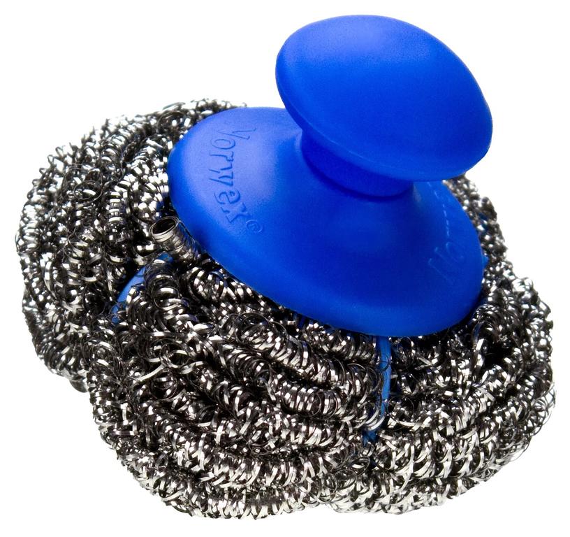

AMC RULES 37,259 #3 Posted June 21, 2018 You mean this stuff? Try this Ebay search..."oil bath air cleaner element" 1 Share this post Link to post Share on other sites

motor12 367 #6 Posted June 23, 2018 Thanks guys, think the stainless steel scrubbing balls will work the best for this application. I stretched and pulled on one to see if any small bits would come off and they didn't. After coated in 40 wt. oil the should work fine. Share this post Link to post Share on other sites
