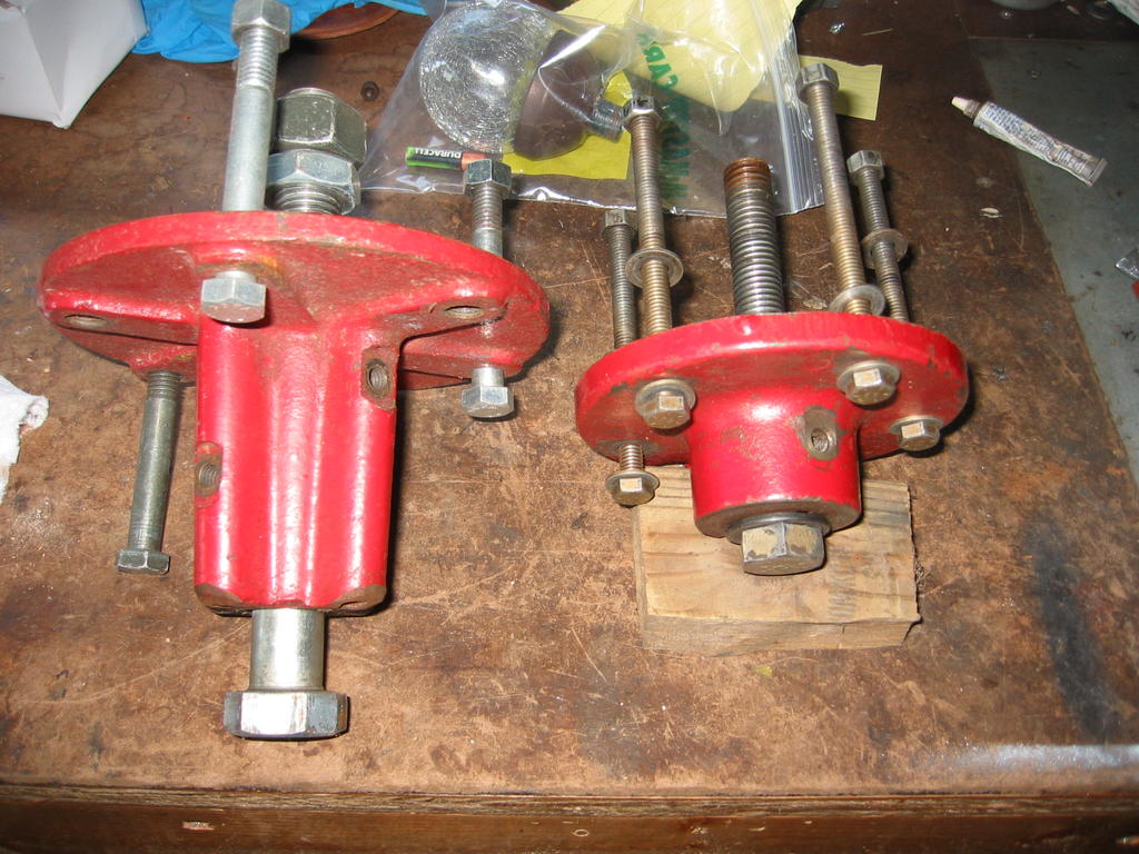

pfrederi 20,681 #3 Posted June 17, 2018 D series hubs are much longer and have different bolt pattern and center hole D on the left Share this post Link to post Share on other sites

pfrederi 20,681 #6 Posted June 17, 2018 The outer D set screw will probably beyond the end of C-165 axle Share this post Link to post Share on other sites
