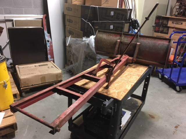

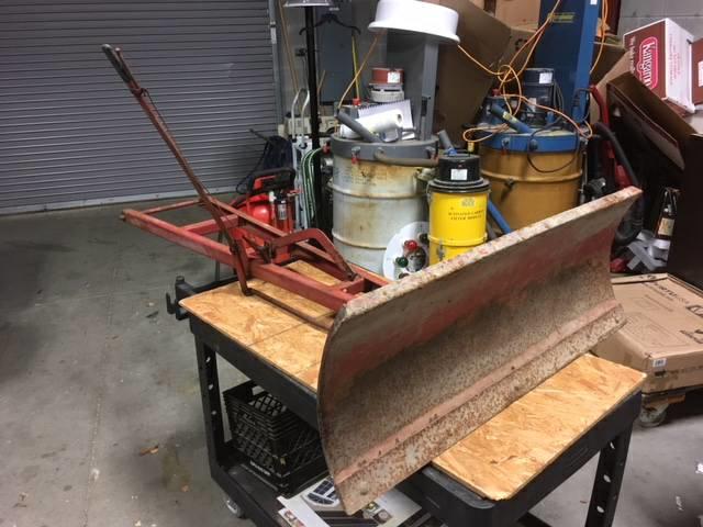

dkg520 531 #1 Posted June 16, 2018 Can anyone tell me if this will fit a 1975 C160? Thank you for any help. Share this post Link to post Share on other sites
rjg854 13,405 #2 Posted June 16, 2018 No, that's a short frame plow. Like the 857, Commando 8. 1 Share this post Link to post Share on other sites

SylvanLakeWH 32,708 #4 Posted June 16, 2018 I am pretty sure you can put an extension kit on this. Search for "plow Extension" and a bunch of threads come up. Not an expert but over the years I have seen a bunch of comments regarding extension kits and fabricated extensions for front blades... Share this post Link to post Share on other sites
KC9KAS 4,746 #5 Posted June 16, 2018 4 hours ago, SylvanLakeWH said: I am pretty sure you can put an extension kit on this. Search for "plow Extension" and a bunch of threads come up. Not an expert but over the years I have seen a bunch of comments regarding extension kits and fabricated extensions for front blades... I think an extension kit is for machines like the 520 with the forward swept axle so the front wheels do not interfere with the angled blade. Not to say that an "extension" won't work, but I am afraid a lot of additional fabrication will be needed. 1 Share this post Link to post Share on other sites
Tankman 3,528 #6 Posted July 4, 2018 (edited) Extension kit is for the 520's with the swept axle. Would be easy enough to add to the rear of your frame. Been there done that. I extended a frame at the front for my '90 520-8. Two 4-1/2" channels, extension. Dimensions matched the OD's of the frame. Two 12" channels, OD's matched the ID's of the frame. Welded inside the frame for strength. Added 4-1/2" rod to the angle lever rod. Bent 1/8" rod for the angle release. Edited July 5, 2018 by Tankman 1 Share this post Link to post Share on other sites
