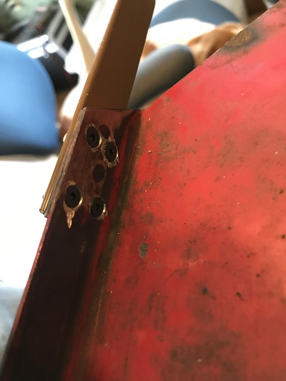

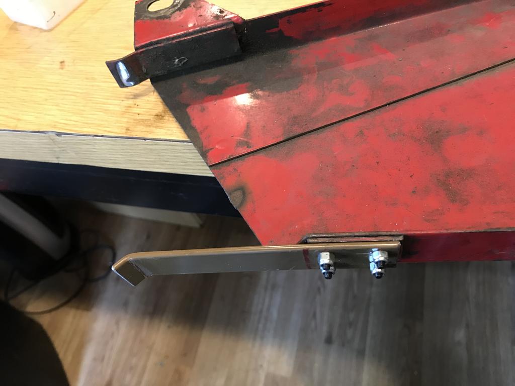

WH654 23 #11 Posted September 29, 2019 Well I had to buy all new belts for the deck and in talking to the old guy that owned this Toro wheel horse dealership forever he told me that it’s important to have a finger on both the top and the bottom of the belt right by the crank pulley so that when you push the clutch in the slack is forced to go away from the drive pulley and allows the bell to slip so you can shift gears. So I took the belt guard back off and realized that the bottom finger was broken off the guard and that was my actual problem. So I added a new finger on the bottom and it works beautifully now. 1 Share this post Link to post Share on other sites
