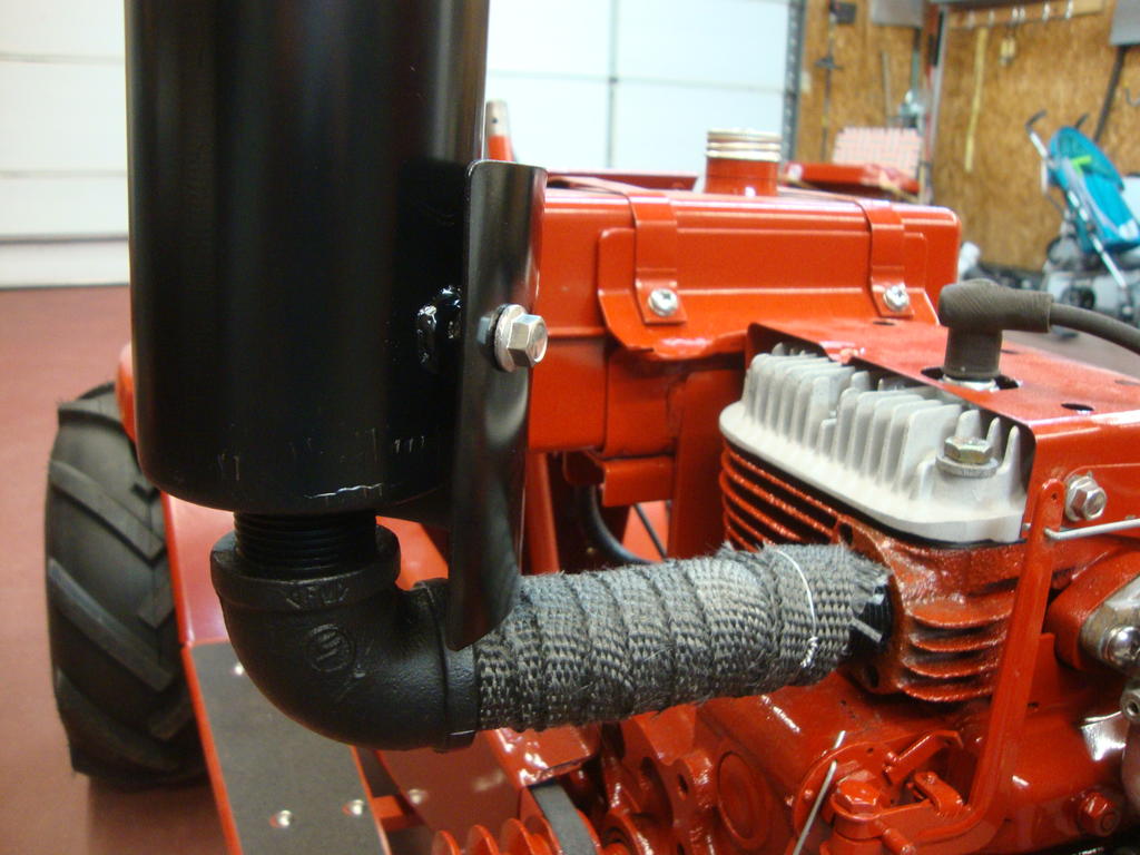

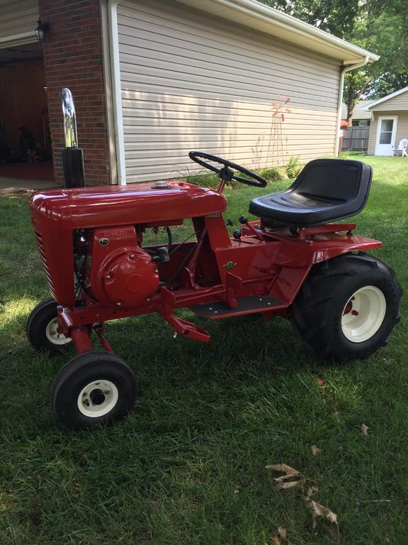

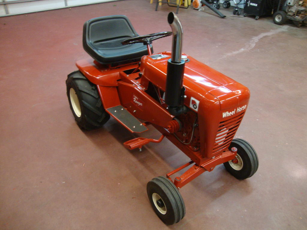

dclarke 4,274 #52 Posted August 20, 2018 Got the hood on and decided to put a longer nipple in the exhaust to move the stack a little farther away from the hood. I still need to paint the letters on the front of the hood and add the decals. 4 11 Share this post Link to post Share on other sites

dclarke 4,274 #54 Posted August 24, 2018 After running it a while I've torqued the head bolts again, the decals are on and the letters on the front of the hood are painted. I wrapped the exhaust nipple in header wrap and made a heat shield for the stack. This project is done. 1 10 Share this post Link to post Share on other sites

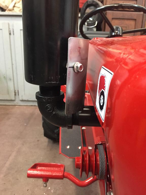

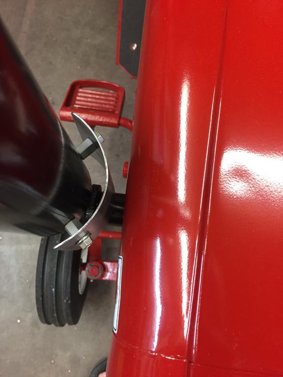

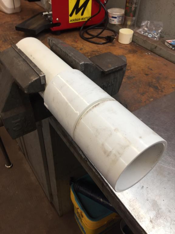

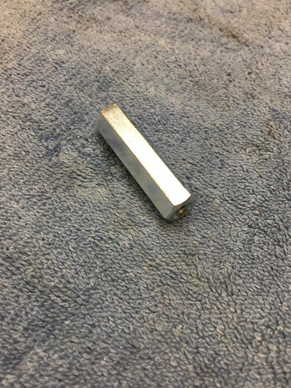

ebinmaine 80,667 #55 Posted August 24, 2018 2 hours ago, dclarke said: made a heat shield I like that idea. Most of my tractors will have stacks. How did you do that? Share this post Link to post Share on other sites
dclarke 4,274 #56 Posted August 24, 2018 41 minutes ago, ebinmaine said: I like that idea. Most of my tractors will have stacks. How did you do that? My stack is 3” diameter, I used a piece of 16 ga. (I think) metal cut to about 5” x 12”. Heated it a little with a heat gun then formed it around a 3” plastic pipe coupling that measures 4” O. D. Once I had the shape I wanted I cut it to size and drilled a couple of 1/4” holes in it. I used a 1/4” coupling nut cut in half then shortened each half a little to get the spacing I wanted and welded the nuts to the stack. I did bolt the nuts to the shield and tack them to the stack while it was on the tractor then removed the stack and welded the nuts. 3 5 Share this post Link to post Share on other sites

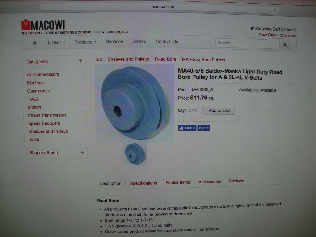

dtallon 320 #58 Posted August 26, 2018 (edited) That tractor turned out fantastic. I can't wait to see the next one. You have inspired me to work some on my Ranger 8-speed project, and I am quickly gaining appreciation for the little modifications you did. What pulley did you use for the transmission input pulley? I did some measuring and the 2.5" engine / 4" trans pulley set on the Ranger is approximately the same ratio as the 4" engine / 6.5" trans that the 312-8 I got the transmission from had. Unfortunately I can't just swap over the trans pulley from the Ranger because it has a 3/4" input shaft and the 8-speed has a 5/8" shaft. Dave Edited August 26, 2018 by dtallon Share this post Link to post Share on other sites
dclarke 4,274 #59 Posted August 26, 2018 1 hour ago, dtallon said: What pulley did you use for the transmission input pulley? I did some measuring and the 2.5" engine / 4" trans pulley set on the Ranger is approximately the same ratio as the 4" engine / 6.5" trans that the 312-8 I got the transmission from had. Unfortunately I can't just swap over the trans pulley from the Ranger because it has a 3/4" input shaft and the 8-speed has a 5/8" shaft. Dave Dave, the input pulley on this one measures 4 or 4 1/4"" it's kinda hard to measure now and the engine pulley is 2 1/2". This tranny has 1" axles and the pulley came with the tranny, I think this input shaft is 5'8". In the past I have used the Maska 4" pulley pictured below on a 5/8" input shaft, I did have to modify it a little but it worked great. I ground the hub down to fit the length of the shaft and had to drill and tap new set screw holes, which I had to drill on a slight angle. I'll use this pulley on my next Ranger project if I can't find a pulley like the one I have on this Ranger. Share this post Link to post Share on other sites

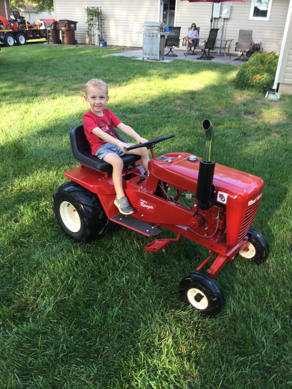

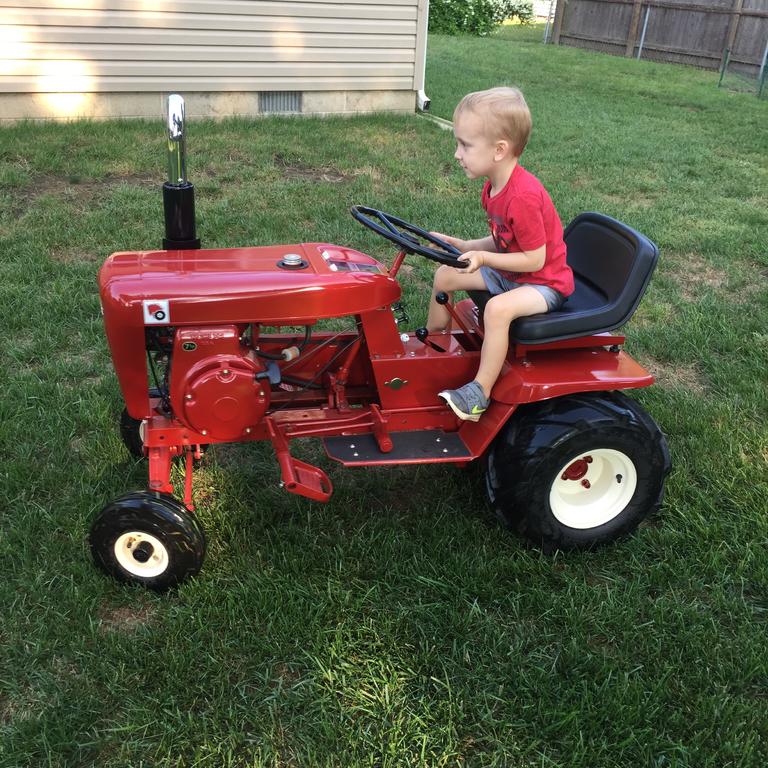

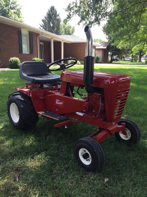

dclarke 4,274 #61 Posted August 27, 2018 On 8/24/2018 at 3:54 PM, 953 nut said: Not quite done! Don't see any Grand kids riding on it. Here ya go Richard. He loves it! 2 7 Share this post Link to post Share on other sites
ebinmaine 80,667 #62 Posted August 27, 2018 Two clear-cut championship-winning calendar shots right there 3 Share this post Link to post Share on other sites

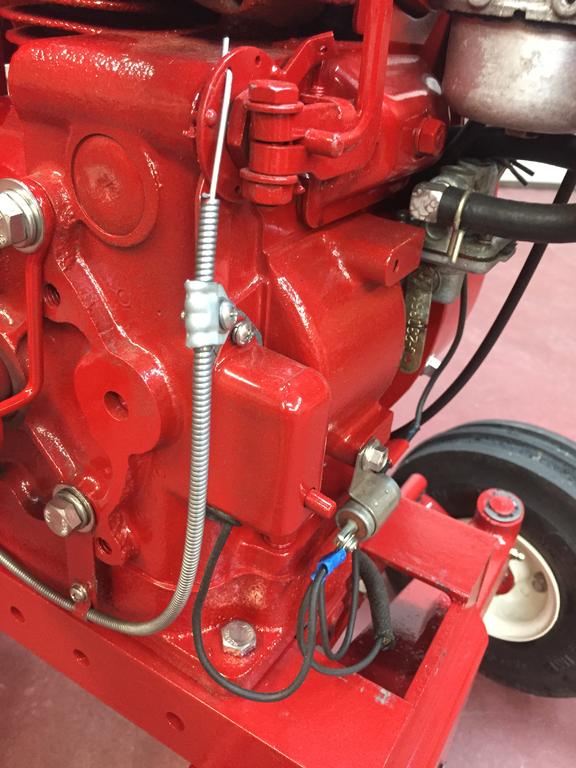

prondzy 3,890 #63 Posted September 8, 2018 Wow Denny that looks nice! I have been plugging away at the kids Lawn Ranger and now have a few ideas for the gas tank mount thanks to yours. Did you use the stock Throttle/Choke cables or did you buy longer ones and modify? Share this post Link to post Share on other sites
dclarke 4,274 #64 Posted September 8, 2018 50 minutes ago, prondzy said: Did you use the stock Throttle/Choke cables or did you buy longer ones and modify? Mike, I had to get longer cables, here’s how I ran the throttle cable. 2 Share this post Link to post Share on other sites

prondzy 3,890 #67 Posted September 9, 2018 On 9/8/2018 at 10:04 AM, dclarke said: Mike, I had to get longer cables, here’s how I ran the throttle cable. Ok last question Denny, where did you find those throttle cable clamps.They look like nice ones and i havent found any good ones yet. Share this post Link to post Share on other sites
dclarke 4,274 #68 Posted September 9, 2018 3 hours ago, prondzy said: Ok last question Denny, where did you find those throttle cable clamps.They look like nice ones and i havent found any good ones yet. Mike, the cable clamp bolted to the engine I found in my Dad’s auto parts store back in the 70s. They sold and serviced push mowers back in the 50s and 60s and it was a leftover part from that. I had a few of them at one time but this is the last one I have. The clamp up by the governor was in my junk drawer too. Not sure where it came from. 1 Share this post Link to post Share on other sites
