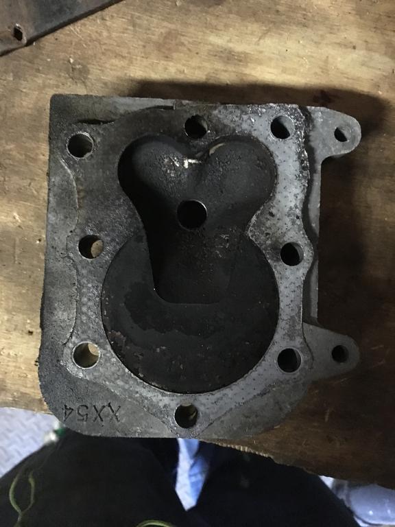

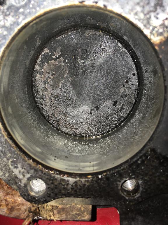

Tractor boy 239 #1 Posted June 14, 2018 First mods if this is in the wrong section please move it. So I did the seasonal on the craftsman beater push mower. Finished that up and went to start it. It will not start at all. So I pulled the shrouds off. Then the carb and spark. Decided that since I had gone this far, I might as well pull the head and see what she looked like. The first one is the piston inside of the block. So this leads to questions one and two. 1- is it common for fuel to be in the block? 2-the piston head looks as if it is covered in exhaust crud. I’m assuming this means something bad. So is that good or bad. The second picture is the cover for the head. This is also covered in after mentioned crud. This leads to another question for me. - Is the cover susposed to be like this with said issue in question one? -Finally, is this cover okay to wire brush. Share this post Link to post Share on other sites
oldredrider 2,554 #2 Posted June 14, 2018 Yup. OK to wire brush all that. Kinda looks like you have stuck rings therefore, no compression. That will keep it from starting. Got fire? Got gas? Only thing missing is compression. 1 Share this post Link to post Share on other sites
953 nut 70,299 #3 Posted June 14, 2018 4 minutes ago, Tractor boy said: is it common for fuel to be in the block? On occasion a mower will be turned on one side and then the other while servicing things. If it gets into a position where the fuel from the carburetor passes from the float bowl to the cylinder this can happen. Chances are the gas got into the oil, best change it to be safe. Share this post Link to post Share on other sites

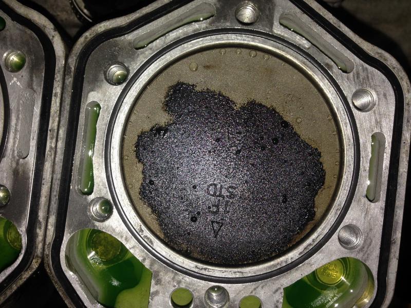

Achto 32,920 #6 Posted June 15, 2018 Having your piston covered in carbon is a good thing. Looking at your piston I can assure you that the rings are just fine. If the top of the piston was clean, this would be what they call piston wash, This happens when oil is getting past the rings. This pic is a good example of piston wash caused by bad rings. Every thing looks really dry in your picture, I'm wondering if you are getting fuel to the cylinder. If this is a carb on top of the tank model there may be a chance that the diaphragm in the carb may have a hole or crack in it. If this is the type of set up that you have try installing a new carb kit, it should cost less than $10 for an OEM kit. I'm guessing that you verified spark already. Share this post Link to post Share on other sites

Achto 32,920 #8 Posted June 15, 2018 I would clean the head up and put it back on the engine. Then do a compression test. if you don't have a compression tester, this can be as simple as holding you finger tight over the spark plug hole while some one pulls the rope. If you have good compression air should force past your finger. If compression and spark are good, then the only thing left is fuel. Try squirting a little gas into the spark plug hole, quickly put the plug back in and try starting. If it tries to start then I would look further into a fuel issue. You don't recall if you may have hit something that snubbed the engine at one time? I have seen the key for the fly wheel shear from this type of incident causing the timing to be off. Share this post Link to post Share on other sites
