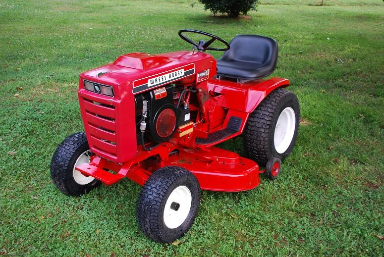

McGrew 461 #1 Posted June 13, 2018 Hello folks! New guy here. My Dad bought a new Wheel Horse Raider 10 on September 2, 1971. I drove that tractor many times as a teenager. I believe some of my Dad's best times were the times he was on his Wheel Horse. He loved that tractor! He used it to cut grass, plow his garden and drag trailers and boats around the yard. Dad passed away in 1995, and my older brother took possession of the tractor and did a complete restoration on it. He used it sparingly, and about 2 months ago, he asked me if I wanted it... Of course I did! Along with a plow, dozer blade, harrow and wheel weights, I was given a time capsule of information on this tractor. I even have an original newspaper ad for Wheel Horse tractors that lists about 10 local dealers. While in my brother's possession, the 10hp Tecumseh ignition went south, and he replaced the engine with a 14hp Tecumseh. This is one of the things I would have done differently, as now the tractor has a hole in the hood with a Bolens hood scoop... The good news is my brother completely rebuilt the 14hp engine and it runs great. He also gave me the original engine. Since I took possession, I have replaced the throttle and choke cables with the correct ones, and made a bracket to hold the cables and replaced and rerouted the fuel lines. I replaced the front tires and glass blasted the rims and repainted them. Three of the tires on the tractor were the original Wheel Horse branded tires. The rears are still original. I replaced the original seat, which was pretty ratty, and made some spacers to give me a little more leg room. I have plans to work on the fit of the hood, as it got a little warped on a wild ride down a steep hill at my Brother's house... I also plan to replace both rear hubs with some billet steel hubs I am making. The rear needs axle seals, and one hub has been welded up and looks really ugly... I am going to try to attach pictures... Let me know what you think. I know Dad would be proud to see his Horse still kicking! 6 13 1 Share this post Link to post Share on other sites
Sparky-(Admin) 24,640 #2 Posted June 13, 2018 Yep! Your dad would be proud of how well his Wheel Horse was being taken care of! Any pics of it before it was painted up? Share this post Link to post Share on other sites
McGrew 461 #3 Posted June 13, 2018 Sparky, No, I don't have any "before" pictures. I think Mom (who turns 101 in December) may have some in her collection. I will have to ask. Regarding the condition, a couple of the things my Dad taught me: 1) Buy good equipment and 2) take care of it and it will take care of you. Dad did not baby this tractor, but it was always stored inside and got regular maintenance. 6 3 Share this post Link to post Share on other sites
BOB ELLISON 2,983 #4 Posted June 13, 2018 Welcome to Redsqure @McGrew That is one fine looking wheel horse. I like the bump on the hood it looks much better then a hole as I have seen on others. I like the Raider 10 or 14 in this case and the design was very nice. It will last another 47 years. Great job by your brother and that it was your father's makes it very personal to you. 1 Share this post Link to post Share on other sites

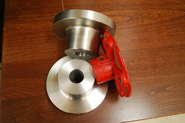

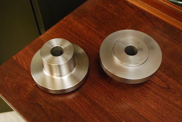

McGrew 461 #9 Posted June 13, 2018 Gentlemen, Thank you for the warm welcome! Regarding the hubs I am machining, I have some concerns about the steel I am using. I believe it to be 1018, but since it was a scrap piece, I cannot be sure. This tractor will be used regularly, but will not see the heavy duty use it got with my Dad. I may put the plow on and make a few passes for my wife's garden, but that will be about the extent of it. I fear the keyway in the new hubs may not hold up? I do have a couple of options. I can case harden the whole hub after it is fully machined, or I can sleeve the hub with a harder (4140?) steel. If you notice in the picture, the hubs are MUCH beefier than the stock cast iron ones, and will easily accept a sleeve. When I was machining them, I thought "who needs wheel weights if you make your hubs heavy enough"! They are not done, but this is where I am now. Please give me your thoughts! One other thing, the tractor looks a LOT better in the pictures than it does in person! I has lots of "character"... But this is a working tractor, not a show piece. Thanks for all the input! 5 Share this post Link to post Share on other sites

lynnmor 8,631 #13 Posted June 13, 2018 Be sure to put two set screws in the hubs and a flat for the second screw on the axle. I believe that you will be OK with the 1018 unless they see some extreme duty. Check the tightness of the set screws regularly. One downside of 1018 (cold-rolled steel) is that it will rust much faster than an alloy steel, so be sure to use anti-seize on the axles. 1 Share this post Link to post Share on other sites

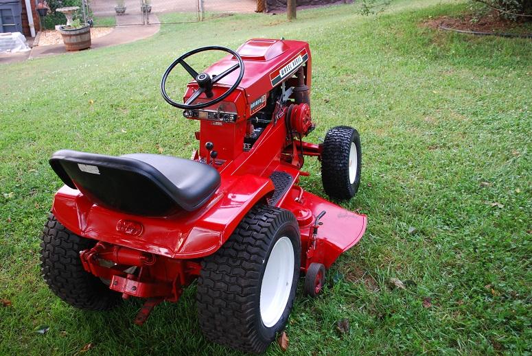

wallfish 19,325 #16 Posted June 14, 2018 and thanks for sharing the story of your horse. That hood scoop doesn't look bad at all. When reading I thought "oh boy" but seems he did a good job making it look good. I see it also has the electric lift upgrade and a nice custom weight bar for the front. 1 Share this post Link to post Share on other sites
McGrew 461 #17 Posted June 14, 2018 Thank you for all the positive comments. Lynnmor, yes, I intend to use two setscrews at 90*, and either put a flat on the axle or drill a small indent. I will also put a flat on the hub for the locknuts. Yes,the hood scoop... When I got the tractor it was gloss black and stuck out like a sore thumb... The (almost) matching paint made it blend better. I think I am actually starting to like it too! FWIW, my Brother told me the scoop came off the Bolens tractor he took the engine from. Wall fish, the attachment on the front is actually a hitch mount. Dad made it because he had trouble turning around when moving boats and trailers around. He made it so you could still open the hood with a 2” ball attached. It might work as a weight bar too! Share this post Link to post Share on other sites
