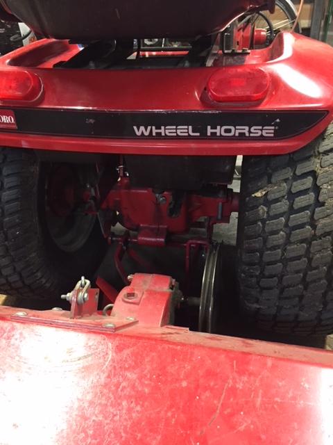

HamptonT 33 #1 Posted June 12, 2018 (edited) Well. I’ve got the rock shaft in. Went to hook up the tiller for the first time. Found it interfered with the hitch. Took that off. Now the small idler pulley interferes with the swing shaft clamp on the rear axle. What do I do? Take it off and put it back on backwards? Edited June 12, 2018 by HamptonT Share this post Link to post Share on other sites
HamptonT 33 #2 Posted June 13, 2018 I figured it out. If you start with the levers down further it works. Also it doesn’t help the my brackets are not straight on the transaxle housing. Need to fix that. Share this post Link to post Share on other sites

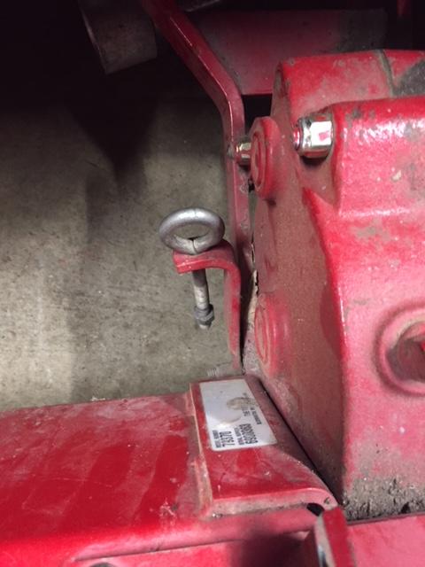

HamptonT 33 #3 Posted June 13, 2018 What’s the eye bolt for? I’m putting it on a 314-8. No hydraulics. Is this a hydraulic lift point? Share this post Link to post Share on other sites
doc724 927 #4 Posted June 13, 2018 1 minute ago, HamptonT said: I figured it out. If you start with the levers down further it works. Also it doesn’t help the my brackets are not straight on the transaxle housing. Need to fix that. I was just in the middle to responding to you. Yes, that is the trick. Suggest you download a manual here as it would have told you that trick. The next thing that will perplex you is how to get the belt on to the mid idler as the belt seems to be too short. The answer is to raise up the tiller first with the lift lever. Now drive pulley on the tiller is just a week bit closer to the engine and you can pull up on the mid idler and slide the belt under it. BTW, do not forget to inset pins into the locking levers on the rear tach a matic. You do nto have to do it on a snow plow, but the tiller can jump around a bit and you do not want it to get undone in the middle of the field 1 Share this post Link to post Share on other sites
doc724 927 #5 Posted June 13, 2018 2 minutes ago, HamptonT said: What’s the eye bolt for? I’m putting it on a 314-8. No hydraulics. Is this a hydraulic lift point? The eyebolt connects to the lift assist spring and the other end of the spring connects to a piece of angle iron (which maybe you are missing). The piece of angle iron sits on top of the transaxle on the left side and the mounting bolts for the rear tach a matic hold it in place. If you want, send me a PM and I will give you my phone and it will save a lot of time 1 Share this post Link to post Share on other sites
HamptonT 33 #6 Posted June 13, 2018 I figured out the eye bolt too. Helps to look at the manual.... 1 Share this post Link to post Share on other sites
