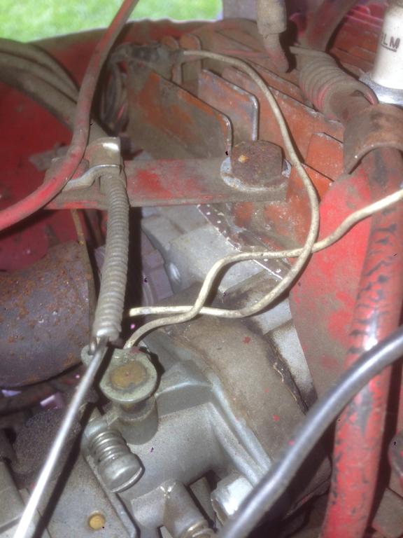

Bucko 10 #1 Posted June 12, 2018 I'm ever so close to getting this engine going; have great spark now that the magneto is installed and good compression. However, I'm trying to figure out how to route the throttle cable and choke cable to the carb. They were both disconnected when I got this beast, and the carb was removed as well. I have a 51 H55D. There is one choke cable, and one throttle cable. I can see the carb throttle butterfly linkage, and at first I thought the cable went to it. However, there is a rod that looks like it connects to it, that operates a secondary rod to what I'm guessing is some sort of governor(??) that connects over to the left side of the engine cover (when sitting in the seat). I cannot see though how to connect the throttle cable though over in this area in order to pull a lever that in turn, pulls thos secondary rod and pivot to push/pull the carbs throttle butterfly. Is there a drawing that shows this setup so I can figure this all out? Share this post Link to post Share on other sites

Bucko 10 #6 Posted June 13, 2018 (edited) Thank you formariz!!! I look forward to your pictures. I cannot for the life of me figure out how the throttle cable connects. Choke cable is an easy one. I can connect the throttle cable directly to the carb, but then all that other linkage (governor???) is not doing anything. If I connect the rod from what I think is the governor linkage to the carb's throttle butterfly (length is perfect for that), then the throttle cable does not seem to have a logical connection; tried to see how it would connect to the engine covers linkage that's on the left side (viewed when sitting in the seat), but cannot figure how the cable connects and locks down. There is a screw and cable hold down there, but the cable in the sleeve itself does not appear to have a place to slide into and operate when the throttle lever is pulled. Edited June 13, 2018 by Bucko Share this post Link to post Share on other sites

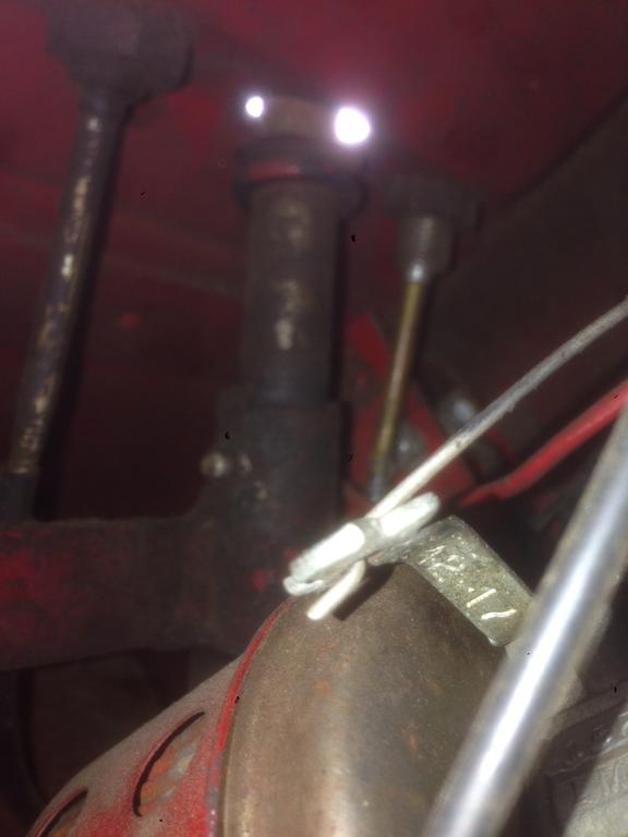

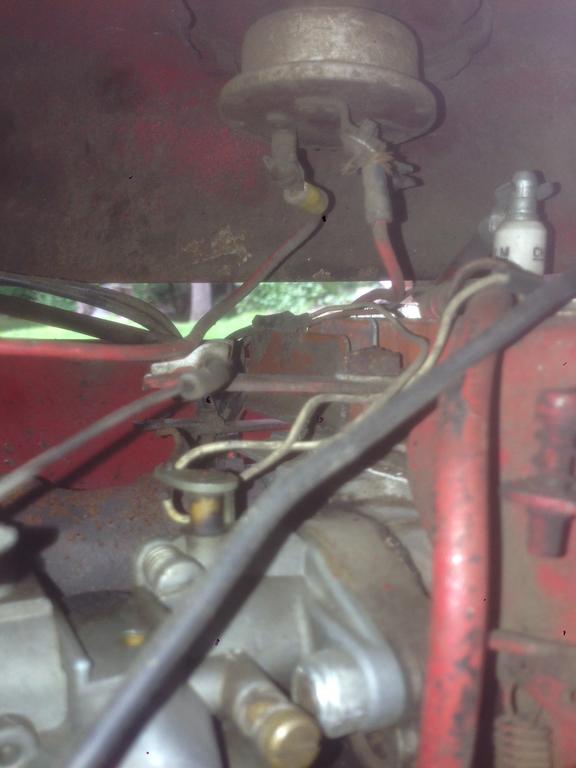

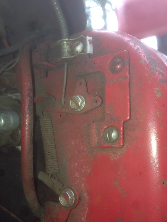

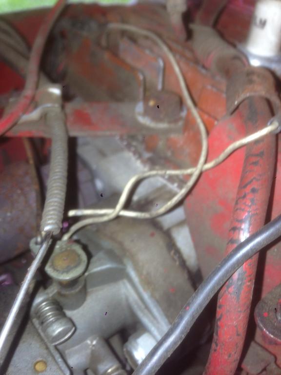

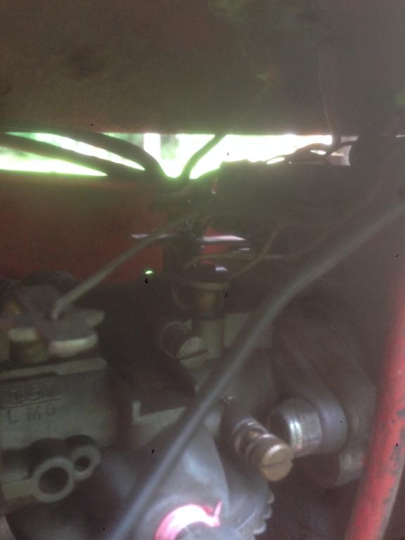

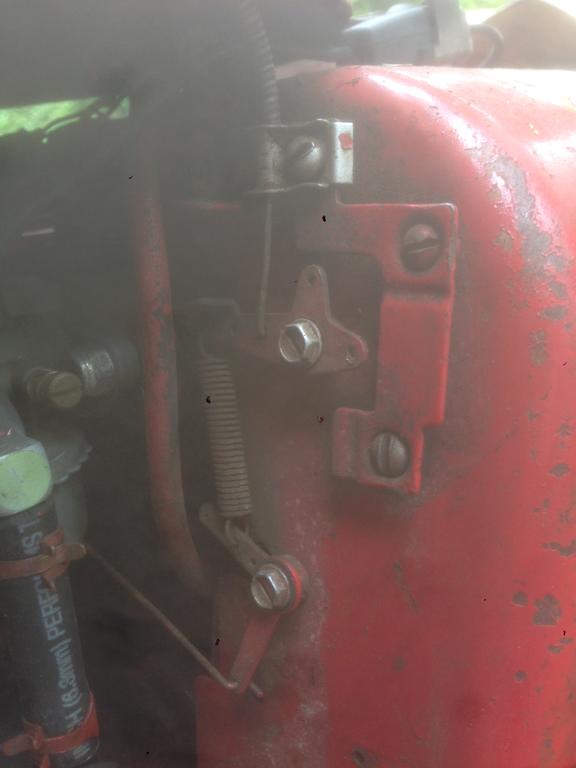

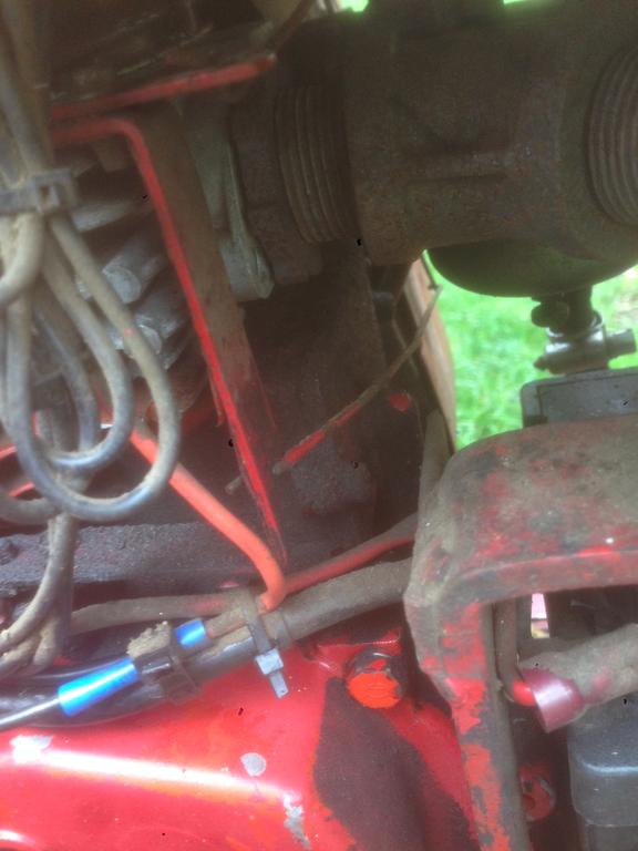

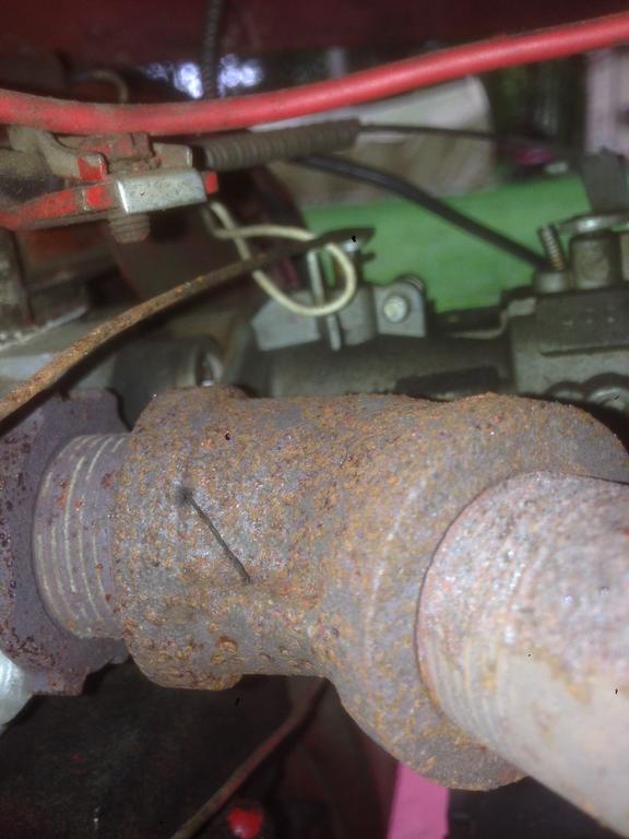

formariz 12,381 #7 Posted June 13, 2018 Here are a few pictures. Not the best quality , hood is on and it was raining but they may help you. If still not clear to you let me know and I will try to raise up hood. Not easy on mine since it has a ton of stuff under there. First, do not make cables short. They are better left longer to make long easy turns rather than short tight ones. They will never work smoothly if short. Throttle cable should go straight ahead past hood support and then back into separate clamp on top of shroud where you clamp its sleeve PIC#1. Actual cable then gets attached to the top of complex mechanism attached to engine shroud PIC#1. From that mechanism there should be a long connecting wire on the very bottom of it to bottom of governor bracket PIC#1 & PIC#2. On the top of same governor bracket there should be another wire this one going to carburetor throttle lever PIC#2 & PIC#3. Choke cable sleeve gets attached first to clamp on top of engine shroud and cable then to choke lever PIC#4. Also make long sweeping turn. Hopefully you also have the original correct carburetor which is extremely rare. It has the idle speed and idle mixture adjusting screw on the left side PIC#4 rather than on the exhaust side which would make it nearly impossible to adjust if everything including heat shield is mounted. PIC#1 PIC#2 PIC#3 PIC#4 Share this post Link to post Share on other sites
oldredrider 2,554 #8 Posted June 13, 2018 @formariz, what carb are we working with here? Share this post Link to post Share on other sites
formariz 12,381 #9 Posted June 14, 2018 50 minutes ago, oldredrider said: @formariz, what carb are we working with here? Walbro LMG#157. As far as I am aware the only variant ff the LMG, LME, or LMB that has both idle speed and idle mixture adjusting screws both on the right of carburetor while facing it when mounted. Share this post Link to post Share on other sites

Bucko 10 #13 Posted June 14, 2018 Thank you! exactly what I needed! All of this tractor is original, and matches what you are showing me in your pics. The cables are original, so they should work with loops as you describe. 1 Share this post Link to post Share on other sites
