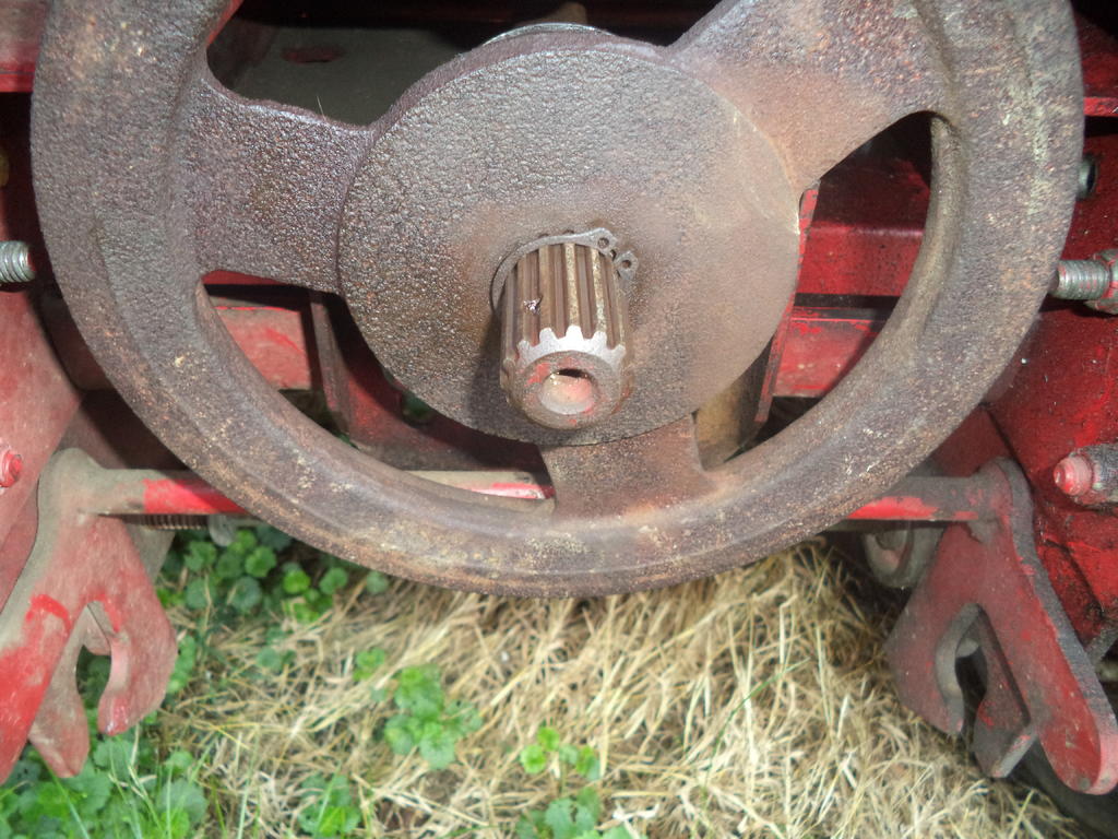

ricksrj58 279 #1 Posted June 9, 2018 a question for the D guys,i have finally got time to put my rear pto on my D200 just as the diagram shows.i removed it from a tractor to put on mine so no missing parts and the diagram shows nothing missing..my front pully is rubbing against the round shaft behind it, if i pull the pully up against the snap ring it spins free. Share this post Link to post Share on other sites
gwest_ca-(File Mod) 12,535 #2 Posted June 9, 2018 Can you gain some clearance by turning the pulley around? Garry 1 Share this post Link to post Share on other sites
ricksrj58 279 #3 Posted June 9, 2018 there is a hub on the backside of the pully. i think i will just make a spacer for behind it and be done with it. Share this post Link to post Share on other sites

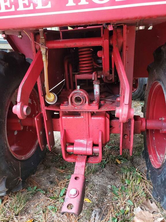

cezari 0 #4 Posted January 31, 2021 (edited) Can someone post the D-200 / D180 manual / diagram or parts list that indicate the PTO & Shaft part numbers and layout? I want to find/buy the PTO pulley & shaft assembly to fit my D200 which had it removed before I purchased it. Edited January 31, 2021 by cezari Share this post Link to post Share on other sites
pfrederi 21,312 #5 Posted January 31, 2021 Welcome Click on the fuzy area above will give you all the info you need Share this post Link to post Share on other sites
