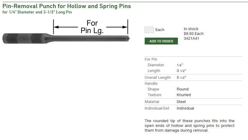

pfrederi 17,027 #5 Posted June 9, 2018 Pb Blaster or kroil or your favorite bug juice and a real roll pin punch. 3 Share this post Link to post Share on other sites

WNYPCRepair 1,875 #8 Posted June 9, 2018 11 hours ago, Cee245 said: Hey bill, you could drill out the old roll pin and go the next bigger size. Cory I broke a lot of bits trying that on the side parking brake knob on a 520H. I finally saw a post from someone about roll pin punches. Not being a mechanic, I never knew there was a difference. Some Kroil, time, and a set of roll pin punches, and it popped right out 2 Share this post Link to post Share on other sites
