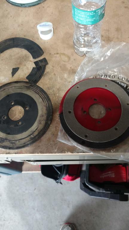

I was mowing tonight. I engaged the mower deck and the PTO clutch fell apart. Part # 114881. Can I still get this through Toro? I bought what I thought was the right clutch pad. But, it's too small. Part#4365. Looking for options to get this part.

It helps if we know what model tractor - that one appears to be the larger diameter 16 horsepower clutch. The extra diameter was to handle the extra torque of the K-341. Looks like there are a few on Ebay and other sites...

The disc on the left is from my 520H. Disc on right is from my C-100.
