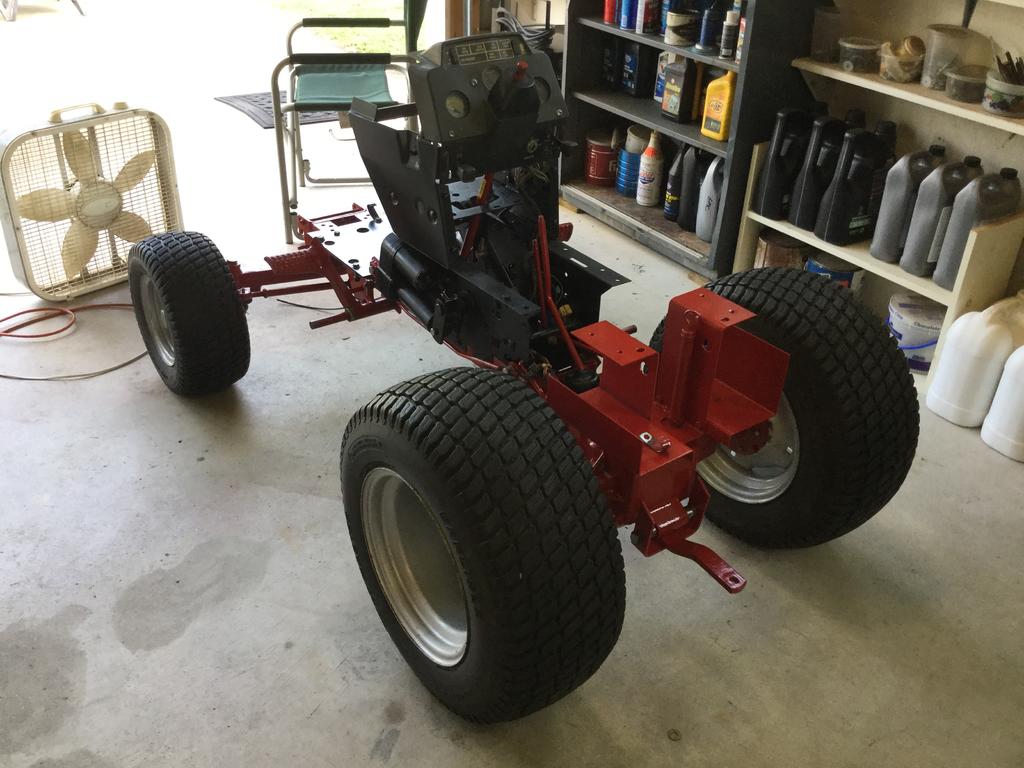

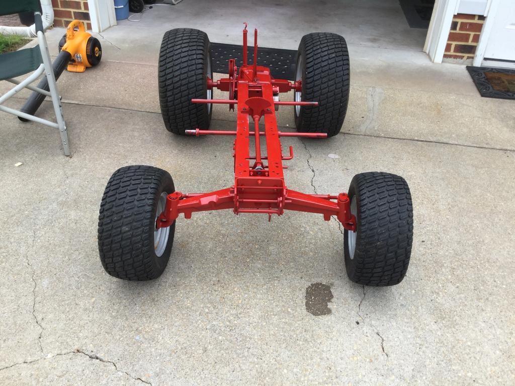

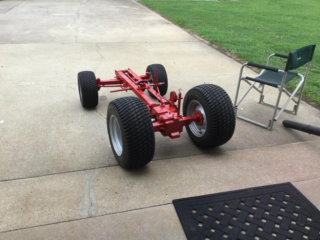

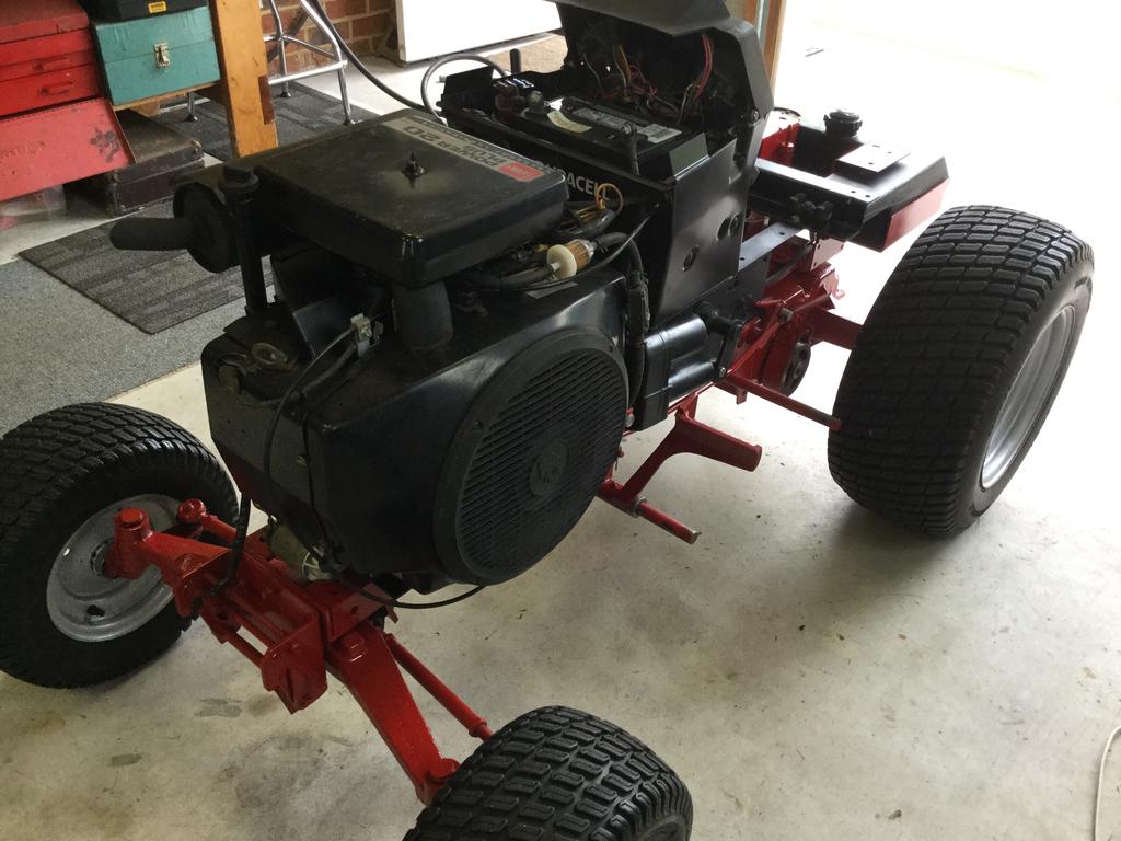

richmondred01 2,372 #29 Posted July 26, 2018 Freshened things up a bit with the frame. 1 Share this post Link to post Share on other sites
cleat 8,986 #31 Posted July 26, 2018 Looking good. Always best to start with a nice clean frame. 2 Share this post Link to post Share on other sites
ebinmaine 79,141 #32 Posted July 26, 2018 6 hours ago, cleat said: Looking good. Always best to start with a nice clean frame. As is true with many things in life.... 2 Share this post Link to post Share on other sites
FatJackDurham 318 #33 Posted July 26, 2018 Man, you make it look so quick and easy..... 1 Share this post Link to post Share on other sites

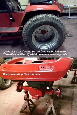

Tankman 3,528 #34 Posted July 26, 2018 Looks great! Frame 1st! You might like wheel studs too. Share this post Link to post Share on other sites
FatJackDurham 318 #35 Posted July 26, 2018 What do you do for prep before painting it like that? Obviously you didn't sand blast the whole thing down. Share this post Link to post Share on other sites
oneroadkingman 53 #36 Posted July 26, 2018 Looks great how much money do you tie up in one of these Restorations just curious Share this post Link to post Share on other sites
richmondred01 2,372 #37 Posted July 26, 2018 1 hour ago, FatJackDurham said: What do you do for prep before painting it like that? Obviously you didn't sand blast the whole thing down. I use to sandblast my parts. Now I Sand/wire brush down to solid paint or bare metal, use ppg wash, prep/etch, primer, sand, primer sealer, ppg wash, topcoat either base coat clear coat or enamel with hardener. Share this post Link to post Share on other sites

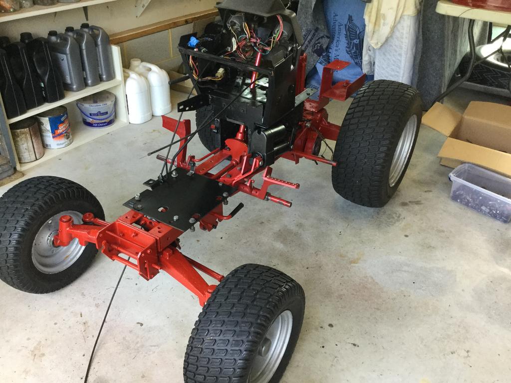

richmondred01 2,372 #44 Posted July 28, 2018 I got a few things done today. 3 Share this post Link to post Share on other sites

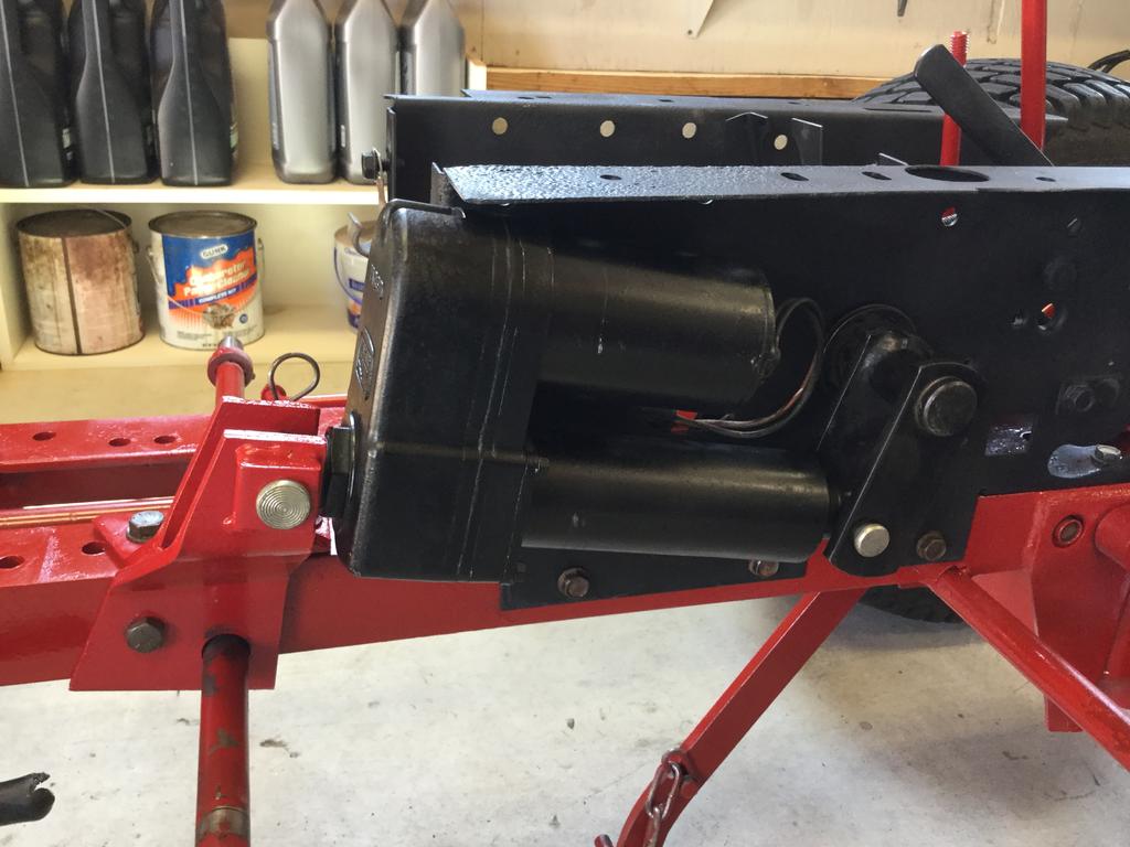

richmondred01 2,372 #46 Posted July 30, 2018 Got it up and running today. i got stuck with the installation of the wiring for the lift. The directions seem straight forward for Kohler applications but not the onan 520. I’ll be posting my issue in the Electrical section of the forum. 2 Share this post Link to post Share on other sites
richmondred01 2,372 #47 Posted July 31, 2018 Thanks to gwest-ca I got the electrical issue worked out. It was very easy once he show me what to do. Just a few more things to do. All the mechanical work is done. Now it’s making it look pretty with new decals and rubber foot treads. 1 1 Share this post Link to post Share on other sites
