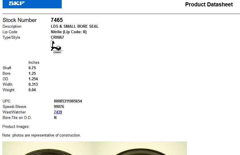

pfrederi 20,681 #12 Posted June 5, 2018 Size looks right and $9.68 beats the ebay asking price!!! Share this post Link to post Share on other sites
